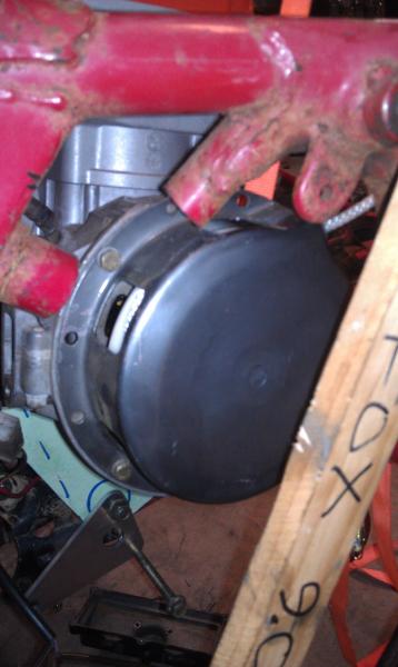

On the Rotax I rotated the recoil housing so it pulls out the front in the same/similar location as the stock Oddy.
I duct taped over the windows in the housing to keep the mud out.

And I'm planning on adding a frame hoop underneath the recoil very similar to DaveM's.
File comment: And I think I even trimmed more of the upper stub shown there...

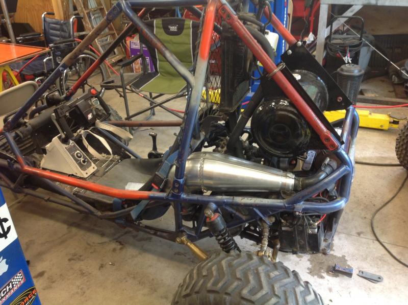

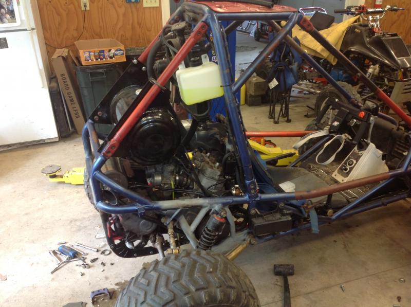

Here are a few pics

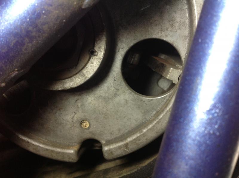

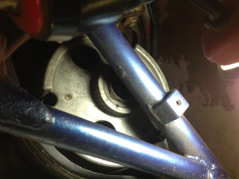

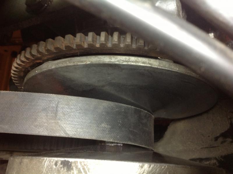

Here are some pics of the clutch. I ordered some comet lube from eBay. I appreciate the help, let me know what you need to see in the pics.

I do see a small amount of rust, is this a clutch that would be worth my time to rebuild? Or should I consider a different clutch? I only ask because its designed for a snowmobile and it will be used in a completely different environment with a lot of dirt and sand.
It should be fine
Just clean it up and lube it up after and see how it performs
What is the Engine you installed ?
Kinda looks like the same clutch I was talking about you can see one of the set screws they use to retain the hex bushing in the picture.
I blow it out good with compressed air then spray everything you see in the holes that moves with Comet lube, you cant really tell the condition of the rollers and pins until you take it apart, they all "look good" and "seem to be working fine" right up until they break lol
Like the 102C they were designed to be under the hood of a sled where their is little to no dust or dirt for their entire life, and where the moisture usually only happens from off season storage, not much humidity when its below freezing in the snow :-) so they are pretty much trouble free and the sled experts will brag all day about their trouble free operation and long life, move them to above freezing and the dirty environment of off road expect a ton of maintenance issues.
While not the top performing clutches this is why I like the power bloc and the 94C by design they take the harsh environment a lot better, the power block was made out of self lubricating materials and is lubricated for life, it does need the dirt dust blown out of it OFTEN if your expecting a long life out of it.
