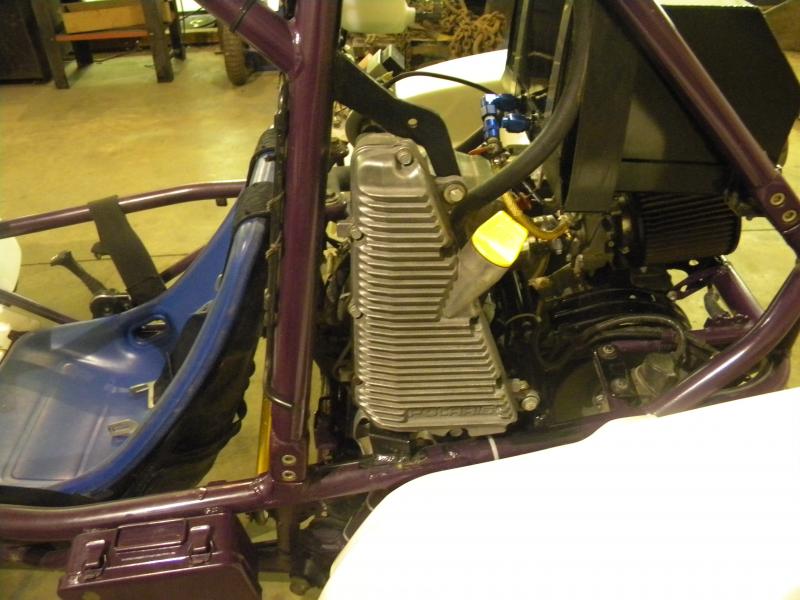

i believe you can use a Polaris Predator 500 Carburetor Carb Intake Boot Manifold and you wont have to make a adapter for the carb

download/file.php?mode=view&id=42295

you can also use a Polaris oil tank

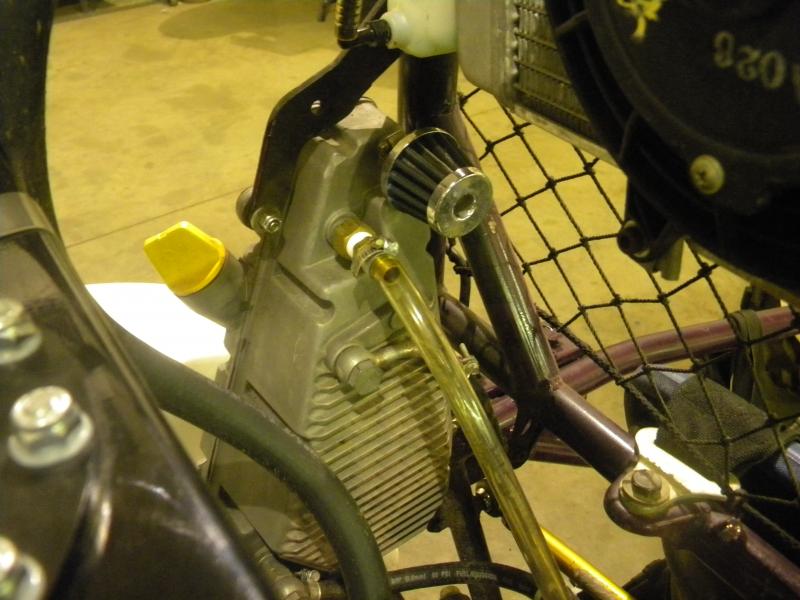

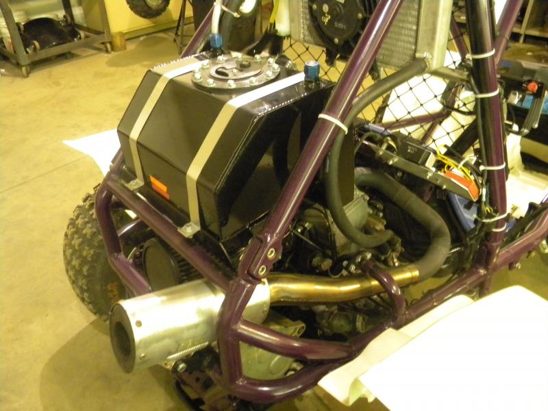

these are pix of a 500 ho mod i seen
