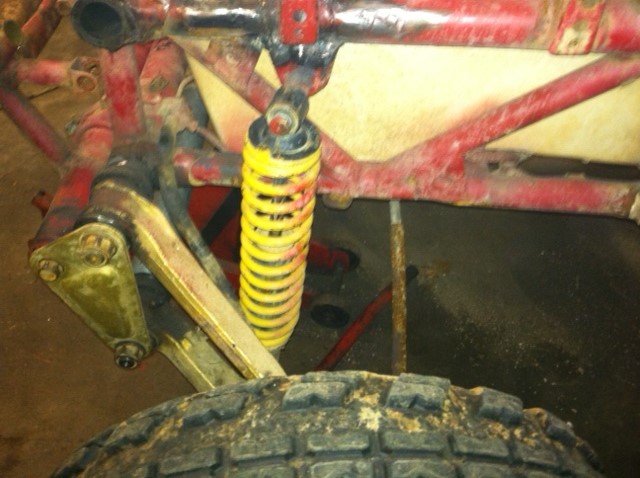

I got out in the shop this afternoon and started the assembly (dry) got the front end lined up like I want, just the j-arm pivot points. The way it looks I should be gaining about 6-1/4" but I still have the shocks to preload and connect. But the next thing to do is make the front braces and the rear braces built and installed.
File comment: It will be changed up in the center more than likely.

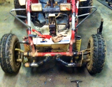

I got the front shocks relocated and the brackets tacked in place today. Maybe the new tubing will be in tomorrow and then I can replace the sacrificial tubing across the bottom front. But the shocks are working out great.
File comment: This is with about 1" of preload.

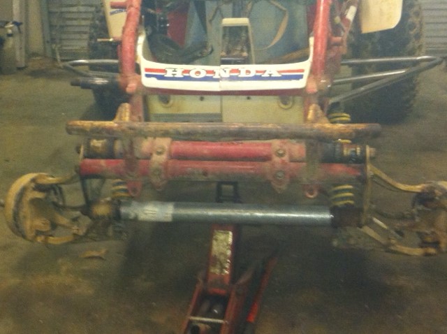

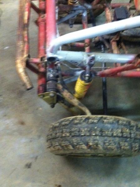

My tubing came in late yesterday so I got to start on the front lower finish of the pivot. I got it layed out and some welded. I haven't welded it in place yet, but I still have to make the rear part of the bracing.

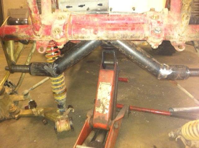

I got to work on the front end today. I still have to install a couple of bars and make new tie rods, but a lot closer to riding maybe tomorrow. Of course I still have a lot to clean up and prime and paint. A gusset hear and there and I think that will do it. I think I am going to build a new front bumper, does anybody have any good ideas for a front bumper? Any way here are a couple of pics. I have gained 6 1/2" ground clearance from the bottom of the frame and the ground.

Ok test road it today and it works perfect. I need to alien the front end better, it is very touchy but I did replace the outer ball joints and inner hiems joints. I hit a few jumps and came off of about a three feet drop off. I have no Bump Steer or offset when a bump is hit. I still have a couple of clean up areas and then to paint it. But it is working great. Next project will be to install the disk brakes on it.
