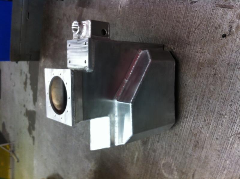

Tank works with the trans and axles there wouldn't be much point in putting a tank there if it didn't. I Used to modify the stock tank to fit with the rotax Engine but its too much hassle to send the tanks back and forth and then some people don't send the tank back so I made this tank. This tank is basically the same as the stock tank but with the mods to work with the rotax. I like this setup for the odyssey with the tank in the stock location and the rad off the rear down tubes, it makes a nice clean install.

here is another pic of the tank

that's a good angle of it! looked a lot bigger in the other pics. would be interesting to see if a stock Engine set up would fit with that tank. what is the capacity of that tank?

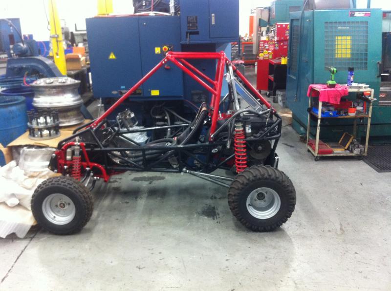

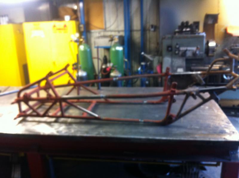

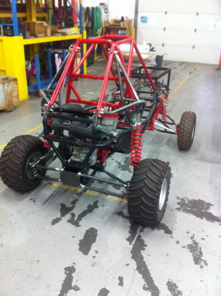

Try not to drool, I originally stretched the frame 6 inches but I found it too long so I shortened it back so now its only 3 inchs longer than stock. Rear suspension has 10 inches of travel

PostPosted: Wed Aug 17, 2016 6:22 pm
don't like the upper mount shock mount how it bolts to the frame
PostPosted: Wed Aug 17, 2016 6:28 pm
looks like all the shock hoops are bolt on.
PostPosted: Wed Aug 17, 2016 6:43 pm
Joined: Mon Aug 05, 2013 12:19 am
Posts: 71
I didn't have them installed in the pics but all the roll cage mounts are doubled up using both bolts

You got great fab skills for sure. Personally I would rather weld everything. Any test ride reports. Need video different angles and views.
PostPosted: Thu Aug 18, 2016 5:48 pm
Posts: 988
Location: Rhode Island
Very nice work and I think it looks good a little bit longer. If the rear suspension mount was welded to the cage, it would probably be very difficult to work on / remove the Engine if needed. How much wider are the front and rear wheel width? It looks very aggressive from the front view :-) Can't wait to see a video of this thing ripping!

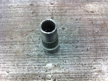

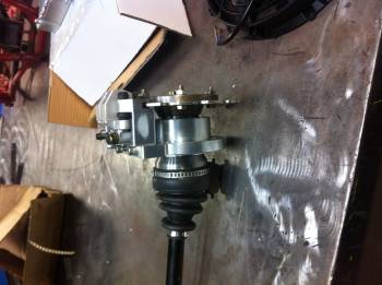

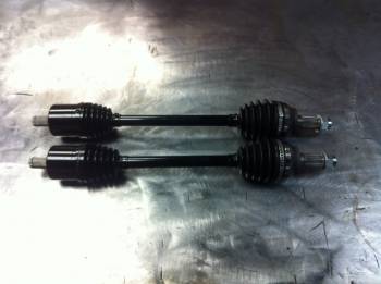

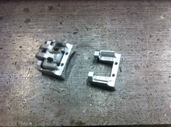

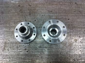

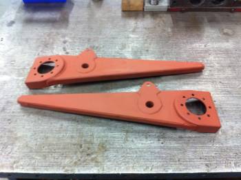

Yes the Engine is a 582 no rave valves, the only difference between the 582 and 583 is the rave valves, they have the same crank and pistons, so if you have a 582 and down the road you want more power you can throw a 583 top end on and way you go, well you have to change the exhaust and rv plate as well, I run 40mm carbs on the 582 and it goes better than with the stock 38mm carbs. Ive been really busy, but have gotten the rear end finalized finally. The axles I used were off my rzr 900xp, the front ones, axles are too long so the first time I shortend them and welded them up but didn't take too long and I snapped one off so I made billet ones out 4340 ht, its nice to have a gear hobber in the shop. I used the rzr rear shocks as well, spring rate is too stiff though but that's not a big deal, I cut the interior splines on the wheel hubs with a shaping attachment on a knee mill. The spline was wire cut into the trans shaft and was much more cost effective that way. I used Yamaha bws calipers in the rear with a custom caliper bracket, ill put some more pics up soon

it took 3 weeks from the bare frame to a driver, working on it 7 days a week pretty much full time and then 3 months to finalize details
