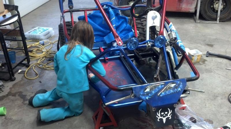

Kids had a really good time. But to be honest, the buggy was as much for me, as was for kids. But since I've got the Odyssey. That's the one I want!!!!
And the kids are really good help. They might be a bigger help this year. They going to learn the tools. And go running across the street to get what I need. :).
My daughter and I spend all afternoon and part of the night, sanding and painting the floor boards with epoxy paint. The epoxy did stick pretty good. Just a few places where we went to bare metal, and half to patch up from the summer use.
