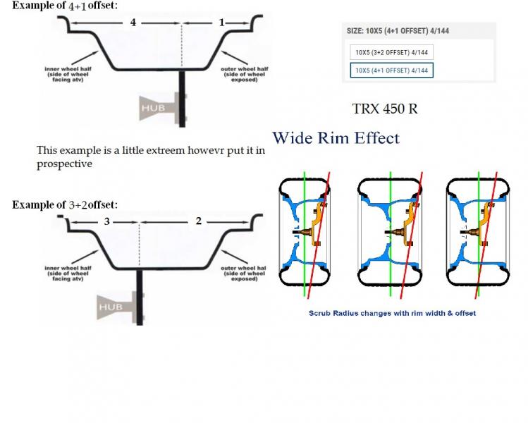

PostPosted: Sat Nov 12, 2016 12:04 pm
Good morning. I see you thirst for knowledge.
Offset is an important choice in the design. We all have read here about those rims are bad etc. go to stock offset!
ok but why?
lets face it we just redesigned the whole car in way of change. What the holy heck have we done. Ok no big deal one must adapt to the change hopefully in a positive way and with knowledge one can effect change in a positive way when dialing in the new set up. So let throw out those rims and breaking your wrist and get down to it.
In a nut shell what were talking about is Scrub Radius. I now big word however very easy to understand and apply. I say a pic worth a thousand words, so pic it is.
PostPosted: Sat Nov 12, 2016 1:11 pm
See why I posted a pic. Now we can come to grips with it. I fact is you 6" rim has a 3 + 3. This changes the scrub radius leverage of the assembly. This leverage is multiplied by weight transfer on the wheel which we will touch on later however is pertains to previous post.
So how far can we go in scrub radius and be ok. The crappie answer is as far as you can handle. Well that just plain sucks a big one as the additional load cause more stress on parts this load is force and unwanted force here is a bad thing.
You may now be starting to get a picture of this in your head and go ok than zero it is, not so fast oby one. we must consider a few things first. One being tire size and pressure see if the tire is taller see how the red and green can cross over zero. ok then one may be able to change the offset to bring it back into zero or close.
If you got this in your head we can move on. if not back the heck up and get in there.
Now comes in the BYH or Back yard hacker way of thinking. Can we say deep end?
What I the BYH like to do is do a lot of math, which want do you all a lot of good so I will try to explain in my way of thinking so please beware of what you’re about to read.
One must ask our self when we feel this wheel whip or feedback. I would say when the tire sees load or force. More force or load the worse it is. So first we find where we are at with what we run at a static pressure. Now we go back and let the pressure of the tires down to one pound of pressure and re measure to get a radius range. I do this because I want the range to be Negative to zero. Or negative at static never crossing zero at max wheel load. I'm not talking a lot either. If it reaches zero or goes positive in a hard turn well later Skater. One item with negative also is a low or flat tire. It’s drivable. Let one front tie down and one up with a crappy wheel offset see how it handles then. Just see how bad you wrist hurts on the way back to the trailer. So let’s step back and look at what you done with the preload adjustment or a lower ride height.
Just when I think I am starting to make some progress LOL :-)
Thank you for the example of scrub radius. I now understand how a poor choice of rim offset and tire size can affect the scrub radius. The range of the scrub radius is dependent on the tire PSI/compression of tire and should be taken into consideration when selecting a rim and tire combo.
Without a physical tire mounted on a rim, can one can still calculate the required rim size/offset and tire? I just need to know the angel of the red line in the photos posted. This would be tough to figure out otherwise, unless you had several rims and tires on hand. I assume that one would first select a rim offset and then adjust tire size accordingly?
I got a little lost at roll stiffness and wheel rate. All good stuff, keep it coming!

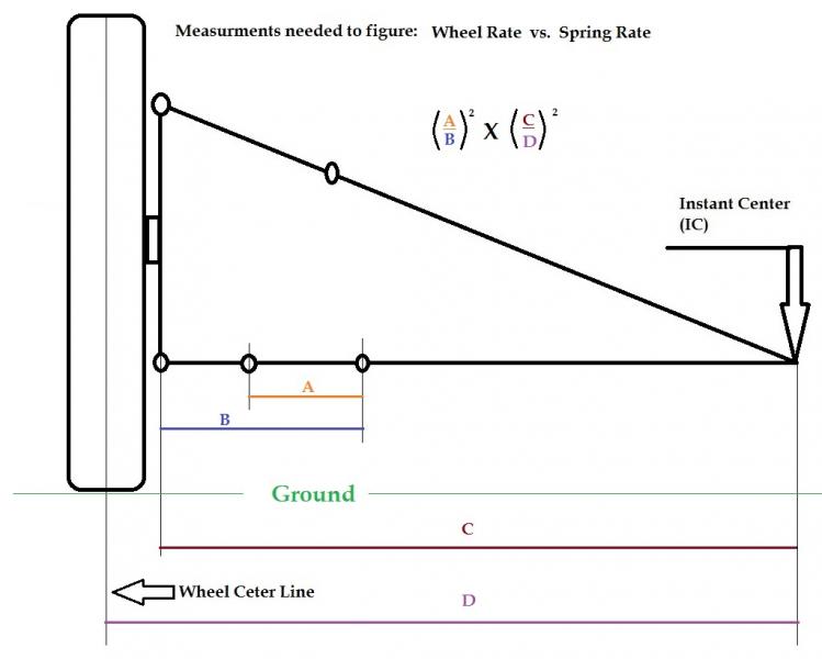

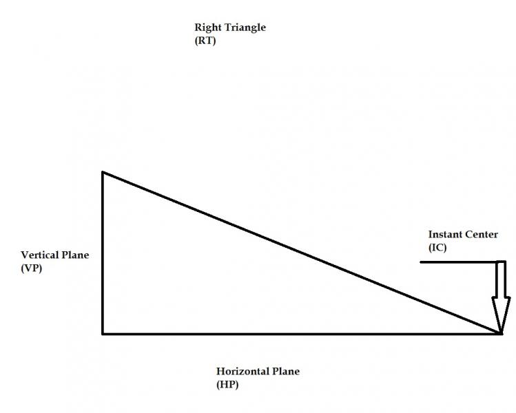

Good Morning, I though I would take some time this morning and do some drawing to go with the spew I posted.
You may find them helpful if not it may help someone. We all just throw stuff at each other with out or maybe having an understanding of it. The so called easy answer is not always the best. I say a some what educated answer is the best. I say some what due I'm not a professional / expert like Lee and some others however have some what of a working knowledge to share.
So go through the pics and get a grasp of what I am was talking about and how each thing you do effect the numbers. The numbers do not lie.
You will se that the rim offset plays a part not only in handling but wheel rate and spring rate. The pictures walk you through the leverage (s) involved with choice (s). This will also help one put a "crutch" on a plan if need be do to poor design. this is just one step I the whole process. I feel it a good one to know. This should also help one to understand what some of the more knowledgeable site members are talking about.
I and other will comment on pics and future pics as we go so all have a clue or some what understanding of change.

PostPosted: Sun Nov 20, 2016 2:44 pm
I used a right triangle and zero inclination to make it simple to understand to start with. Plus its easy math,
you can see with the KPI at zero / vertical and the tire center line at Vertical that the scrub radius is set by simple distance between center lines. So if you move the tire center line out farther form the KPI the Scrub Radius distance becomes greater. If you look at pic 5 you will see that this also changes the math based on "D". This will have an effect on the wheel rate for you spring rate. The increase in off set increases leverage between A and D so there is more force applied to the lower shock mount than before. This will cause the spring rate to be less than before when applied to wheel rate or resistance at the tire center line to movement due to applied force.
Think of it like a teeter totter , we all have done it at one time. How did the play ground make it to accept different weights. In our case the moved the lower shock mount to help equal out weight to applied force.

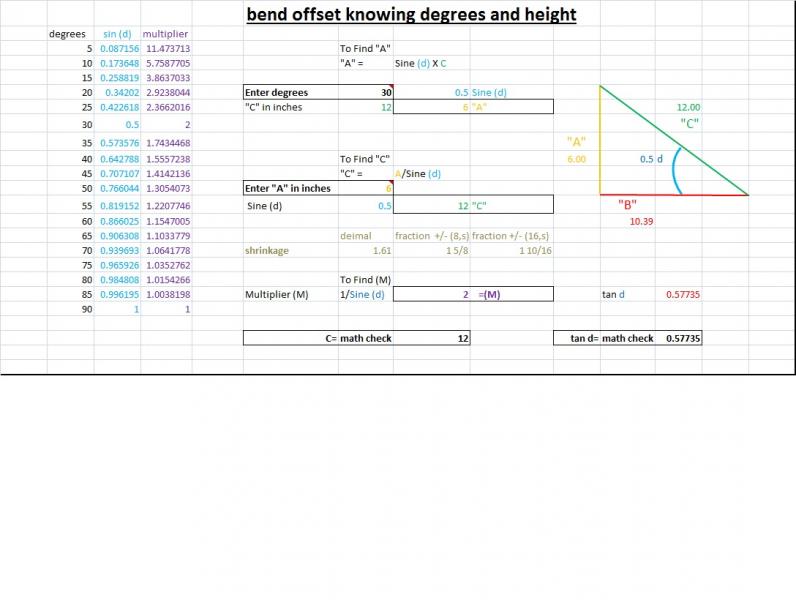

PostPosted: Sun Nov 20, 2016 2:49 pm
Here is a pic of a spread sheet I use to train the new apprentice at work to bend simple pipe installs. You can see just how simple finding the right angle is. In this case the IC for the example pics.
What your looking for in the spread sheet pic is "B" which is "C" In the drawings

I had some time over the weekend to get the rear shocks installed. Pretty easy installation. I did have one question though. There are 2 washers per shock that are provided in the installation kit. The thicker washer of the 2 is installed on the top or bottom? The rear shocks also have the clip ring at the top, same as front. I have not moved it yet.
Adnoh,
I see in the last photo you posted that if you were to adjust certain measurements, the answer to the formal will change. At this point the easiest measurements for me to change wound either be "A" or "D". The objective is for the answer to equal zer0, correct?
Next week I will take the measurements specified in the last picture you posted. I will have 3 rim/tire combos to try, but only one will be chosen. lol :-)

PostPosted: Tue Nov 22, 2016 7:57 pm
Altered a pic to put thing more in prospective. I do not want to fill your thread up with pics drawings so last one for now.
Sorry forgot to give you some numbers to use for fun according to the drawings
Set #1: A=7.5, B=16, C=60, D=64
Set #2: A=9, B=16, C=60, D=64
Set #3: A=9, B=16, C=60, D=62
These numbers are actually numbers I have used
Spring rate (s) 210, 230, 250
Use linear rate for now until you get a handle on it than go to dull rate and so on for stroke ratios.

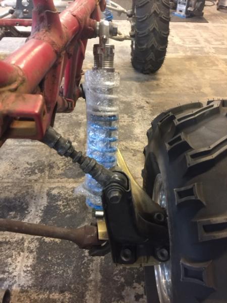

It's been a cold winter in my unheated work shop but finally starting to get back on track with this project so I figured I would post an update. I have purchased new rims and tires that match the TRX450R oem specs so I'm done messing around with that. I recently purchased a sandblaster and have been blasting every part that can fit in the thing and painting the parts. Using gloss black por15 for all the black parts. On the hunt for a good gold paint close to the Honda glamis gold. Any recommendations for this? I will be having the frame, bumper, and nerf bars sandblasted and powder coated at a local shop in the near future.
Currently trying wrap up the steering after having some issues with it this past weekend. I have to thank methodical for help with it! I have some new parts on order and if all goes as planned it will be completed this weekend. I will post an update with pictures then and further explain. It is nothing special but will be bump steer free.
PostPosted: Tue Mar 28, 2017 9:56 pm
