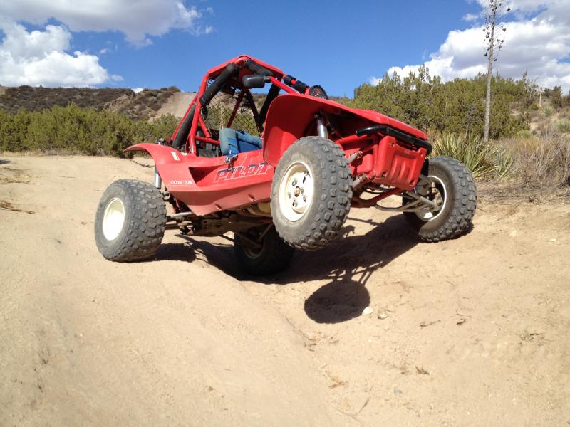

Some Pics from today's ride..

Wow your pilot looks awesome!
I've been wanting to up grade my pilot for a while now.
I think I'm going to go with the Yoda LT kit and fox 980-99-015A shocks in the front, are those what you used?
Do you know the part number for the Fox Shocks you have in the rear? and where do I go to find the DC rear extension brackets?
I've been searching the forums on both the rear Fox shocks and DC brackets but keep find mentions of them with no links or part numbers to order them.
Any info would be appreciated.
Thanks.

PM DC here for the rear brackets, but I think he sold them out some time ago. There is a thread here for both fronts and rear Fox shocks with ride reports and numbers, use the search Engine provided on the top right of this page.

Like Mudbogger said, PM DC to see if he has any shock mounts left.. Below is the shock info and valving that I did:
Front Fox Air Shock
980-99-015-A
60/90 Valving @ 150psi
Rear Fox Air Shock
980-02-016-A
40/90 Valving @ 150psi
