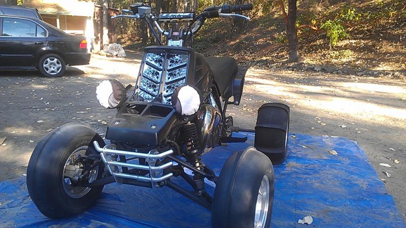

Not yet I spent this past weekend prepping my other 350 and my banshee for the dunes this weekend. Stripped all the suspension off the odyssey. Cleaned and painted it. No more gold! It looks soo much better than it did. I haven't had a trip to the sand in almost 4 years. So I'm due for a good escape.
PostPosted: Tue Jun 17, 2014 9:01 pm
Posts: 642
The frame could use fresh paint. But It cleaned up nicely. This one I've kinda designated to my girlfriend. I spend a lot of time on mine. I figured I'd clean hers up a bit. I did some cleaning and painting on my banshee as well.

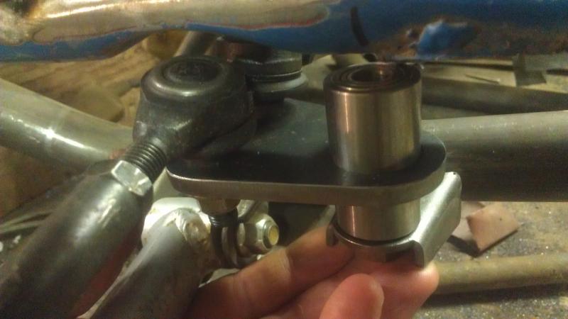

Finally got back on my project here. It's been a bit. But I started building some steering today. I machined up these for the idler arms. I think they'll work well.

There 10mm id and I believe 19mm od. I made the sleeve for the center so when its all tightened up with the through bolt it won't bind or put a side load on the bearings.

Idler arm

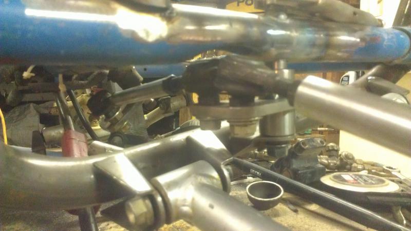

Posts: 642
Worked a bit more on it today. Built a tie rod. It moves smoothly and no signs of bump steer. But I'm not certain I have enough travel. The knuckle turns as sharp as a stock 350. But the controls do not turn as far. So I would have faster steering. I'm not sure that's what I want. Anyone encounter this?

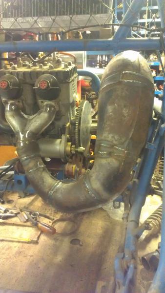

Finally got a chance to do some more on my exhaust. This is the stock ski-doo pipe and I did not add nor remove any material. So it should perform properly.
