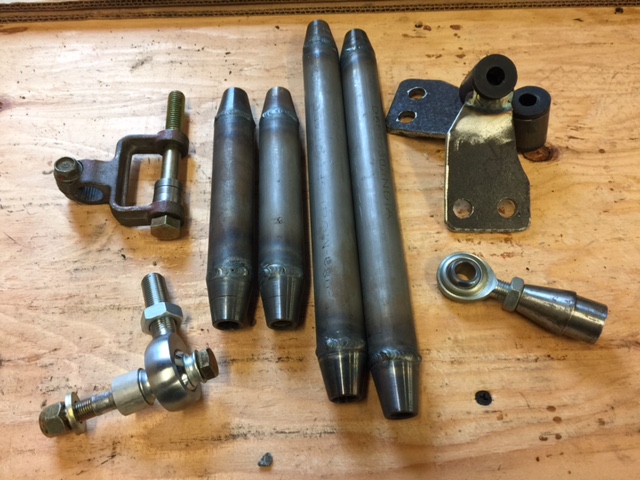

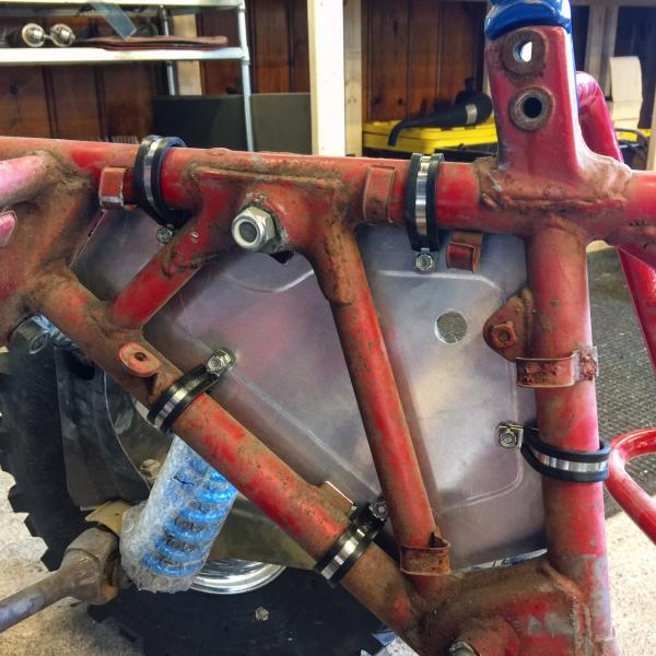

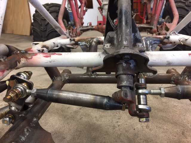

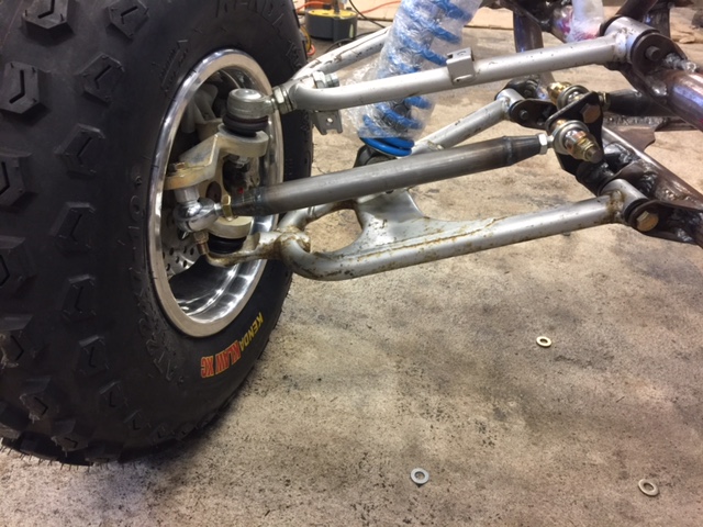

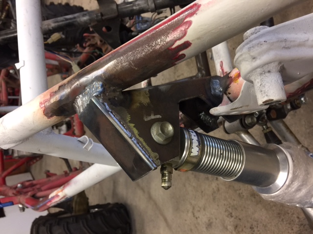

The new parts that I ordered worked great and I was able to complete my steering today. The parts that I used for my steering are in the first picture below. I used weld in bungs, cone spacers, with 7/16 heim joints (LH/RH) for all the pivot points except the heim at the spindle. For that one I used a 1/2 heim with high misalignment spacers (shown on the left in picture).
My issue that methodical helped me with was that I originally was using the 7/16 heim with cone spacers at the spindle. The heim would bind when the suspension flexed and limit the travel of it. He recommended the high misalignment spacers and they made the difference.
Additionally I strengthened the upper shock mounts, and cut the old J-Arm mounts off. I just need to weld some brackets for a LED light bar now and then the main frame will be complete.

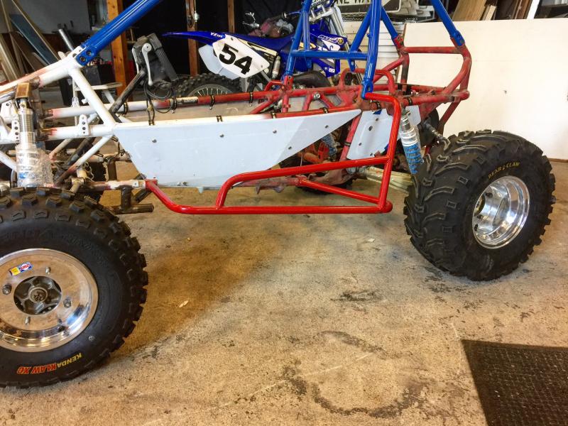

Had some time over the weekend to work on my project. Got my side panels installed and notched out to fit the nerf bars with them. I ordered the aluminium side panels online. Used stainless steel cushion clamps to mount them and also will be using a rubber edge trim to wrap around the edge of the panels. Been working on getting parts painted and I installed new bearings/seals in the rear axle carriers. The gold paint I'm using is a very close match to the glamis gold and the metallic really pops with the gloss clear coat on top. Slow moving progress but progress non the less.

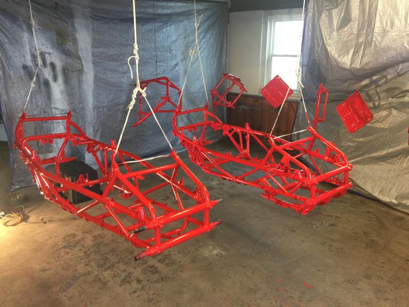

Got 3 coats of the POR 15 rust preventative coating on the frames, cages, bumpers, and nerf bars. I put the first coat on with a brush and it came out perfect. no runs in the paint, glossy smooth finish. The second coat I decided to spray on to save some time. This was a bad idea. I had a lot of wasted over spray and several runs in the paint. If was very difficult to spray all the tubes with full coverage and not put it on to heavy. I am also new to this and borrowed the spray gun from a friend so it could have been operator error. I sanded down all the runs and then painted the last coat with a brush again. All in all I am very happy with the finish and will be getting some color on them this weekend using the POR15 top coat (UV resistant). Doing my best to restore them so they will last another 32 years.

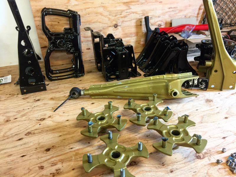

:-) It feels pretty good to have some color on them. Per the directions, it can take up to 4 days for the paint to cure completely so everything will be hanging till the weekend. The second frame is another fl350 I purchased back in December. Overall it was in good shape but decided to go through it as well. Looking forward to start the reassembly.
