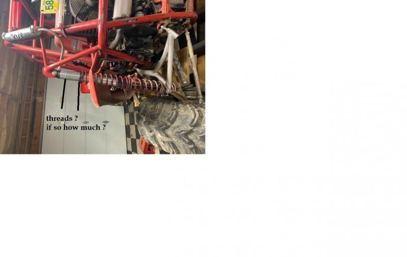

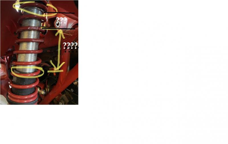

need a few numbers
the distance of thread
distance from separator to threads at ride height and fully extended.
I need this for base calculation of COP or cross over poundage at what shaft length.
Thank you

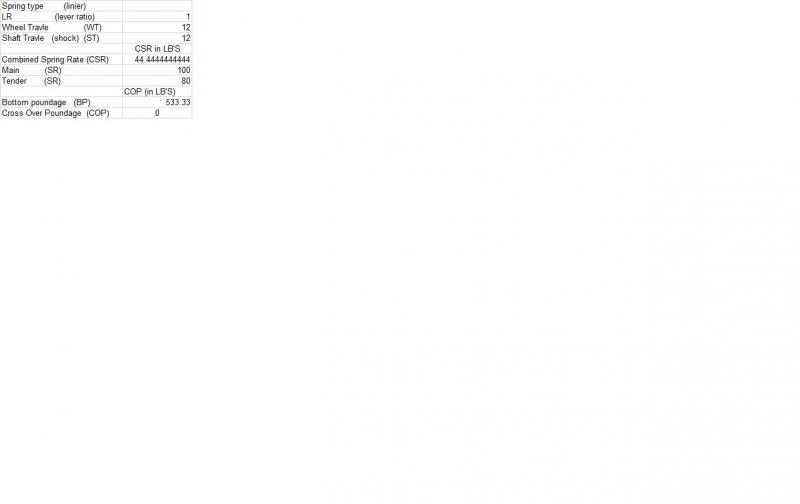

Here is what you have as a base line.
Assuming the there is no cross over to main spring.

Did some numbers for you to start with.
At 7" crossover point. In lbs
COP=3.11
BOP=811
At 5"
COP=222
BOP=922
At 3"
COP=133
BOP= 1022
You cop point is where you go from 44.5 to 100 lbs rate of shaft travel
You spring travel rate per inch is
Top=.556
Bottom=.445
The BOP is based on using full 12" shaft
so if take the 44.5 x 7 this leaves you 5" of shaft left @ 100 + Cross over poundage (COP)
I will next check the spring specs and compare to these numbers for issues.
After wards I will graph it out (plot)
This way we can look at different set ups
I feel the way it is you will need a sooner crossover as long as its not to soon to provide harsh ride
Further testing as discussed will aid in decision.
One issue with the 12" 100 rate and sooner crossover may be a spec issue under full compression.

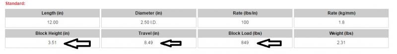

spec on the 100 main
 Post subject: Re: Dave-Co Pilot
PostPosted: Mon Feb 03, 2020 7:57 pm
not good news once you factor in the 3.115 then add 5 for a total of 8.115

have another question see pic.
what you may be able to do if room allows is buy one spring longer and have the two others for dialing in.
