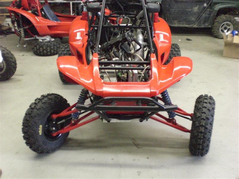

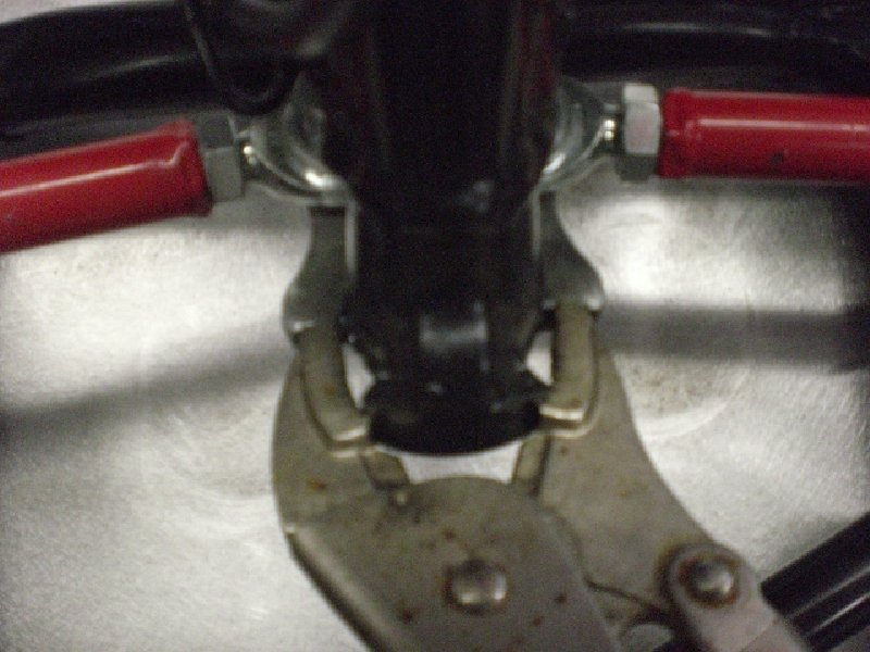

Ok i will post pics for you of lock to lock, i think what your getting at is the inside tire turns more than the outside tire this is ackerman this subject has been beat to death on these boards and i have talked about putting a rack and pinion in one of my buggies to fix this issue, but after chatting with people on the board and thinking long and hard about the benefits i decided to live with it as is, but that being said here is my 2 cents, you need a little bit of ackerman, i feel the stock Pilot has way to much but as i have stated before the front end is way light and i feel you steer mainly with the throttle anyways.
the way the tie rods bolt to the steering arm creates two different arch's making one tie rod move more than the other, i saw pics on one of these sites where someone welded up both holes in the steering bracket and put one hole in the middle, changed the inner tie rod ends to heims and stacked one on top of each other and bolted them to the new centered hole on the steering plate, this would help the tie rods move the same. i have never tried it or herd how it worked though.
or you would have to fab spindles with movable steering arms, by lengthening or shortening the steering arms you can change the akerman.
File comment: lock right

File comment: ATVR bump steer kit locks
File comment: pen showing steering arm if you lengthen or shorten it will change ackerman.

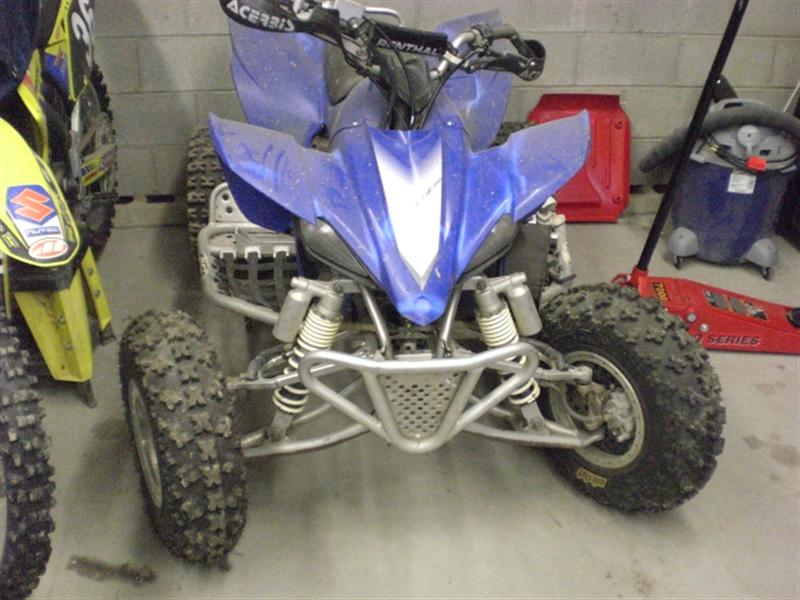

here are pics from a 06 YZF 450 you can see it is the same as the Pilot. and this might help http://www.auto-ware.com/setup/ack_rac.htm

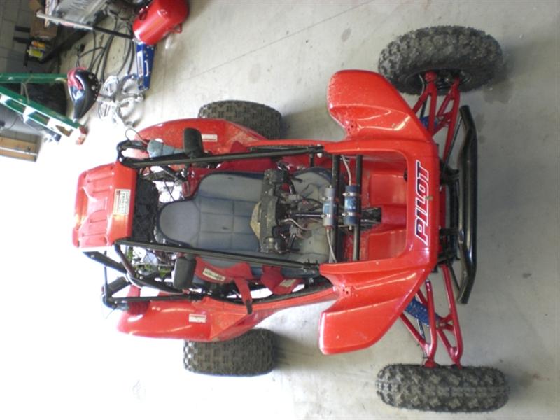

PostPosted: Mon May 26, 2008 6:11 pm

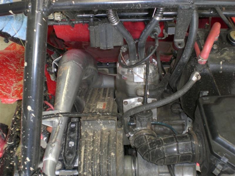

Update; got the 500 99% done this week just waiting on a few parts from service Honda to be 100%, it fired right up and would idle fine but after it warmed up we tried to drive it and it would just fall on its face it would not clear out and was super fat, it had a 420 main jet and a 110 power jet so we changed the main to a 390 and the power to 100 like some others on the board are running it made no difference, so we thought maybe it was electrical so we checked all the grounds and swapped out the CDI (Capacitor Discharge Ignition) and coil no difference, so i checked the float level it was a little high so i lowered it no difference, so we put the smallest jets we had in it a 370 main and a 70 power no difference, this thing would idle fine but wouldn't get out of its own way after that????? so i blocked off the power jet so it was just on the 370 main and put the needle in the top clip and finally it tried to run and clean out a little, all the while i had been talking with Hoser and he was helping as best he could we didnt have another carb to try so he sent us a 39mm PWK to try we received it yesterday bolted it on and woo hoo it ran like a striped ass ape.......... Hoser nailed the jetting spot on we spent the day breaking it in and shaking the Pilot down went over all the nuts and bolts checked the fluids and planned a ride for today, this thing ran great all day never missed a beat what a good feeling to see it go from a Pilot rusting away to a good running buggy.... THANKS FOR EVERYTHING HOSER!!!!!!!!! without your help and your website this thing would still be in pieces............
PostPosted: Mon May 26, 2008 6:35 pm

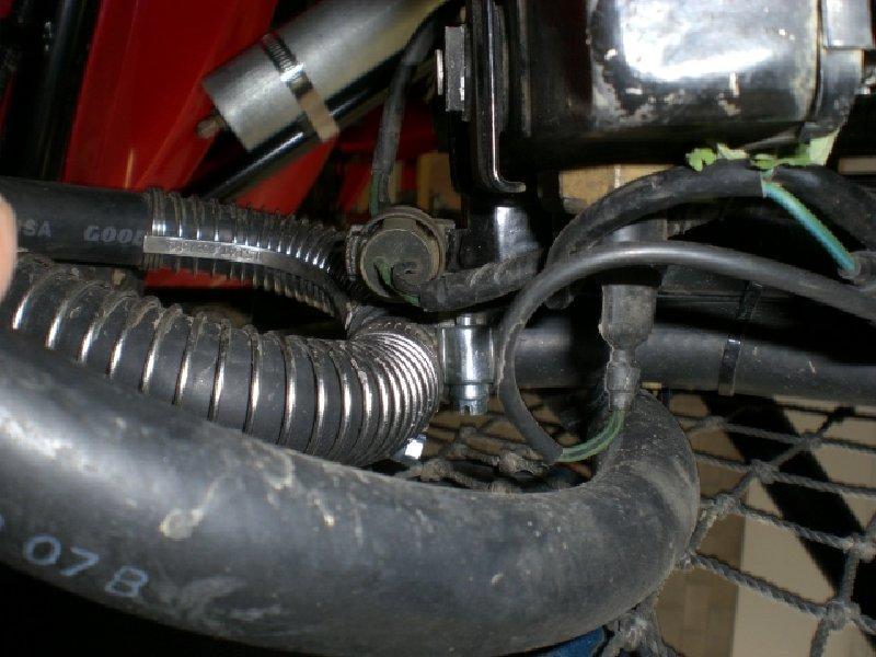

Thanks for the update I am glad your getting some seat time, how about some detail pics on the coolant hose piping what did you end up doing?
You have a tach to see what RPM's your running?
Springs better on the shocks?
PostPosted: Mon May 26, 2008 6:52 pm
i will take pics of the coolant setup i used a 5/8 T for heater hose and they make springs that fit over the 5/8 hose so you can make 90 degree bends without kinking the hose.
the tach reeds in hundreds not thousands are they all like that do you just add a digit to the end? i have never used a Digitron before, but i put a marker line on the clutch face and it is shifting all the way out, it has a good hole shot and top end.
the springs are good if i was racing on a groomed track i would go lighter but since this is mostly a trail buggy we will keep it where its at.
thanks again...................

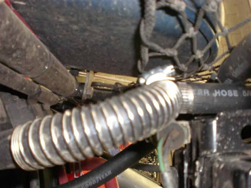

PostPosted: Thu May 29, 2008 6:32 pm
[/quote]
Springs better on the shocks?[/quote]
here are pics of the coolant lines, i used a 5/8 T with springs made for heater hose to bend 90 degrees without kinking.

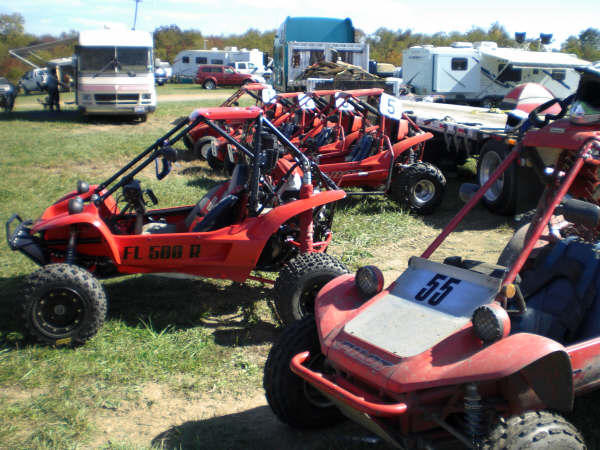

Hoser, Tim wanted me to thank you again the 500 is running great it never missed a beat the whole GNCC race. thanks again for all your help.......
