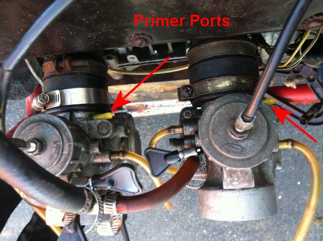

PostPosted: Mon Mar 12, 2012 7:41 pm
Now were getting some place remove those yellow caps on the carbs are they a mini hose barb that will accept a 1/8" fuel line?
Do they just go right inside the carb AFTER the carb slide meaning if you squirted gas in them holes it would go right into the Engine to be burned?
If so that's where you hook up the 'primer kit' and shoot the gas before you try to start the Engine. :-)

PostPosted: Mon Mar 12, 2012 11:58 pm
Posts: 835
Location: corona
that's what they are hoser. I had this same motor (( Internal Combustion Engine ? )) and i did a full rebuild on mine. If you hook up that primer it will fire right up when running good. The carb intake boots break really easy. Try to support the carbs on the back it will save you alot of push time. And try to keep a sparewith you.
