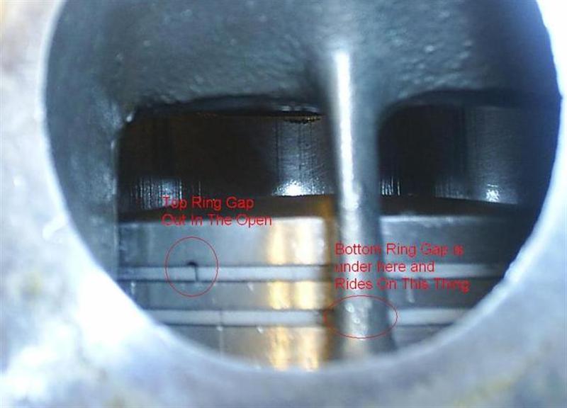

I believe Polaris does it.
Looking at the angle of the port opening it looks like the intake side of a piston port Engine to me.
