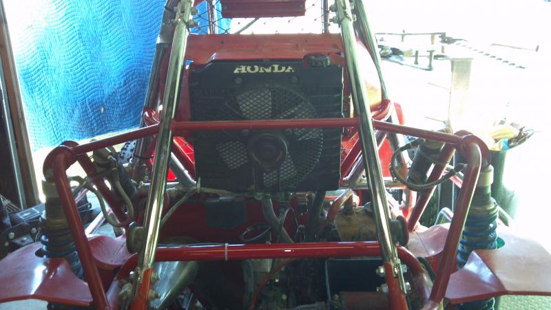

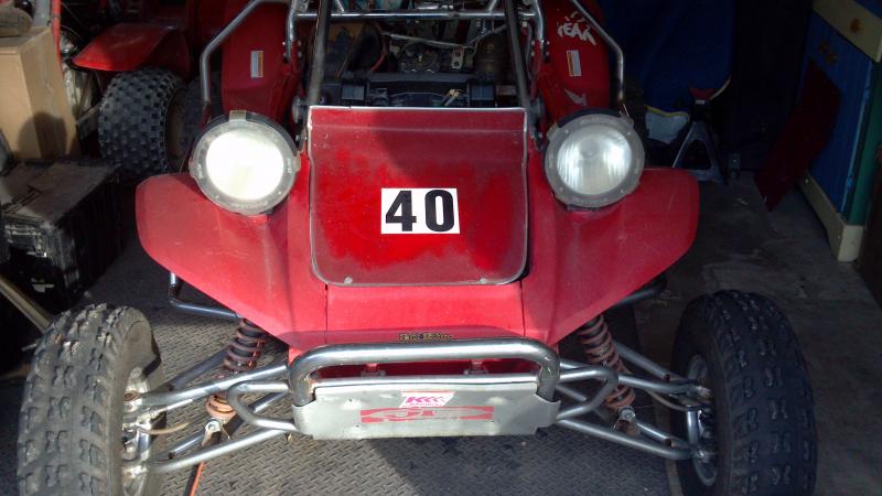

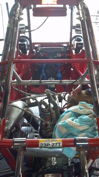

Hey guys halo brought his pilot by on sunday for some upgrades and race prep for this years race series. He is having me relocate his radiator for added access to his carb for easy 3 min jet changes as well as cooler running for WOT (Wide Open Throttle) runs durring racing. Im also going through the front and rear brakes and adjusting. Replacing the hood it has now for one a few inches taller for better rock deflection and fitment.

Yeah, that hood came off my current pilot frame setup, hence the tweaked look lol.

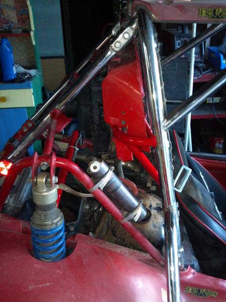

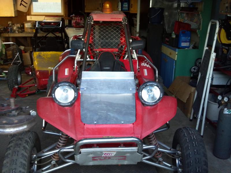

Car turned out perfect and ran great today.

When I relocate a radiator Im able to use the stock shroud and hoses. I also don't need to extend the stock wiring. Now halo has plenty of room to work on the carb or anything else in the Engine bay.

Where is the collent recovery tank? I can not see it in the pics or I'm I just blind this morning.
PostPosted: Sun Feb 03, 2013 1:39 pm
it wasn't in yet in the pic. But its the stock one in the stock location
