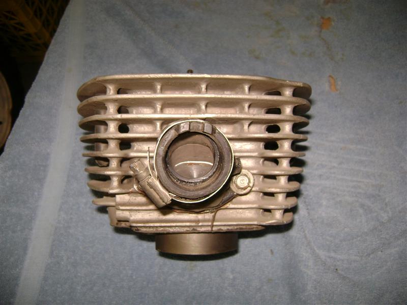

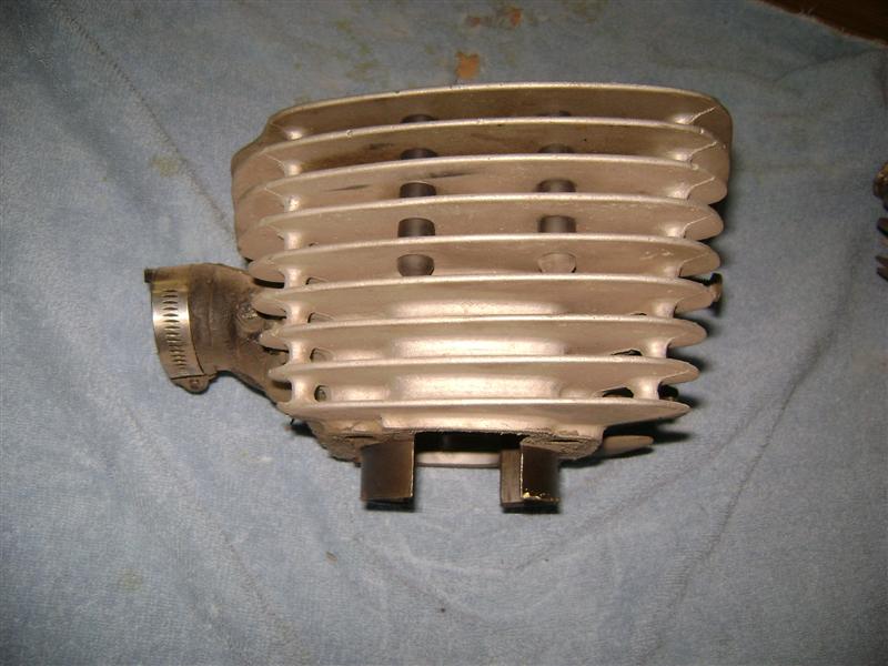

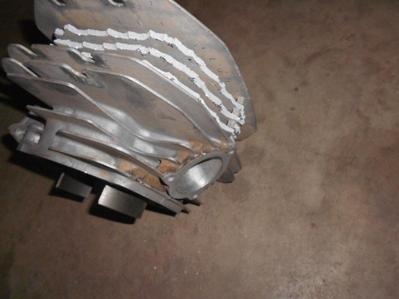

New welder is on the way thought I would start working on the FL350 cylinder I want to add a water jacket too to improve the cooling of the FL350.
While working on the FL350 Basket Case project http://www.pilotodyssey.com/PO/viewtopic.php?f=5&t=10537 I noticed when heat cycling the rebuilt Engine for the first time that the cylinder above the exhaust port and below the head gets hotter faster and long before the head does, this tells me their is a benefit to adding a water jacket to just the cylinder even when your still running the stock air cooled head, most do this the other way around and add a liquid cooled head never touch the cylinder.
Ordered a new welder so I can start welding aluminum in my shop have wanted one of these for years figured I would use a FL350 cylinder that needs a sleeve to practice on.

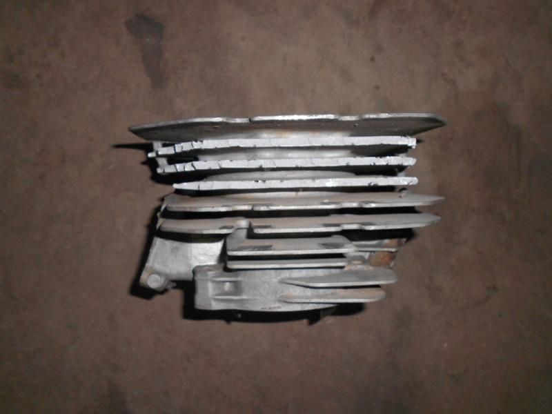

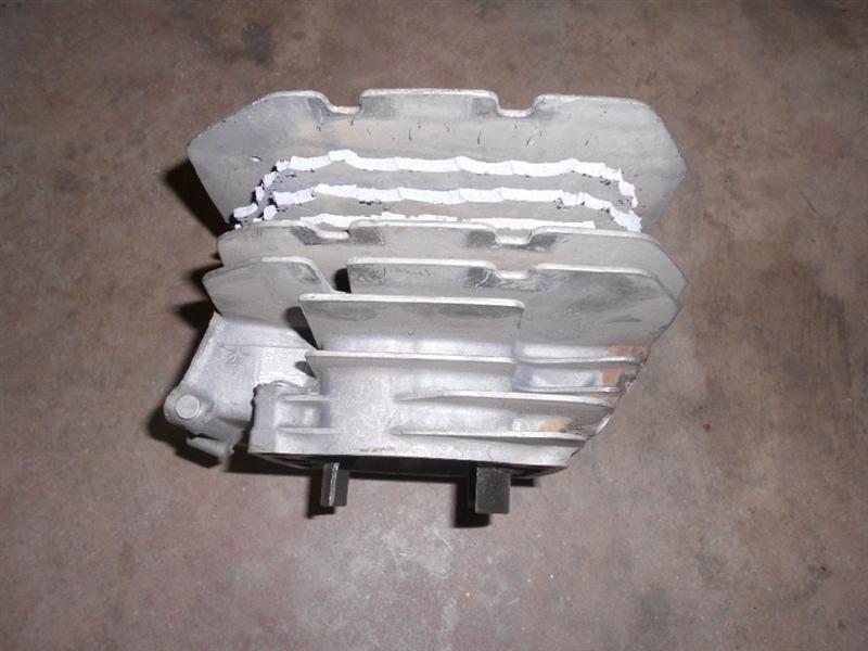

Started removing the cooling fins best way I know how caveman style, made up my own tool out of a piece of steel that is about 1/4" think think the material is A400 the steel wont bend its like a spring, super hard stuff we used as wear plate at a sand plant works pretty good.

You were not kidding when you said cave man style were you? LOL
I still want this done to a cylinder I have that is at 85mm bore. Between that and my Hillside Honda head, it should run like a iceberg!
PostPosted: Fri Aug 10, 2012 4:20 pm
Have a better way to remove them?
I need to get my bigger lathe running and see if turning them down in the lathe is faster, have it outside using a grinder on it now I have broken out all the easy stuff, has to be a faster/easier way to remove them.

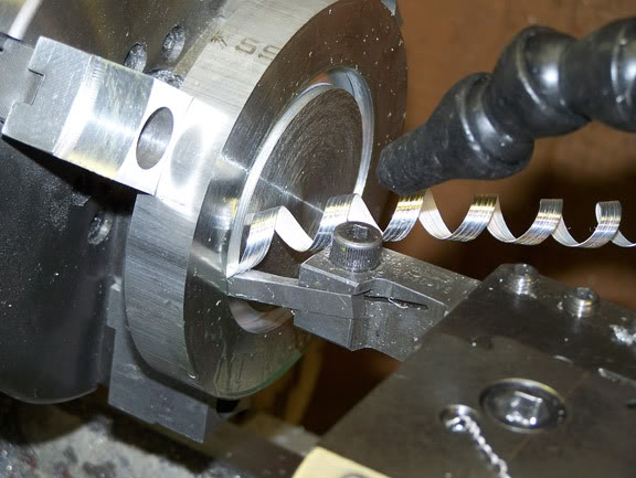

Found a pic of a trepanning tool.There many,many,variations but this pics shows the concept.

Never heard of a trepanning tool before, looking at your pic it looks like a regular tool holder and a chunk of high speed steel in the tool holder I have both I also have a huge varity of other bits, cutters is not the problem the problem is gearing my lathe down to run slow enough I need to return it to stock gearing the former owner set it up for buffing his bling parts so it runs about 60,000 RPM and sounds like a jet taking off or gear drive on a race car lol then I need to fins a accurate way (fixture) to hold the cylinder by the bottom and the top so I can not only spin it in the lathe to remove parts of the cooling fins but so I can machine the notch in the top of the cylinder to accept the new sleeve, I want to also hold the cylinder by the head end so I can skim cut the bottom of the cylinder to remove caveman damage caused by others and restore the gasket surface.

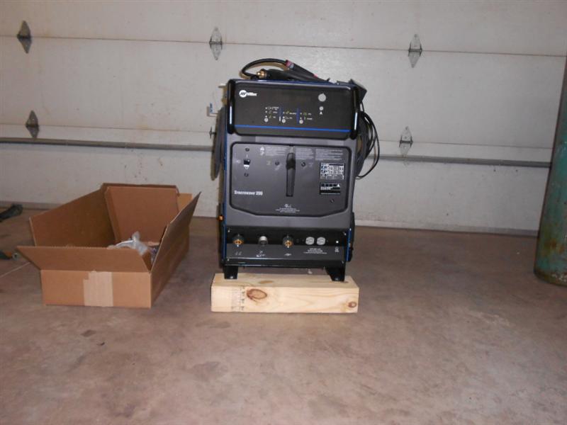

Welder came today :-)

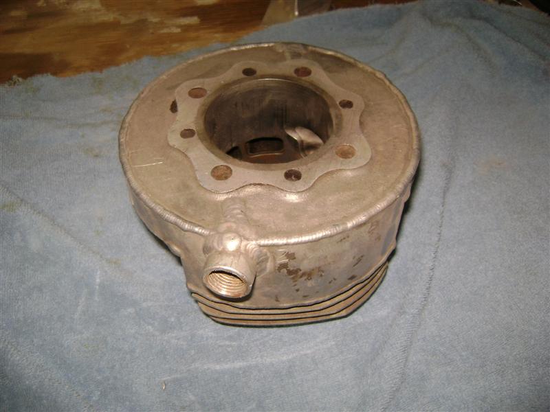

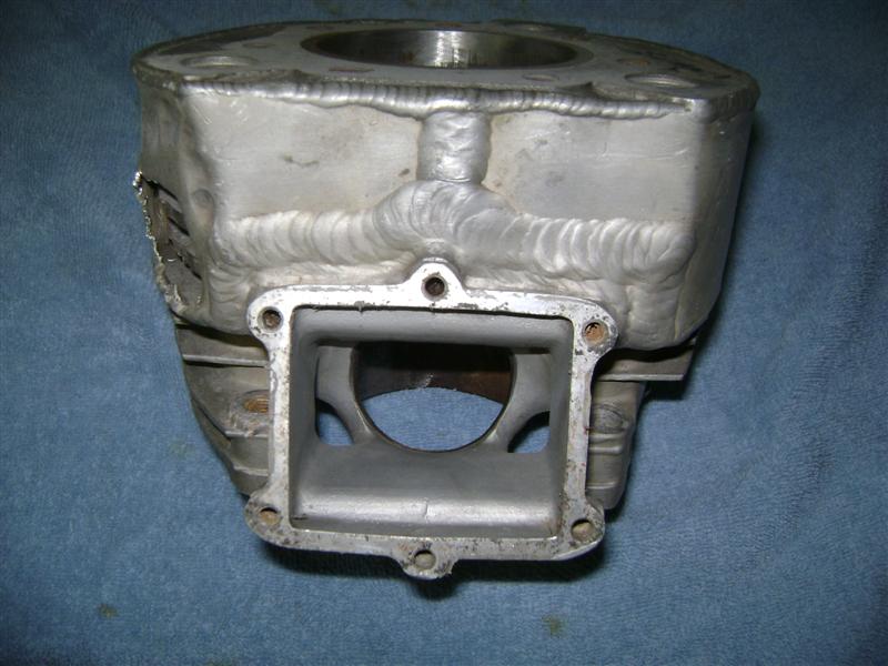

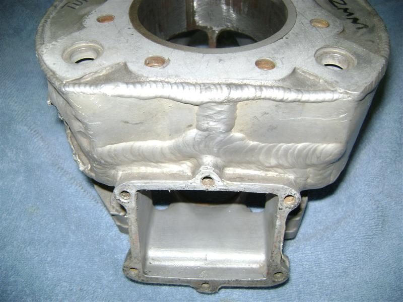

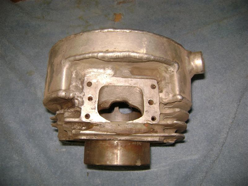

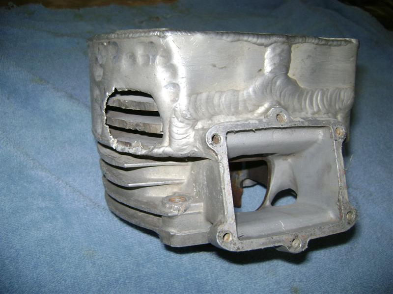

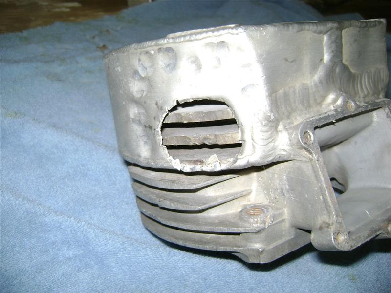

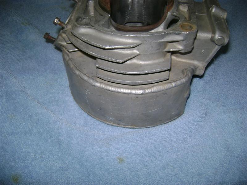

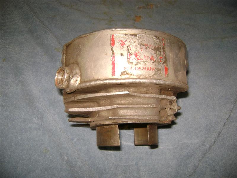

Here are pics of the 350 cylinder that came with TurboTexas "spare Engine" for his Triple E car.
Its past the 82mm bore, the outer shell is really thin like 18 gauge or lighter, appears to be a Kustom Kraft cylinder.
File comment: .
3 holes in the top of the cylinder connect to the bottom of the liquid cooled head no external hoses to connect the head and cylinder neat but also labor intensive
File comment: .
Someone removed the hose fitting on the side of the cylinder looks like they might have used a axe?

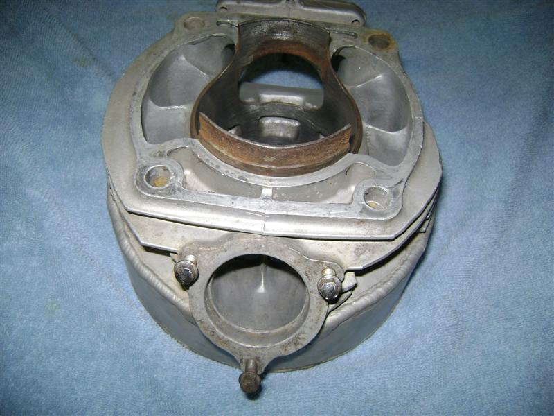

PostPosted: Mon Aug 13, 2012 5:59 pm

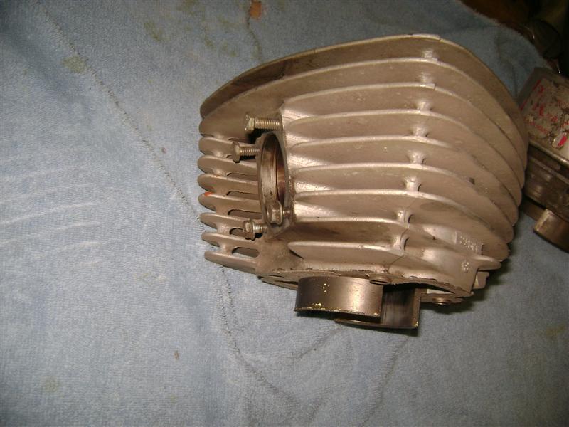

Here is a stock FL250 cylinder that was highly modified back in the old days, also a Kustom Kraft setup only its bored to a 325cc and 350cc if you had the matching stroker crankshaft to go with it.
Water jacket also welded on.
File comment: .
Whats left of the Kustom Kraft sticker
File comment: .
Intake opened up like a FL350
File comment: .
Exhaust like a FL350 who knows maybe he used FL350 sleeves for this kit?

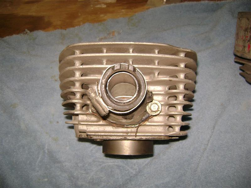

PostPosted: Mon Aug 13, 2012 6:01 pm

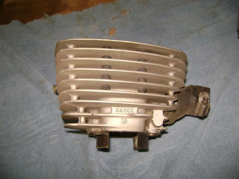

Here is a stock FL250 cylinder that will be modified and get a water jacket like the FL350 cylinder I am doing soon as I get the FL350 cylinder done will start on this one.

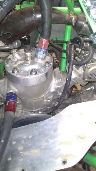

i have 3 spare cylinders around here and have thought about doing a water jacket on them and match them to the one that i have now. i would make them so i could just use the same head as i have now on all the cylinders.
The head on the Engine in the picture is a stock head that has had a water jacket welded on?
Son asked me yesterday when welding on the bottom of that straight fin 350 head why we don't put a water jacket on it, seems like a ton of work to me personally I rather invest in one of them affordable round heads who knows I might make a attempt at modifying the stock head.
Thanks for the pic.
PostPosted: Tue Aug 14, 2012 1:32 pm
have no clue what this head came off of. kuda had two heads for it but only ever gave me the one, said the other was leaking or something like that..

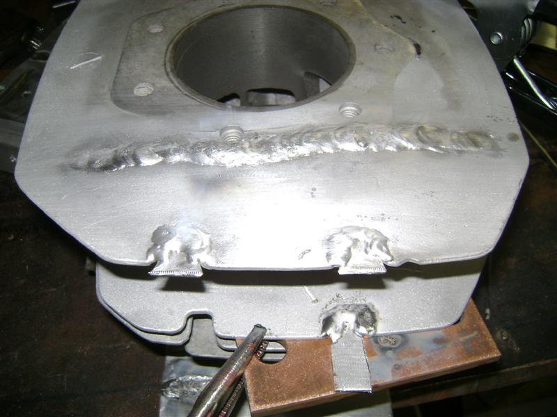

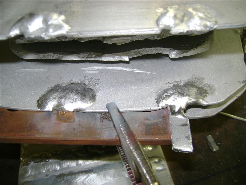

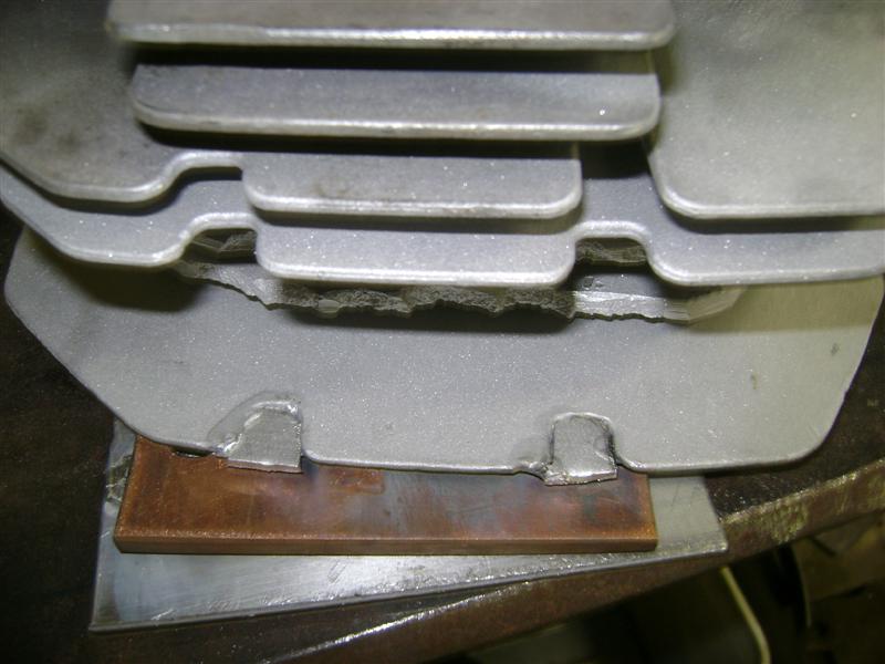

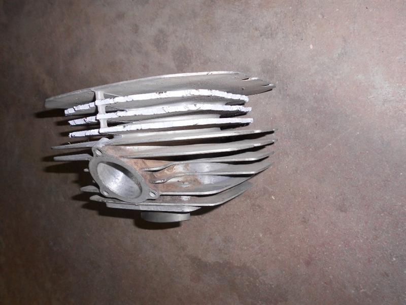

Finished removing all the cooling fins I am going to remove took it outside and sand blasted the weld affected zone, bought it back in decided I would give the welding a try since my son is out doing his own thing today.
After blasting I noticed why this cylinder had two small holes drilled in it the top fin on one side was cracked they drilled the end of the crack so I welded it up nasty shit in this casting its hard to weld.
PostPosted: Tue Aug 14, 2012 4:33 pm

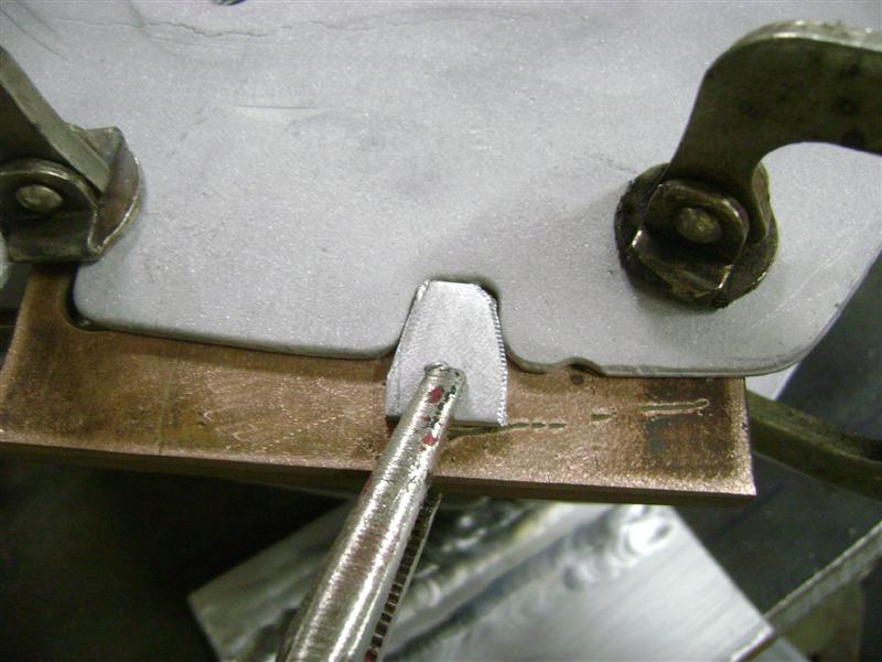

Figured I would get in some practice filling these slots that have to be filled since the son was not around to do it, first I cut some pieces to fit then backed it up with a chunk of copper plate.

I have filled many holes in steel using the copper plate backer so on the last hole thought WTH I will try it on aluminum just cover it with all filler no patch piece, works turned out good wish I would have tried this FIRST would have been much faster.
Bottom left weld is the one without the filler piece.
