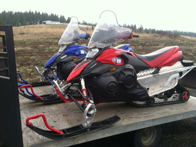

Hello all Im starting on a conversion for triple p. Ill be using his LT pilot and a 2008 YAMAHA PHAZER snowmobile. I have had his pilot for a few months in my garage waiting for reassembly but due to a new job opening up for him in Idaho he hasnthad much time to come down and wrench on it. I spoke to him about doing a conversion on my briggs car and he wanted the same. Well he search craigslist and found a great deal on a pair of them. I will be installing the 500cc four stroke Engine in the car. Finding room for the oil tank and cooler fuel cell and a air box is going to be a challenge but I cant wait to tackle the challenge. It s gonna be tight but 80hp fourstroke rocket is worth it. Can you say wheelie on command :)
File comment: Here they are on his trailer awaiting the trip to cali for the heart transplant.

Those things sure are ugly in stock form. I will enjoy watching you chop them up. Lol
