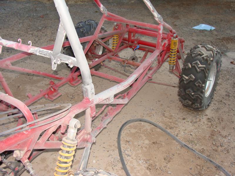

It was a nice day out so I got started on creating a little sahara myself, yep that's right got out
the old sand blaster to see how tough the paint is going to get off.

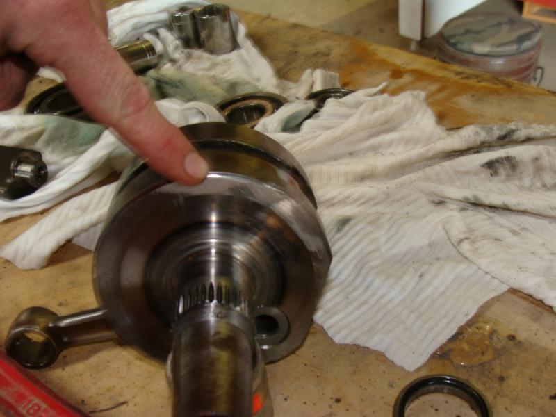

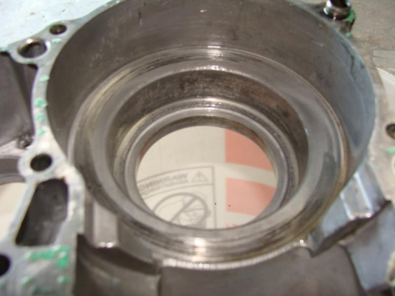

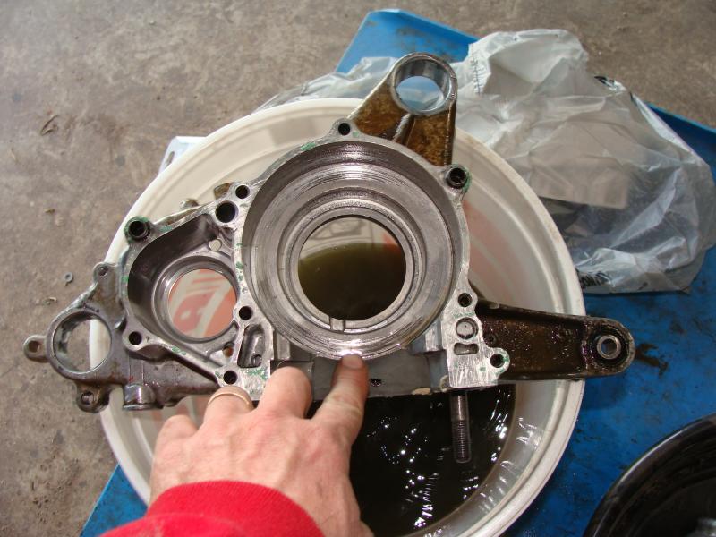

Also took some pics of crank where its rubbed aginst the case . Anyhow taking
the plunge with both feet also bought the complete lower off 1frc . Thanks for the link bull.

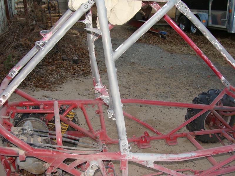

that's it finally got started it was a nice day thought I would let the sand fly.
Need to finish breaking the frame down and really get after blasting it.
Wife wants to met to paint it ford mustangs crusher blue and call it
little blue dune buggy. Good grief I sure hope this pans out.lol

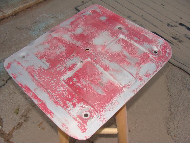

If you were planning on painting it, you don't really need to take it down to the metal. Just scuff and remove any chip spots, start with about 400 grit, then work your way to smoother stuff. Use a nice automotive filler primer, automotive grade paint, and a good clear coat. Take your time, follow instructions on the paint can, and it will turn out great. That is my main problem, I never take my time! I want it done fast, and I get runs in my paint.
PostPosted: Mon Jan 07, 2013 8:52 pm
Also take it apart. The roll cage and all the suspension.
PostPosted: Tue Jan 08, 2013 1:18 am
I'm with dbloudharleys, the sand blaster is one of my favorite tools! Its messy as hell but for some reason I like to watch the paint being stripped off parts.
Also, with the sand blaster, you get a good roughed up surface for the paint or primer to get a good foothold so a lot less chipping.

yep it wont be rattle can. It will be a hok primer cant get the good stuff with high solids any more.
But its a good primer. Also like I said she wants it blue it will be blue with red highlights. But baby blue like I said earlier ford mustangs crusher blue. Yuck !
No for some reason I like to take it down all the way to metal always
have done that way when I was a kid I would get a really nice bike frame with a shitty paint scheme,
would end up sanding down then painting laid down some pretty nice rattle can paint jobs.
I will break it down and get some more sand and finish blasting then start on small
pieces then paint reassemble. The sandblasting will ensure a good bond with the primer I am using fine sand so should turn out nice. I was thinking about tapeing of Engine cases and using pecan hulls on it that way its all shined up also. Is there anything else I can use on the alunimun to clean it up and shine it short of a transmission washer? Will have more this weekend.
Also in the pics you can see where the crank scrapped the cases
do you guys think its just maybe some of the top end scrapnel had gotten into the bottom end?
That is what stix and I had talked about. Any thoughts?
PostPosted: Tue Jan 08, 2013 1:53 am
You need to check the run out of the crank and make sure it is within specification. If it within spec then I would say something got in between the crank and case.
PostPosted: Tue Jan 08, 2013 9:37 am
Ditto that. The rub mark on the crank lobe isn't continuous, so it makes me wonder if the crank developed a "wobble" (aka: out-of-spec runout). The rub is opposite the pin, so wonder if the crank spread its wings a bit or maybe that side's bearing failed/spun (?).

Well I don't know why I didnt think of that. My common sense meter is off. That sounds right.
