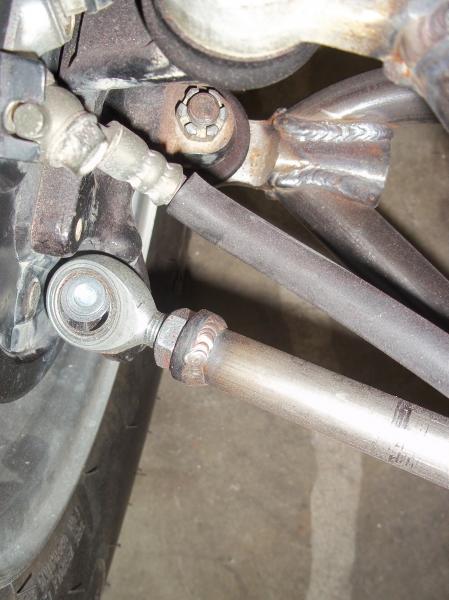

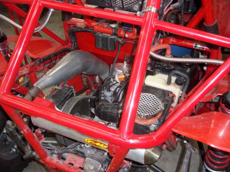

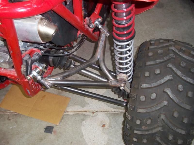

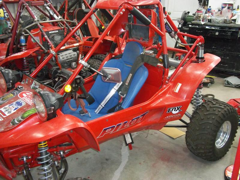

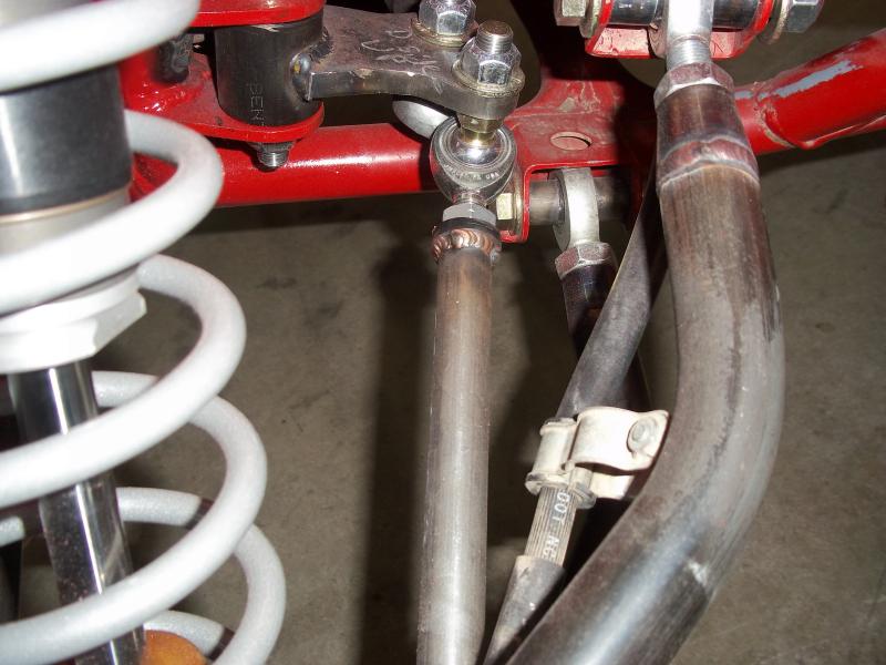

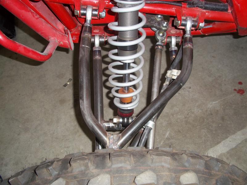

Putting the finishing touches on my, 3rd long travel pilot,, hope you like them. Engine is fully rebuilt stock for now, 12 inch fox coil overs in the rear, Fox zero pro X snow mobile shocks up front. Front has stock ball joints 4.5 inches wider with a tad over 15 inches of usable travel with hi angle hymes for the tie rod ends. The front far out travels stock tie rod ends. Rear with 12 inch shocks a tad over 13. Rear is pushed back nearly 4 inches to increase the wheel base and is where it travels with zero bind on the ball joint. with out the shock it travel near 15/ I am going to work with shock lengths to get it all some day. I made this pilot an inch wider than my others per side and made the axles out of 2 sets of pilot axles to give it a try . If any one is interested in a kit let me know, I can make front or rear or both fpr a fraction of what is sold by... ......
