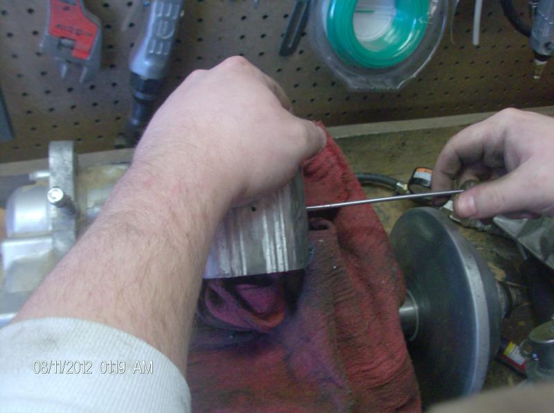

Well, rand and I finally are digging in to my paper weight. About to intall a jacketed cylinder and head. Pulled the piston, and this is what it looked like..

PostPosted: Tue Feb 19, 2013 1:56 am
No wonder you couldnt pull the pull start when we stopped! Good luck with the rebuild. Get it together and lets ride again!

PostPosted: Tue Feb 19, 2013 3:10 am
Hope you did an air leak test BEFORE rippin' it apart?
PostPosted: Tue Feb 19, 2013 12:12 pm
Baz, as far as the leak down, she blew air like on old hooker!
We pulled the head when we were at the dunes where it happened. When we got back to the shop, we put it back together but we didn't get a good seal on the head gasket and the majority of the air was coming from there. We'll be putting on a new water cooled cylinder and head and we'll pressure test again once the top end is on. If we have to do main seals its not difficult to do with the bottom end assembled.
I'll be able to get a better idea what went wrong after I can pressure test again with the new head and cylinder.

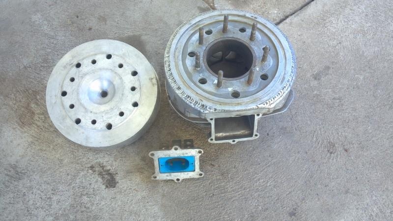

Cylinder has only a slight amount of aluminum built up on it with no gouging.
A little muriatic acid and a hone and she should be ready for another 80.5mm piston! But as mentioned before, we are using a water jacketed cylinder.

PostPosted: Thu Mar 07, 2013 6:47 pm
Got the cylinder bored, honed and chamfered for the new piston.
We are going to put it together this weekend and do the leak down test to find out if the crank seals are any good.
After that I will pressure up the water jacket and head to make sure it doesn't leak.

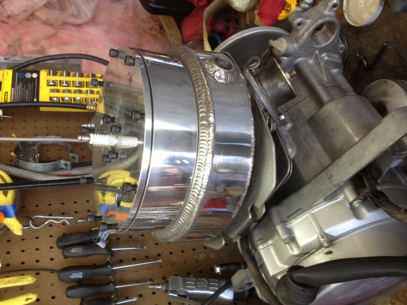

PostPosted: Sun Mar 24, 2013 11:12 pm
Posts: 87
Alrighty!! Starting to finally make progress on putting this m o t o r (Internal Combustion Motor) back together.. Leak down is done. Mounted Engine and got the pipe mounted. Shouldn't be too much longer till we can fire her up..

PostPosted: Mon Mar 25, 2013 12:50 am
lookin good! hope it runs as good as it looks. cant wait to get another trip planned with you and Rand!

PostPosted: Tue Mar 26, 2013 12:13 am
Looks good. Do a compression test before the first fire as well.
