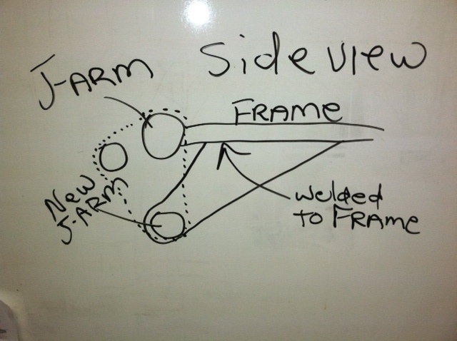

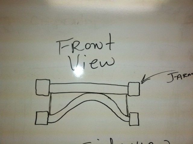

I hate to rain on your parade but.....I am curious on how you are going to keep the front swing arms from folding backwards or twisting in or out. By flipping the mount you have lost one of the structural supports.

I am going to make brackets to hold the bottom pivots and weld them going back to the frame under the bottom and also make a piece of tubing to fit them in and weld it to the bottom of the buggy. It won't be straight but will come up to the frame sort of u-shaped. This way I should have just as good of support or that is the way I am seeing it. I will try and draw it up and post a pic. of what I am talking about. But this is the kind of things I am talking about, with asking for comments. I know on here there is alot of knowledge so thanks Rand. Thanks Billy
File comment: Crude but I think you can see what I am saying.
File comment: Side view

So this is kinda' like one of those Jeep reverse shackle lift kits...flip it under 180-degrees.
Is it gonna' be longer travel or just same travel with more ground clearance?

It will be the same on everything but ground clearance and disk brakes before I am finished. And about one more inch of travel. Thanks Billy
