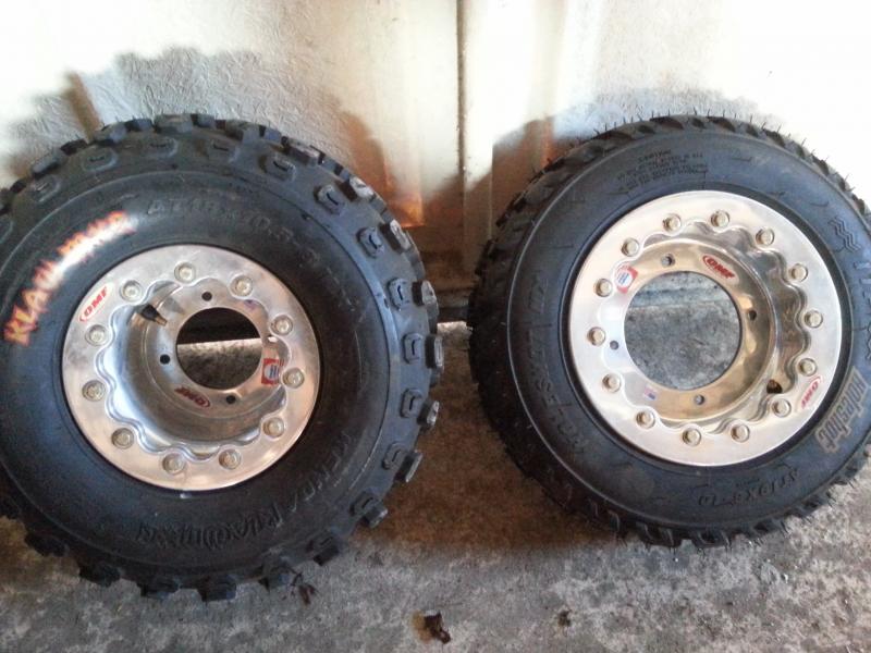

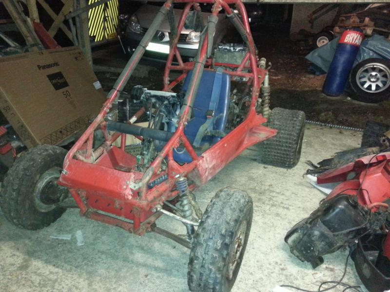

Having always wanted a pilot but finding the cost too much in the uk I have lived with fl250 odysseys but when this pilot came up in Ireland for 750 English pounds about 1220 dollars I thought it was my chance, £75 to ship across to England deliverd to my door was a bargain.
But it's had a hard hard life, the wheels are worse than wooden ones. I found a new set of Douglas bead locks on eBay for £130 but now I need to make them fit 156pcd front 115pcd rear if anyone has any ideas.
Shoubadaba has provided me with steering wheel and switches plus the missing seatbelt half.
So now I need nice plastics new arms secondary pulley and an Engine before having it all powder coated.

Batterd

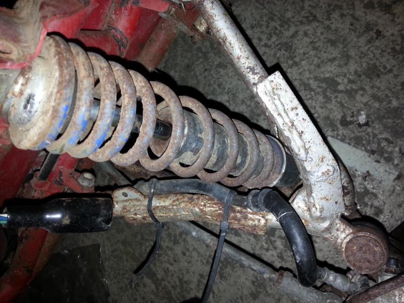

Fronts are worse

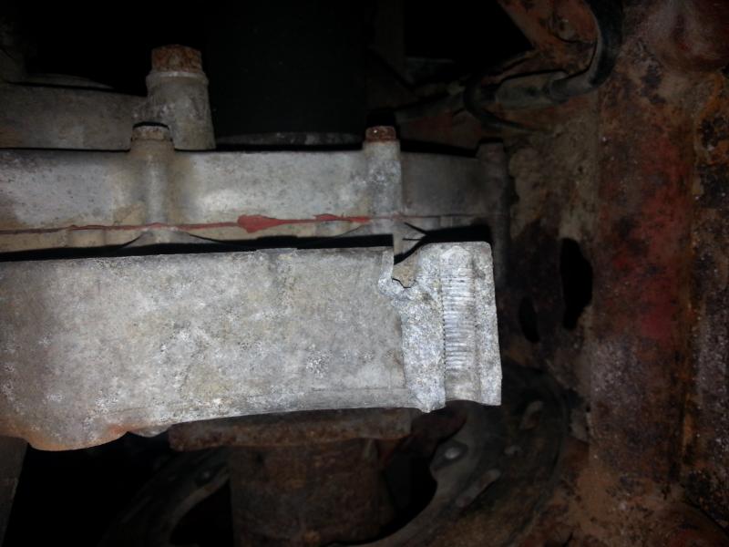

Well its on new wheels but there 2" . The more i strip the worse it gets. Rear caliper bolt must have been seized so someone used a breaker bar snapping the mounting on the transmission.

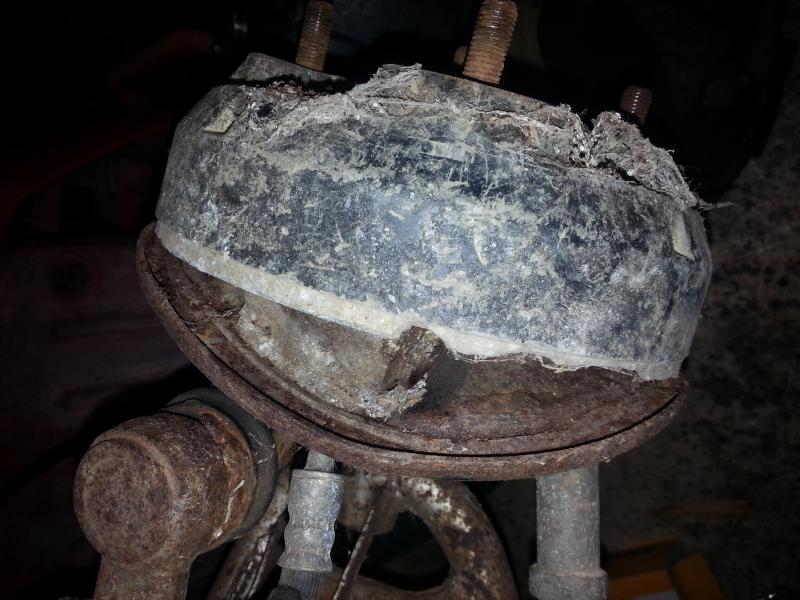

On the front because a wheel nut was spinning they bent the back plate i think to get grips on it wrecking the cylinder and chipping the drum.
I just used lots of heat on wheel studs and spindle plus remainder caliper bolt and there came off/out no problem.
Some people should not touch spanners and hammers.

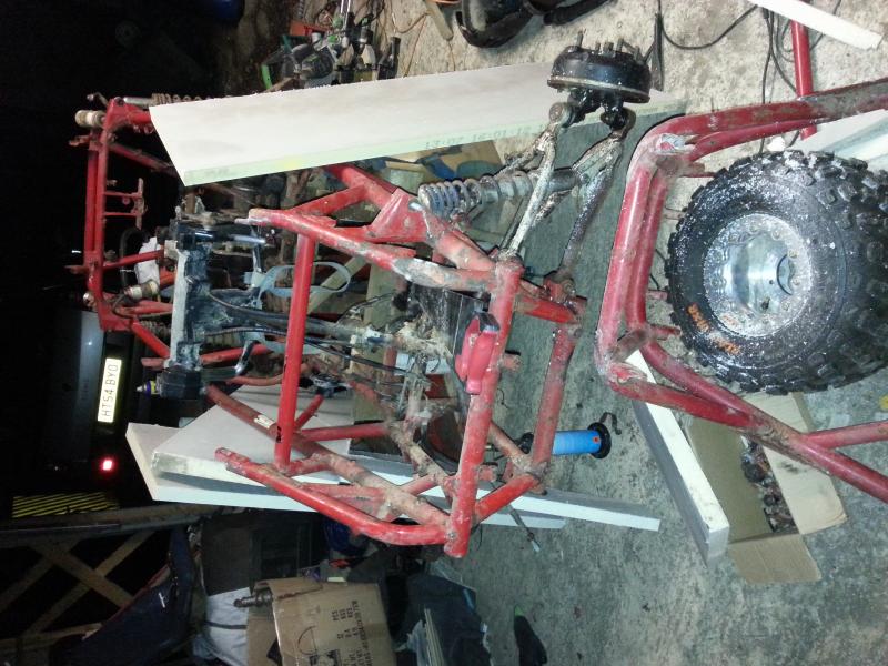

Well it made a good workbench as i insulated my new workshop

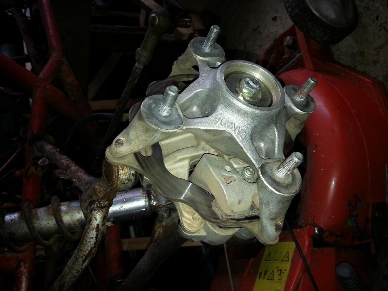

Well the new hubs arrived today. I had no idea if they would fit but horay thet have gone straight on. The track rod hole needs drilling out slightly and the to arm has a choice its held in with a horozontal bolt or i can grind a bit of and use a normal nut. As i don't have any wheels the pcd is a bonus as now i can fit most quad wheels.
The project is going on the back burner for a while now but Rusty has been helping me so much suppling an Engine and drive clutch even fetching a transmision clutch from Nick. I forgot the hubs are from a can am.

PostPosted: Fri Dec 13, 2013 9:35 pm
the project is comming along well. What were the front hubs off of?
PostPosted: Sat Dec 14, 2013 4:05 am
Joined: Sun Nov 03, 2013 4:14 pm
Posts: 62
Location: Lincolnshire , england
A can am Canadian race quad 450r although there is clearance I issue with the callipers on the bottom arms but I have not looked at it yet. I'm at an auto jumble tomorrow so I might find some bits there. Plus sell some old junk

Posts: 341
Location: North San Diego
Just saw this...
Here is my take, and as always, I could be wrong
The Can Am uses a different style upper ball joint
It's a cylindrical that needs a cross bolt - non tapered
The Pilot is a tapered ball joint that uses a castle nut underneath
Either the ball joint or the knuckle is going to get tweaked
