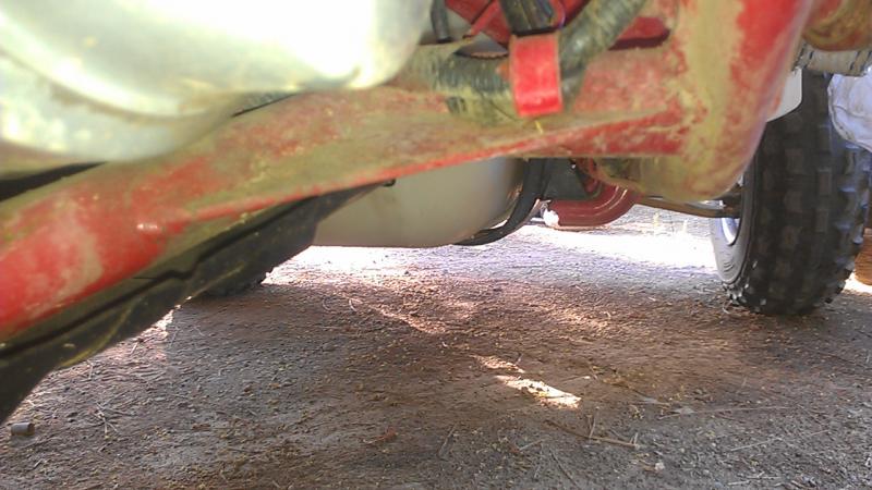

PostPosted: Sat May 31, 2014 3:50 am
Check your frame for cracks. I seen this comment in a previous thread and cut and paste it to word pad document I keep on fl350 to sled conversions. The comment was made about frame cracks appearing after a sled conversion. The comment went like this "I say this because one of my STOCK Odys had same fatigue crack where the bottom cross member is welded to the LHS bot roll cage."
I am not sure which thread I was reading when I cut n paste but I do keeps tabs on this sort of stuff.
Just something to keep in mind. Yes I am keeping tabs on this thread LOL.
PostPosted: Sat May 31, 2014 6:02 am
Yeah that was me,and with a stock Ody...so imagine what your upfor with a sled conversion???
Do your checks,better still,start gusseting and maybe add some braces.

PostPosted: Sat Jun 07, 2014 9:23 pm
Posts: 642
This is that frame gusset on my stock 350 that I mentioned. Someone had added them before I got it. The 617 ill just use tubing there instead of the plate there's definitely stress there. If you look closely you'll see even with the gusset it still cracked.
