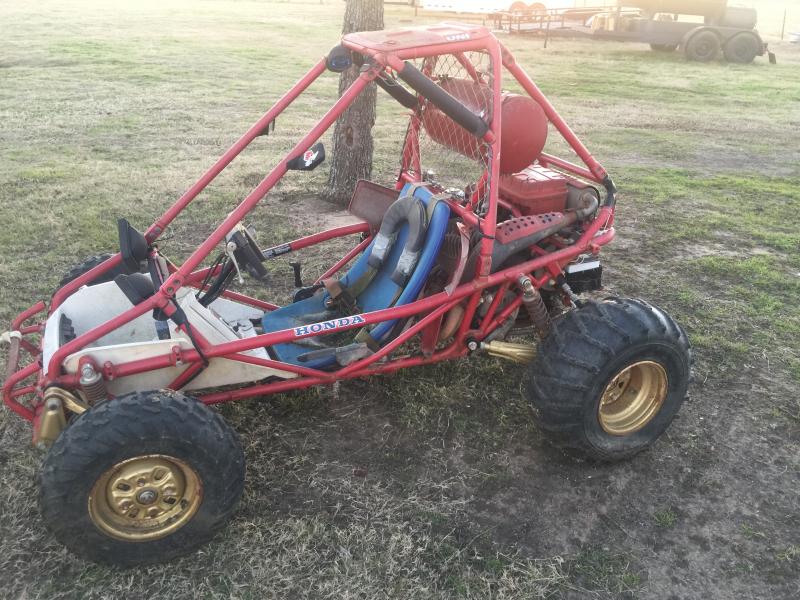

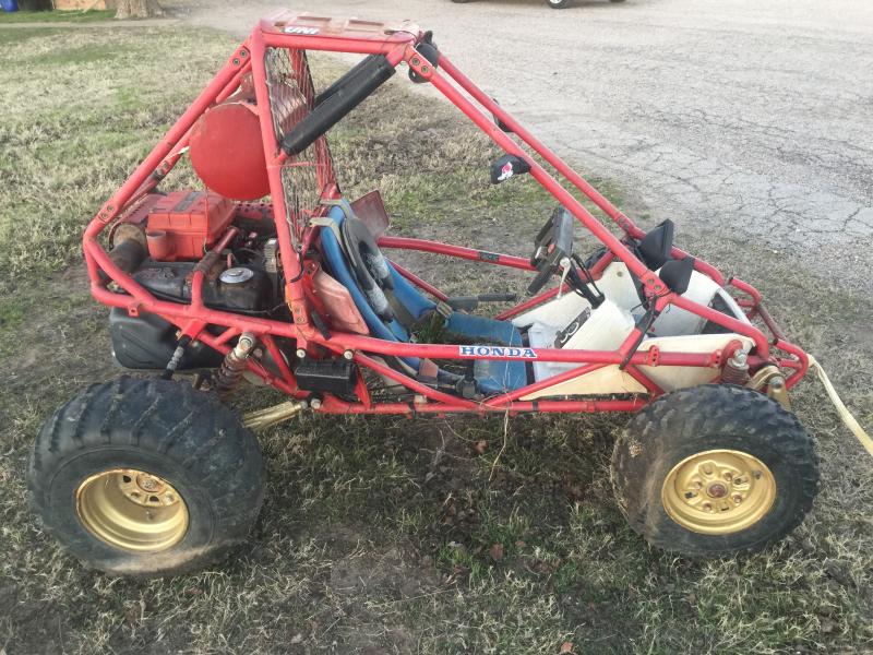

Just picked this stock 350 up for $400. My dad and I are familiar with the 250 world but brand new to the 350 group.
Any advice would be greatly appreciated?
Where do you guys go for parts?

1) You got that for a very good price. That's also a big red flag waving 911 911 911, to me anyways. Nobody gives things away unless there is a good reason. My money says he was having issues and said the hell with it. I see it has an aftermarket mickey mouse tank. That's the first issue. It's a gravity feed. Unless the carb has been fitted with a larger fuel needle valve under the float, your going to starve it of fuel. Also does the tank have a vented cap ?? If not you know the result, right ?? I am not a fan of over your head fuel tanks. It also makes the machine top heavy.

I also see that you have the stock tank there. That's awesome. Take it to a rad shop to get cleaned and coated. Then look in the tank with a flashlight to verify that the pickup tubes are good. Look at the end of the tubes at the screens. They are often plugged or gone. Blow through the shut off switch to make sure the lines are clear and that you will get fuel flow through them. Then buy a new fuel pump. I run a Polaris unit on my machines part #3085275. If tubes are shot then you can tap into the drain plug of the tank. That's what my machines have.
I also see some gomer lights on that thing. The oddy electrical system is very weak. Not much extra power there so run two LED's.
You will also notice the rear suspension is ----- well ----- stiff, or more accurately none existent. The rear springs are way way to stiff. Nobody knows why Honda did that, but it must be corrected or your going to have back issues sooner or later. We run 155lb aftermarket springs and then everything is good. At least as far as my brother and I are concerned. If you want to spend big bucks then buy some air shocks. Several members here run them and are very happy, but I am too cheap. So it's just springs. The front end is good.

Just noticed it has no wrist restraints on the steering wheel. Not good. Get a set.
