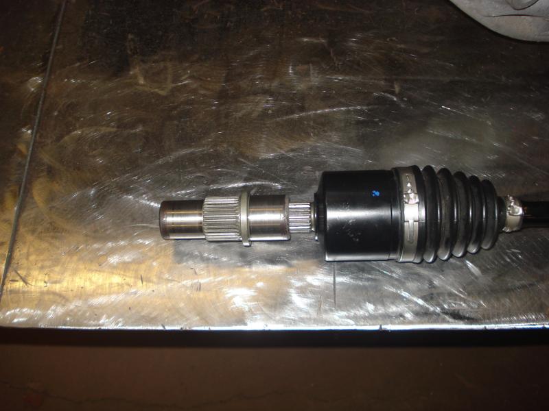

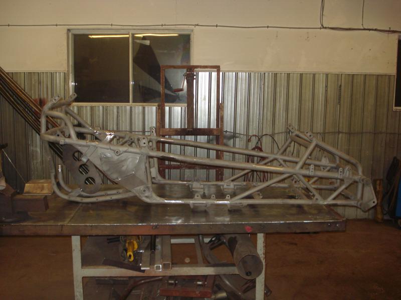

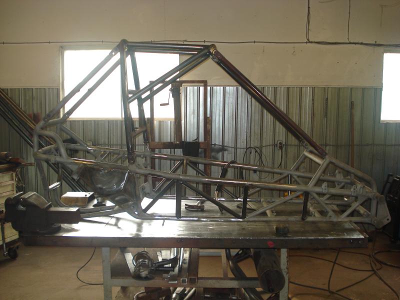

Ive had this frame for a few years now collecting dust so I figured its time to do something with it, so far ive stretched the frame 6 inches and had the final output shaft of the fl 350 trans machined to accept polaris rzr cv shafts. This is my second lt setup the first one had some issues and wasent going to be very easy to duplicate. I am also making a rear drive unit that will use the sled driven clutch and bolt in where the trans is

The rxr 900xp front axles are a little too long, im hoping the rzr 800 front axles are a little shorter and have the same spline as the 900 axle. Does anybody have a rzr 800 that they could measure the front axle on

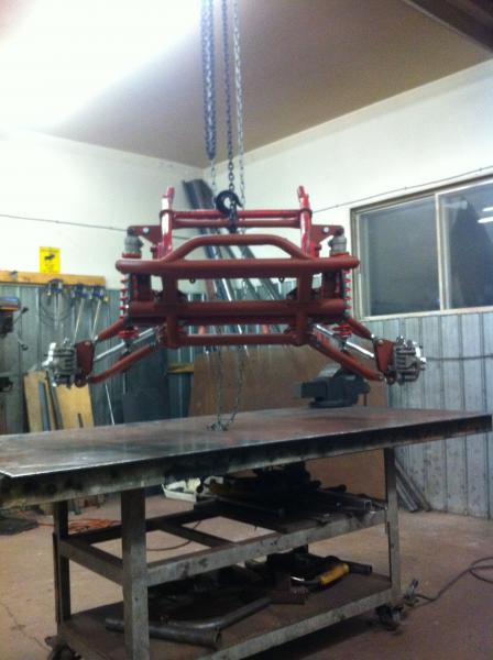

few pics of my bolt on front suspension

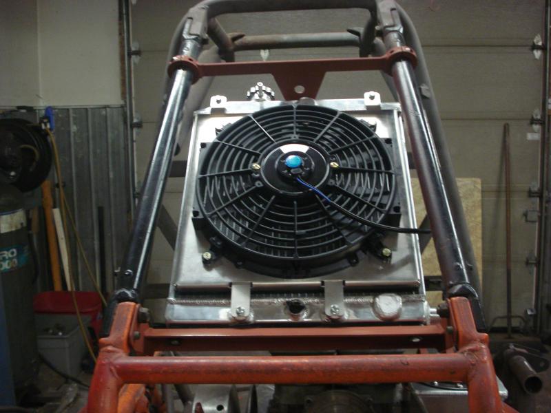

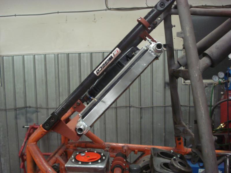

Im now including the fuel cell and rad brackets in the conversion kit for no extra money for both the 350 and 400 to make the conversion easier

PostPosted: Thu Sep 24, 2015 3:18 am
I like the Fuel Cell
? will that fit in a stock frame and Stock Engine,
yeoddy
PostPosted: Fri Sep 25, 2015 3:32 am
Joined: Mon Aug 05, 2013 12:19 am
Posts: 71
Im not sure if it will
PostPosted: Sat Sep 26, 2015 9:33 pm
Posts: 71
It fits in a stock frame im just not sure about the stock Engine
PostPosted: Sat Sep 26, 2015 9:41 pm
Joined: Sat May 30, 2015 1:40 am
Posts: 117
Location: Riverside Ca
it looks like it sets where the transmission goes
