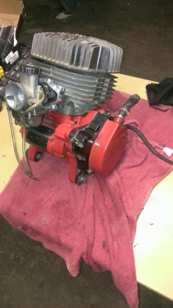

All together fresh seals and top end waiting on leak down tester install then ride

Update it poofkaboomed plug is the right color cheap eBay seals are at fault

Is that an aftersucks intake ??
If so watch out. My brothers leaked right from the start. We even tried silicone and it still didn't help.
There are a few problems with the aftersucks and one of them is that the rubber isolator does not fit properly on the face of the manifold. When you try to tighten it down it bows the plate that is inside the rubber and this causes the isolator to bow and the seal is lost. Watch out !!!!

Which seals did you buy? The set that oddatv sells?

Got all the parts from evilbay local Honda shop bored jug. The fl700 Tested good on Sunday stock ones on back burner
