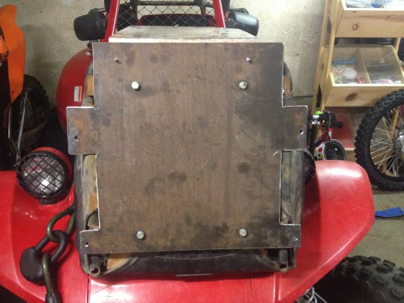

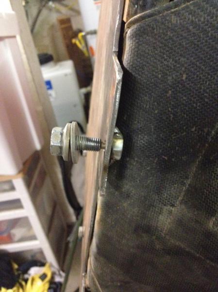

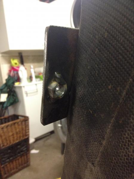

I've always wanted to add a suspension seat to my pilot but did not care to chop up the stock seat mounts to the frame. I got this seat from Dave-Co that he got from one of his pilots he bought.
The seat came with a steel plate that was used to work with the stock frame mounts. The only problem was the plate was too big and cutting into the electrical wiring harnesses to go along the frame to the Engine. Soooo, I made cuts on the plate and welded nuts on the opposite end so I could still use the stock seat bolt mounts.
The plate works great and I can still slide the seat front and back no problem. Took for a quick ride on Sunday and WOW what difference from the stock seat to a suspension seat..

Do you notice any seat height difference? Do you sit higher up with that plate vs. the stock seat height?

The seat does sit a little higher but not to the point it feels wrong. Because the seat is bigger in depth and width than the stock seat, you do lose some adjustment. I'm 5'6" so I have no compliant. If your over 6' do what hoser said and try one with a suspension seat before modifying your pilot.

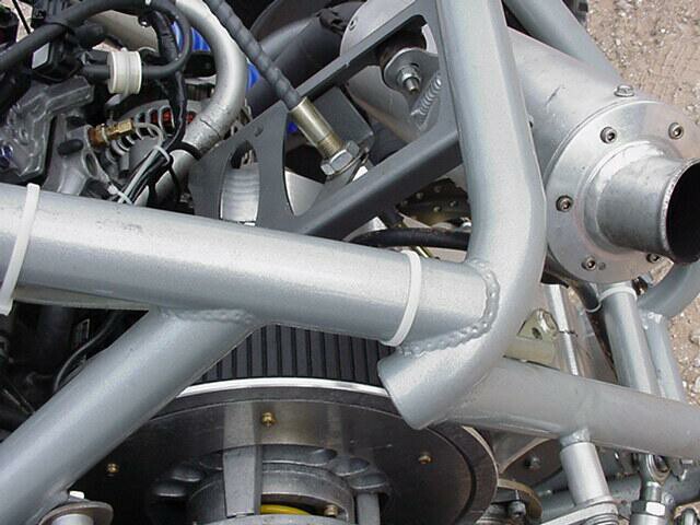

I know what you mean about the bad welds you can find many examples all over the web most I have found are post on sites that has fabrication and by the person that made the weld, they don't even know they are making a bad weld and think its a good weld so post pics to impress their friends, then many of them cheer the bad welder on and tell him how great his is, blind leading the blind, most the welds I am talking about would never pass a visual weld inspection the weld inspector could simply look them out, no need to measure anything lol
I have seen perfect looking welds on tube chassis that are very impressive except for one thing they did not use enough filler material so their is visible undercut on the surface hard telling how much they thinned out the tubing on the inside, what good does it do to use .095 "Chrome Molly Tubing" when your done welding it and its .060 thick at the welded joints where most the strength is required? Then you point this out they get all pissy about it and their know nothing friends gang up on you haha
Entertainment value is very high on them fabrication sites, another one of my favorites is the new pulse feature they are putting on welders now guys are taking a mig and trying to get the visual appearance a tig leaves and delaying the pulse so much that they have nothing but a series of tack welds stacked together not understanding its a cold weld and has little to no strength, it takes no longer to make a proper weld.
For example I like this one its a series of tack welds, includes cratering, welder clearly had 0 welding skills, owner that accepted the welds and sold them to some unsuspecting owner had no clue what a weld is either, this is why I have made attempts on the fab sites to educate the onlookers who have no clue what to look for, always backfires, I am instantly demonized then flooded with a bunch of replies like "his welds never break" "no problem so far" etc. I am sure you have seen it play out before :-) stupid defending stupid hence the saying 'you cant fix stupid' if someone died because of the bad weld these morons would either hide and be silent or make up other excuses and blame the user of the weld not the welder, strange world we live in .
