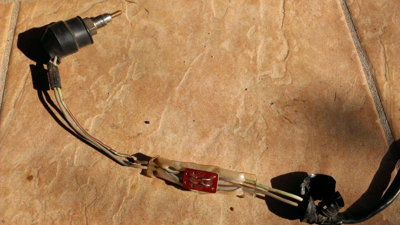

Was this suppose to be soldered on or did there use to be clips or something I snapped the one wire off twisting it out

What you have there is the neutral start switch. The wires should be soldered to the switch itself without any kind of connector. This switch was in place as a safety feature by Honda so that the Ody can't be started unless the Ody is in neutral.
Now you can attempt to fix the switch or you can put the switch back into the transmission and do away with its electrical connection altogether.
You can bypass the switch by cutting the remaining wire still attached to the switch itself, crimping the two wires which led to the switch together using an eyelet and then attach the wires to either the negative side of the battery or a spot on the frame. This will ground the system again and allow the starter switch to work. If you are going to do this, I suggest the negative side of the battery.
WARNING!!!!! Performing this modification will allow the Ody to start in FORWARD NEUTRAL or REVERSE!

Thanks for the reply rand I think I will try to repair it for safety reasons wouldn't want someone climbing into the ody who doesn't know and starting it In gear. We must protect the general population from themselves.

Is there a way to test the neutral start switch? Make sure it works

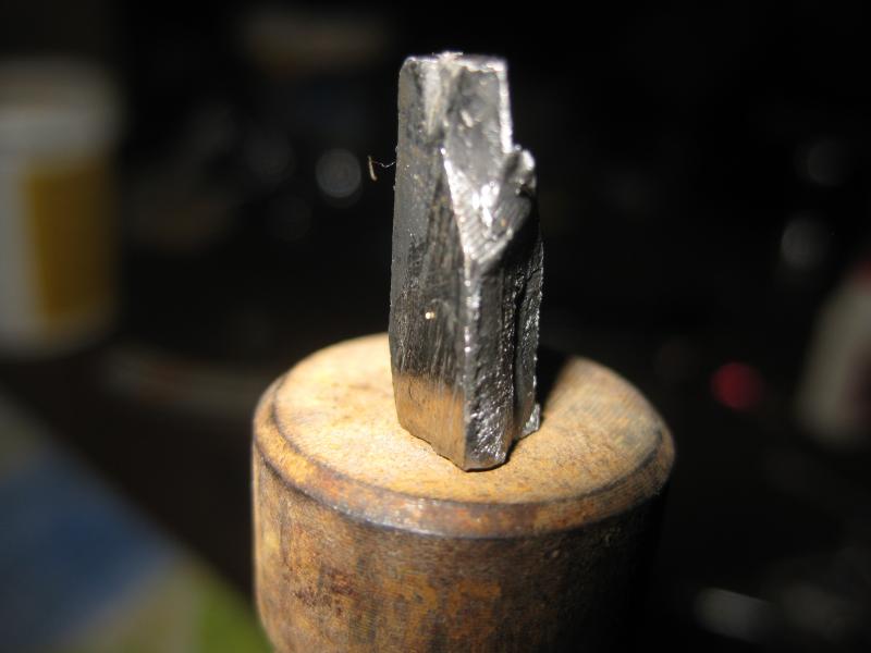

Nice to see another 350 brought back to life
The switch in your and looks to be missing the plunger part and the
end of the switch.
see pic
yeooddy

That's not good what are the chances it's inside the reduction case? It looks like it snapped off :(

I am glade you said that. That's the first thing I thought of
You could be lucky. drop the drain plug on the tranny.
Drain in to clear container through a good clean white shop rag over the top and look @ the oil if it looks like
See pic
time to pull the tranny and strip and clean
The missing piece might not even be in it
It is one of those dam if your do and dam if you don't problems
Contact the guy you got it from and ask the ? did you see where it went

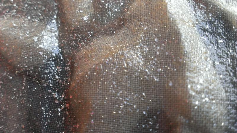

So I drained the tranny and the oil look like crap multiple colors different consistencies. There were little metal flakes in it as well as silver paint? Maybe from who ever painted the Engine and tranny silver?

The silver paint in the oil is not paint..... its metal and or aluminum from transmission wear.

(-_-)/ I have a few questions, so its "normal"? lol. should I flush it out with a few bottles of oil. pull it out and take it apart? whats the 2nd option entail? if i do pull the case apart then what, spray it out with some cleaner? wish youtube had fl350 how to vids.
 Post subject: Re: BL1TZ's Odyssey
PostPosted: Mon Jun 01, 2015 11:07 pm
Pour the dirty oil through a filter and see how big the specs of aluminum are. Post some pictures. If they are no bigger than what I see in the pictures, flush it, refill it and run it.
PostPosted: Mon Jun 01, 2015 11:11 pm
Yes they are metal,either aluminium or steel.
To tell which one,drag a magnet under your container.
If it balls and moves it's steel-bearings,shaft,gears,if not then alu from case bearing spinning.

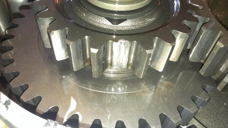

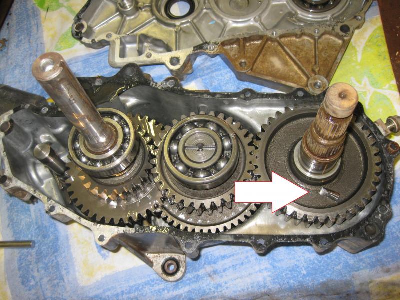

PostPosted: Tue Jun 02, 2015 12:05 am
The Oil looks pretty good
As per Randman and Bugeye59 suggest.
But the ? is where is the Tip of the switch is it a sticky one
I ran my tranny with a broken AB gear for 300kms As I found the silver flakes
as I was prepping for the next ride, lucky I start a Month or so before a ride.
There was a noise in the back end @ high speed But I thought is was the shot
bearing I found, but me was wrong.
File comment: Broken Tooth off the AB gear
File comment: Where the tooth was setting when I pulled the Tranny case off
File comment: AB gear less a tooth

i filtered the old oil through a pair of pantie hose, they make a great filter lol... then i did a flush of the tranny and filtered that as it came out. i didn't find any metal flakes on the "filter". I also didn't find the piece of the neutral safety switch if it is indeed in there im not sure. anyone know what that lil piece is made of is it magnetic? is there enough clearance on the inside of the tranny for a drain plug with a magnetic tip?

Sounds like the internals might be all good
I am not sure what the tip of the switch Steel or ?
There is about 2mm at it shallowest between the final drive gear
and the tranny case.
But then again I had the bit of AB gear floating around for a while.
