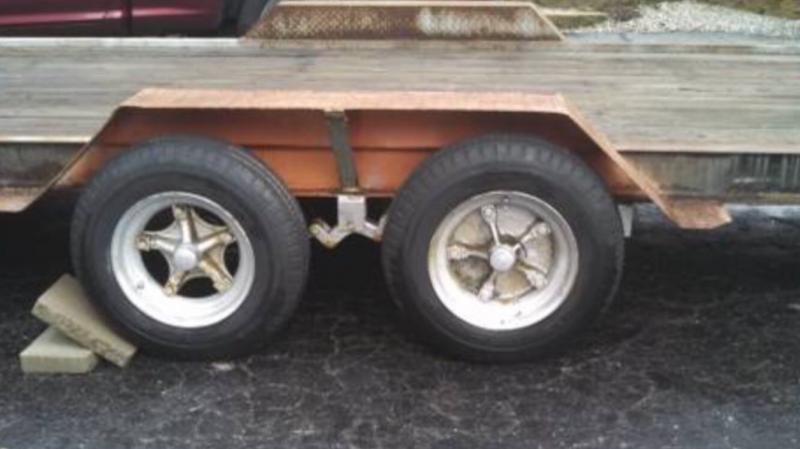

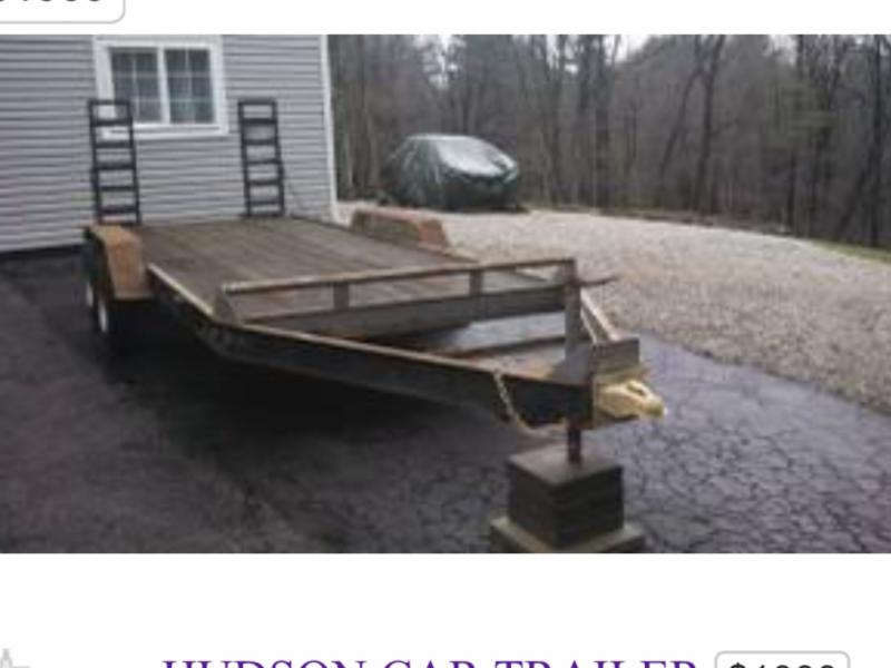

I have been looking for a trailer for a while. Found one Christmas weekend. It's a 1989 Hudson 16 foot deck. Trailer weighs in at 2000lbs with a carrying capacity of 10,000. Electric brakes on the rear axle only. It has sat for many years, has dry rotted rubber mounted on the Dayton motorhome wheels, dexter axles. The work begins to bring her back to life.
File comment: Sitting at previous owners home.

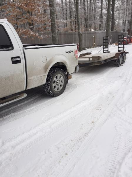

File comment: First pull to its new home, icy drive.
File comment: Wheels and cracked tires
