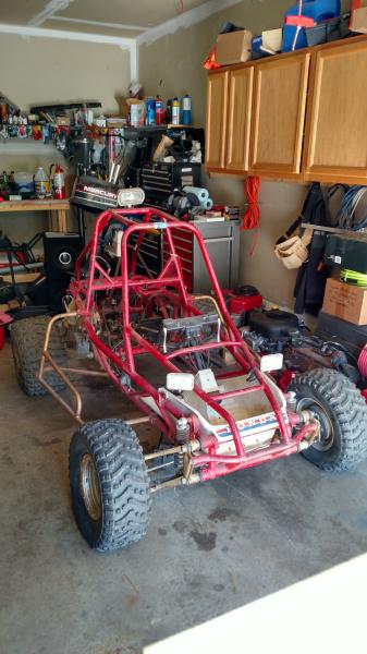

Picked up my FL350 yesterday. Needs a good amount of work as its a roller now. Some interesting things I have discovered so far:
Cage is welded, not bolted like factory. I have read things on here about people not being a fan of that, and that something might get bent if crashed. I ran about 25 measurements across the frame, and its square and straight.
I have not seen any others with these bars on the sides so car, anyone know if they are factory accessories or aftermarket?
Does anyone know if factory shocks are able to be rebuilt?
I plan to mount a rotax in it over the winter. I wanted to get it done this summer yet, but I want to do it right. I plan to pull it all apart, once the motor (( Internal Combustion Engine ? )) is fitted have the frame and all suspension parts powder coated factory colors. All new bushings etc. Unsure of what I want for wheels and tires. I will update this as the build goes on. So far people have been very helpful on this site. Thanks!

The rear shocks can be rebuilt if you can find seals. I took mine to several shops and no one had them. I may order a seal set for rear pilot shocks and see if there the same. The shaft and body diameters seem to be the same.

I was looking at that machine online as well. Can I asked what you paid ??
1) Those side rails are not stock and if the guy just butt the tubes up to the frame and welded I think they will just tear off and damage your frame tubes (the oddy frames are real thin tube). Don't like em. I was gona cut them off if I had it.
2) Like was said the rear shocks could be rebuilt but you need to find seals - that's tough.
3) The fronts could be rebuilt as well (I had a thread going on mine when I cut one apart but again it's finding the seals that's the issue). I think buying other shocks is probably what you are going to end up doing as you won't find the seals.
4) Why rotax ?? Don't have original Engine ??
Found it (front) --- viewtopic.php?f=1&t=15072&hilit=shock

I paid a little over $500 for it. The bars on the sides bolt onto the lower part of the frame with a small round clamp. They are gold like the front suspension arms, which is why I thought it might be a factory accessory. The unit did not come with an Engine or seat, but I do have the seat frame.
I figured a rotax would be lower cost that trying to find a running factory Engine?
Wow nice machine for $500
I paid $1200 for a completely crap machine with no fenders, junk wheels, no gas tank, smashed front plastic tube and no stock seat but some kind of giant seat installed. The only reason I bought it was for the trans, axels, led lights, various small parts and the rebuilt Engine it had in it, but I will have to take the Engine apart anyways to inspect. Frame seems straight too.
If your side tubes are bolted on your good. The gold paint Honda used you can get at a hardware store. It is gold metallic and matches perfect. Don't know where you live but there are members here who sell lots of oddy parts incl engines. I bought one from B.S (screen name here). He lives in cali and has lots of fl350 stuff he was trying to sell off. Send him a pm as he may have a seat, who knows. Rotax swaps have there own issues. Don't think you can use the stock gas tank so now fuel storage becomes an issue. I am not a fan of the large fuel tanks mounted over a guys head. It makes the machine top heavy and it's dangerous in my opinion.

Tell you what, I do not like the "hard" front bumper what-so-ever. Use your imagination as to how that frame could collapse & fold up if you tried to mow down a tree at 50mph. Maybe the prev owner was tall and needed more leg room (?).
Stock front end has a "collapsable" bumper and then both the upper and lower frame absorb the impact on the two front cross tubes (j-arm mounts).
