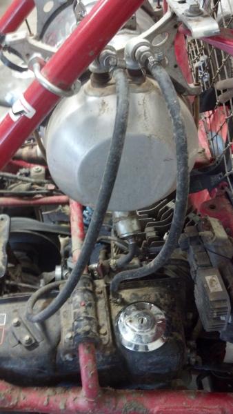

It has a aftermarket spun gas tank. Gravity fed. Plan on taking that off, put on Yerfdog, and go back to stock gas tank, have fuel pump ordered.

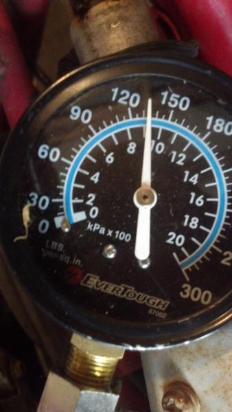

Did a compression test on it. reading between 132-135. Engine has been rebuild. Not by me. And not sure if was done correctly. (Bridge ect...) Previous owner did mode it out. Did have works shocks. Does have extra air intake for the air box.

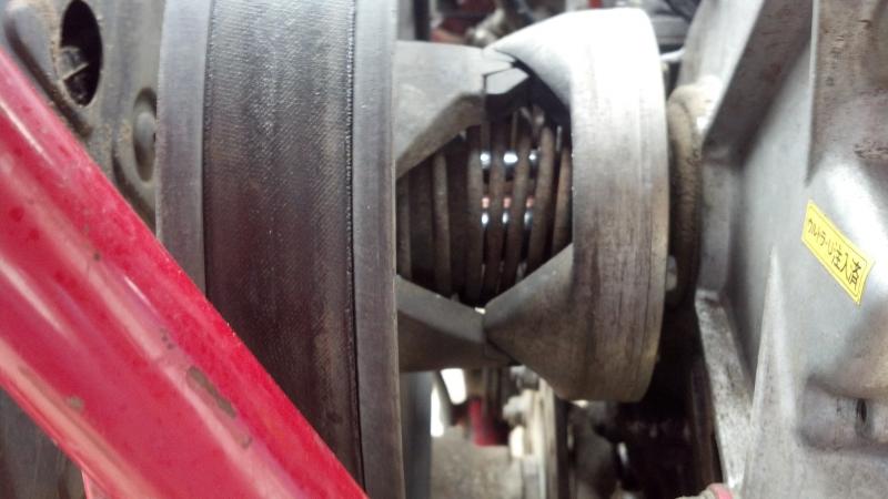

Just lately, noticed the clutch is not moving as smooth as it did. I've looked at manual. And they do have their own suggested lube to use. Question. What's a good lube to use for the clutchs? (maybe something I can pick up at local auto store)? And cant find this either. Where do I lube the clutchs at? I've read just lube the washers? or something like that? Still don't help me. Would like to know where to lube the front and rear clutch. If they both need it.

5) Driven clutch: I lube ours with Vaseline but others use dry graphite or the comet stuff. I lube the slider area where the little rubber pucks slide and in between the sping on the polished area.

That being said, I do want to go back to stock gas tank, and setup with fuel pump. The way he has it setup, is little different. There is a line from center bottom of tank. That's the only line, that goes into the carb. There is 2 lines from the spun tank, and 2 lines coming from stock tank. There is a fuel pump. don't know if it works, just went ahead and got a new one. one line from each of the tanks, goes into the other tank. One line from each of the tanks, goes into the fuel pump. And the fuel pump is hooked up to the Engine below. Some kind of duel tank setup?

You could remove the tank and put it back to stock
If you do a lot of long rides the top tank could be set up as a Axillary.
I have my plumbed up so I turn the top tank tap on and it fills the main tank it gives me double
the ride distance
But for now remove the tank and set it up as per pic
get it running right then add bits.
Get a new pump chase down a fuel check valve and check it works as per the diagram.

oh... something that I found odd. The fuel lines that is run on this setup right now is huge. got to be 1/2 or so. along with the fuel filter. So wondering if he was having issues with his current setup.
Is 1/4 fuel lines big enough for the fuel pump setup? or should I go up a size up?

As Wyeeoddy mentioned loose that fuel contraption and go back to stock. It's going to cause nothing but headaches.
If you are going to run the stock setup then the required fuel line size is 3/16". The size of the line from the pulse tube on the bottom end to the fuel pump is 1/4".

Unless you triple wrap the K&N, loose it and go with the UNI dual filter. K&N filters on their own do little to nothing to stop the flow of fine dust into an Engine.
And in order to get the box to work correctly you need to fix the hole.

Guess you'll half to explain the triple wrap.. what am I wrapping it with. And how? If I need to buy some new filter fabric, then guess will just buy a uni. My to buy list keeps going up, and haven't even got the fuel issue taken care of yet. :).

You seem to be real hung up on the filter thing.
What he means by triple wrap is he is wrapping his filter with filter socks. You can buy them.
Lets face it, Honda got it right with the air box when it comes to filtering but if it is a pain in the arse for you and you want more air you can run something else. My brother and I use a K&N filter but I use a pair of my old socks and a womens nylon to cover that. The K&N is nothing but a fly screen anyways. It seems to work well enough for me but maybe not you. Your choice it's your machine.
In my opinion you MUST get that fuel thing under control first, screw everything else. Then run GOOD fuel. Read the manual on the min/max octane rating you can run (Go with the max).
