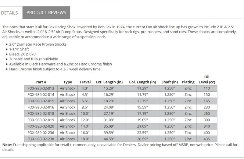

I am wondering if anyone has tried to fit these shocks on the front of a FL400 with stock arms and stock brackets? Here is a link with collapsed and extended lengths for various shock sizes…
http://www.polyperformance.com/Fox-2-0-Air-Shock
I am not sure what the length specs are for the stock front FL400 shock.
I know the Yoda arm kit calls for the 5.5’’ travel shocks #980-02-015-A and using upper shock mounting brackets. Has anyone tried THESE shocks and brackets with stock lower arms?

That was the first suspension mod I made on my Pilot, its been so long ago I forget the exact details, I changed my upper mounts to adjustable mounts because at the time I was not sure what I wanted to do and wanted adjustability, I fabricated all my own spacers, I used 1/2" bolts and drilled out the lower holes in the arms.
I love them I used them with my +2 arms too, using the stock arms I went from bottoming out the front suspension 500 times a trip to never bottoming. the improvement was so great the rear shocks felt like they needed something so I replaced them too.

Think I used the 4.5" stroke, its been so long I cant remember for sure, if you check the over all length I think it will be self explanatory.
