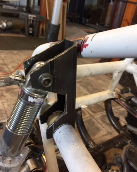

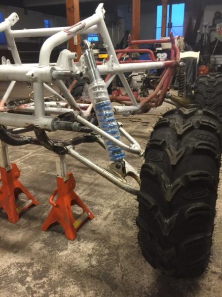

I had some time today to work on my project. I got the upper shock mounts installed today w/long travel shocks. I can't believe the difference of the works shocks over the OEM TRX450R shocks. With no weight on the shock, I set the upper shock bolt center to provide 11" of travel. With the weight of the buggy on it, it dropped about 1 1/2". I know these shocks are pretty nice and I need to learn how to adjust them properly. Although, they feel great bouncing on it. I could have made the front higher off the ground but I think it looks good at this hight & feels good sitting in it. I'm happy with the progress so far. I took some measurements today and turns out it is actually closer to being "square" than I thought. About 1/2" wider in the front on each side. 8" wide front tires

Looks good.
Slick shock mounts!
Is there any droop left? Or are the shocks fully extended?
If you ride somewhere smooth, dirt roads, groomed track, etc., why do you want it so high? Lower the better for me.
If you'll be in big ruts, then different story.

Thanks! I am pretty sure that I can get more droop out of them if I make the shocks softer? I sat in the buggy, had my father jack the front of it up and down and that spot just felt right. Some of the riding I will be doing will be on dirt roads but also some old logging trails with obstacles that require clearance. Here is a vid of me (140lb), Engine & trans installed, bouncing on it, as is. Not sure if anything can be judged by it or adjustment recommendations.
https://vimeo.com/189563988
If I were to lowered it I would lose suspension travel.

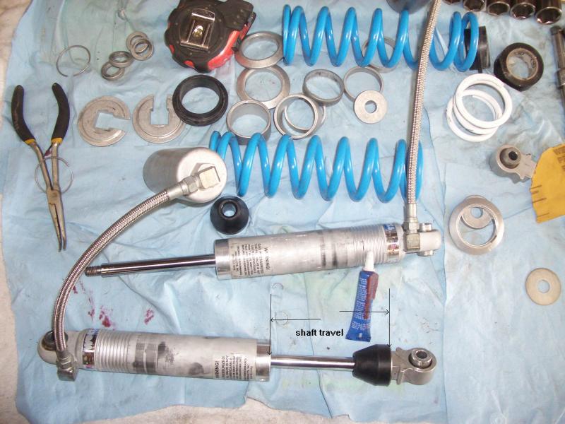

Sorry for not explaining myself better. Since you adjusted your pre load via the collar which allowed your ride height to be lower it did indeed make the shocks softer. It also reduced the amount of shock shaft you have for bump. This also changed your bottom out poundage. What that means when the suspension goes into bump or compresses the spring poundage is less. Basically your spring rate from cross over has changed for a given amount of shaft available. Not a real big deal as the car may bottom easier that all.
Here is a pic of the shaft. and what to measure.
With the shaft length and the wheel movement allowed by the shaft you get an lever ratio. Wheel moves 12" with a six inch shaft its a 2 to 1. wheel moves 6 inches and the shaft is 6" than a 1 to 1. if you eye to eye is 22" with a six inch shaft the compressed eye to eye would be 22-6=16.
Now you can remove the shock set the wheel at 22" eye to eye on the shock mounts than raise the wheel until the eye to eye is 16. then take the vertical wheel movement number and divide it by the shafts length. Now we have a lever ratio to work with.
See when you raise that ring at the top of the shock which takes away preload poundage. the shaft will be at a shorter distance to bottom than before. This also changes the way the tender (top) spring bottoms out against those rings and goes on the Main spring. we call tis transition to the main. If you combined rate of the two springs are 100 lbs and the main spring is a 200 then the this leaves you with less bottom out poundage. Ill write you something up and post. no big deal. I was just wanting to make sure you did not soften it up too much. It can be simple fix just by adding additional spacers on the tender so it crosses over to the main sooner. Since you have no valve adjustments like low speed compression.
