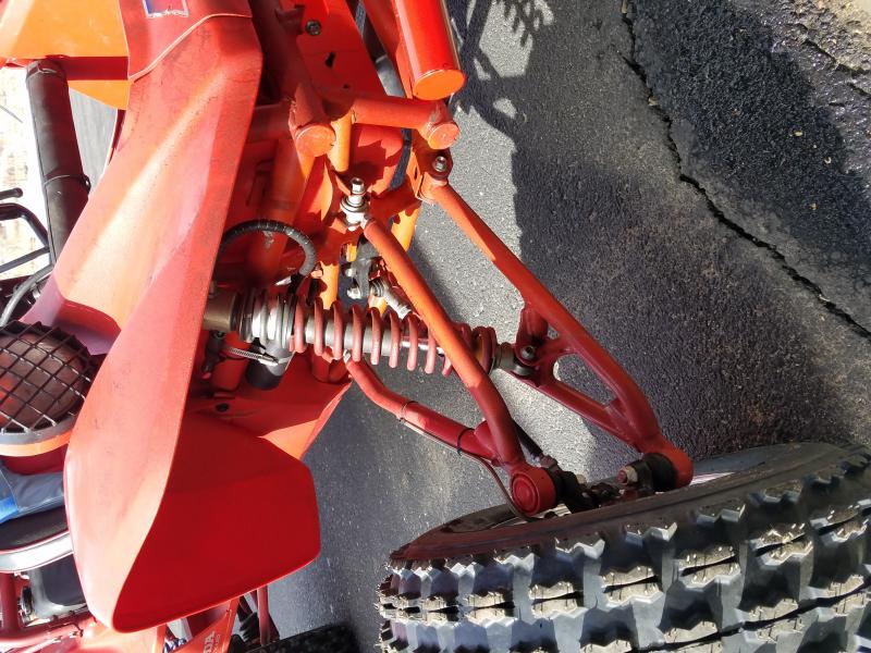

Today is the start of my project. I had bought this pilot about 3 months ago and have not had much time to touch it.
The goals are to have a clean reliable pilot. First im going to remove everything to get frame a arms ect powder coated.then fix or repair any thing worn out or broke.there are a few questions I have the Engine looks to be in great shape same with the aftermarket exhaust. But I was thinking about a Rotax or simular swap ? Also I noticed on my friends pilot the front brakes are not good so I think I'll get disk brakes up front. What other things should I do or look for when I have it apart?

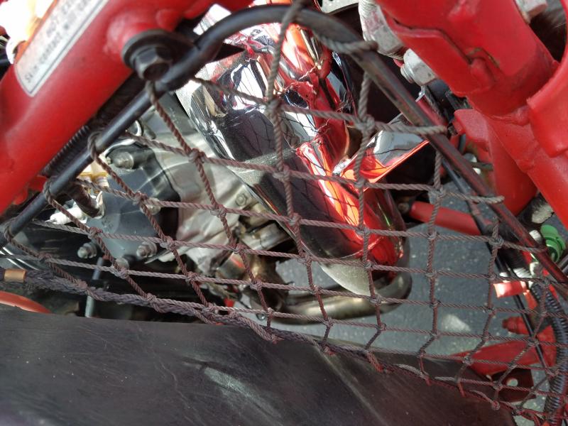

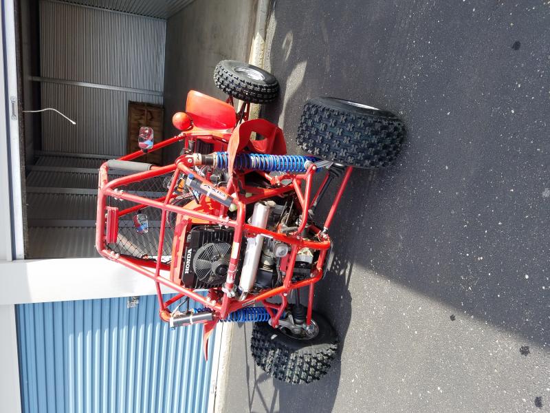

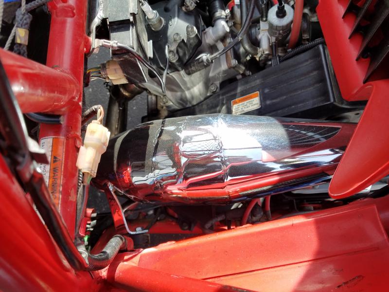

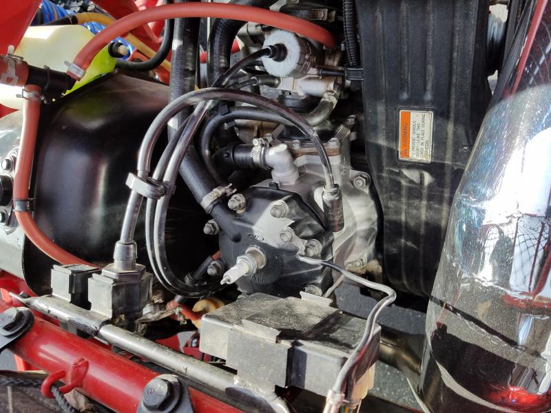

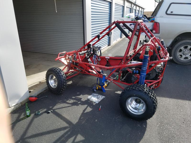

Here some pictures and the Engine I'll most likely be selling
