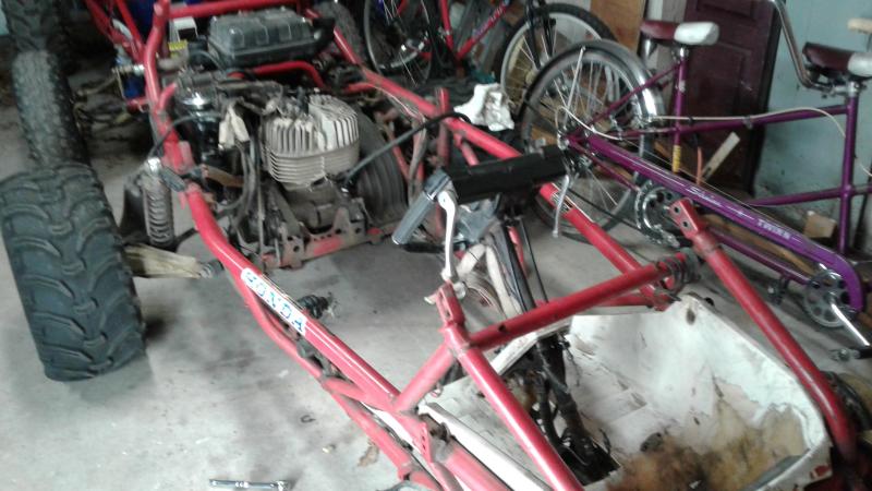

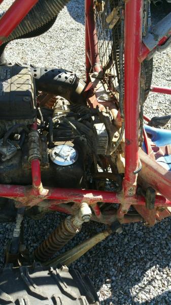

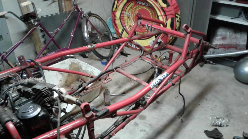

Started tearing down my fl350 today. Going to be a long journey, it was abused by its past owner so i decided to resurrect it.

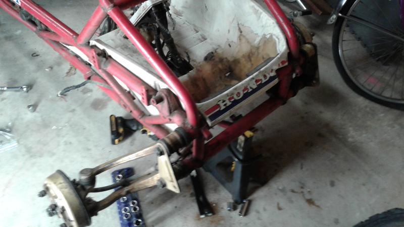

More

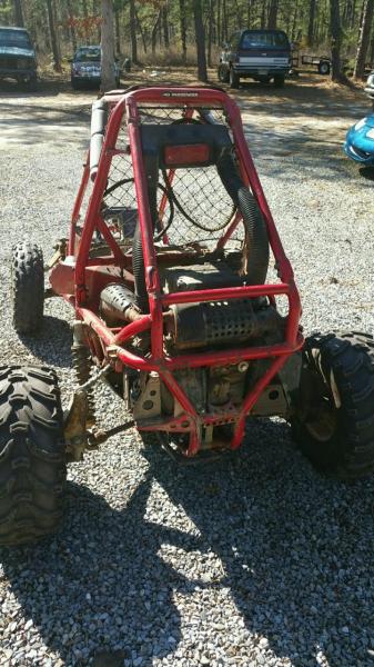

This should a easy fix
But a leak down test would hurt
There is NO Reverse Switch in the Gear box
See your pic oddy5
So the rev limiter would be Activated
unless the Limiter Mod has been done.

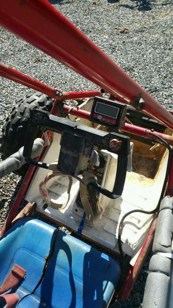

Got some work done this weekend. excuse my absence of knowledge but how will that ''mod?" make a leak down test hard? Also in the front where my j arms connect to the frame is bent, how can they be re-straightened?

You are going to find it very hard to straighten those bent J arm mounts. You might have to run what you got as long as the top arm don't interfere with the shock. I had some, but very little success with a sledge hammer on the ones on the death machine. I was using a twenty pounder. I don't think I can recommend it but if you do then you better make sure you got the nut on it so that you don't smack the threads. Also you better have a spare nut because it will be toast. The death machine had a bent frame from the crash anyways so I didn't care.
