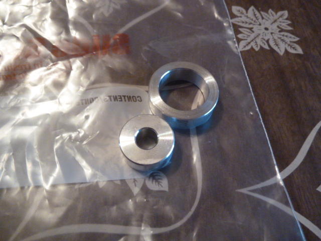

Starting on the install in to my FL350 and i have just about worked out the brakes for the Engine mount but not sure about the 2 parts in the picture. Also what extra bolts do i need?

These spacers are for the driven clutch so it will align with the Rotax drive clutch.
Remove your driven clutch and install the spacer with the larger ID hole on the shaft. Re-install driven clutch and put the small spacer in the cavity formed where the clutch bolt head goes. Install driven clutch bolt and torque... good to go.

oh that explains it, thank you very much for your help
