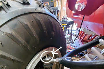

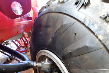

Well, been long time coming.. but re-installed the front end on the Pilot..
However, I believe the right steering knuckle is bent.. Look at the grease fitting in relation to the wheel.
From what I can tell, these are also NOT stock FL400 knuckles..
Anyone have luck bending them.. just a little bit..?

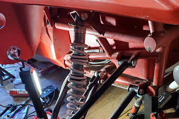

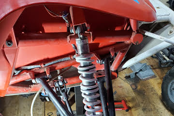

Couple pics of front end back together
