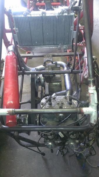

Putting a bigger motor (( Internal Combustion Engine ? )) in my fl350 .I'm not shure how the transmition is gonna
Hold up any advice .

More detail pics please..
Where are you from?
WHY? Everybody has a reason/story for the Engine swaps whats yours :-)

Have any more Engine mount pictures. I don't know what is up with that first picture but its playing tricks with my mind thinking what you did. Engine behind the trans? that Engine will never see the 120 HP with the exhaust the way it is. 2 strokes need the pipe to make all of the claimed power. Some more than others.
Only way to make the ody reliably hold up to that much power without having to baby it is to put in an entire different transmission/axles.

I did rotate the transmission forward and remake the mounts I was going to put a jackshaft in it like a sled but didn't want to lose reverse . no pics as of now I work out of town will post more pics next weekend
 Post subject: Re: fl700
PostPosted: Mon Aug 04, 2014 2:39 am
put the trans back
modify the stock chamber pipe and make the exhaust work that way
can you take a photo of the underside of the Engine?
i want to see what the bolt pattern is like

What's wrong with the transmission I feel the gears are still gonna rotate inside the cases am I mistaken or what other problems do you forsee

B S wrote:
put the trans back
This is correct. That exhaust will never let you see that engines potential.
You need the 2 stroke pipe...
Regards
PostPosted: Mon Aug 04, 2014 3:04 pm
I don't think there is a problem with the way the transmission is sitting as far as operation goes, but i think it would be much easier and cleaner job if you put the Engine back in the stock location, that way you can use the 2 stroke pipe and don't have the carbs sticking out the rear of the frame. Im guessing its going to be a wheelieing sum bitch and with your carbs sticking out the back you are going to knock them off sometime.

Ok see ur worrie now was planning a rear bumper to cover the carbs and cone filters .the wheelie problem I planed to solve with dual fuel tanks teed together in the nerf bars as far forward as I can get them

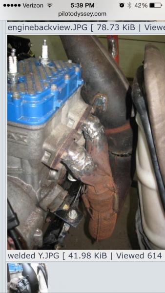

PostPosted: Mon Aug 04, 2014 6:03 pm
Can you modify pipe? This is what I did to my conversion. The one thing I did
change, was to remove the tab on the chamber that attached to the Engine.
The pipe should, in my humble opinion, only be mounted to the Engine at the
header with springs. The vibration will crack the pipe mounts. This I believe is how
the Odyssey and Pilot came from the factory.
Regards

and looking at it again (not drunk this time)
do you have the belt in between the axle???
if so that's going to be a giant pain in the ass to change the belt
PostPosted: Mon Aug 04, 2014 6:22 pm
No but it looks like the axle is running through the belt...

Yeah it's not too bad to change I'm gonna get a spare ziptied up to the frame around the axle for a quick change
It was relitvely easy to install 2 axle bolts and top shock bolt removed slides right in

I see a stick,rock,branch,ext ruining your day

They won't I sweep quite often lol
I planned a full skidplate when it's done

Is the 700 Engine a triple?
PostPosted: Tue Aug 05, 2014 8:51 am
Joined: Thu Dec 05, 2013 11:53 am
Posts: 19
Location: Rome Pa
No its a 98 xc700 twin
PostPosted: Tue Aug 05, 2014 12:59 pm
Oh hell...I just now realized it's actually sitting in the frame in the first pic. Haa :-)
