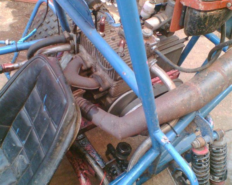

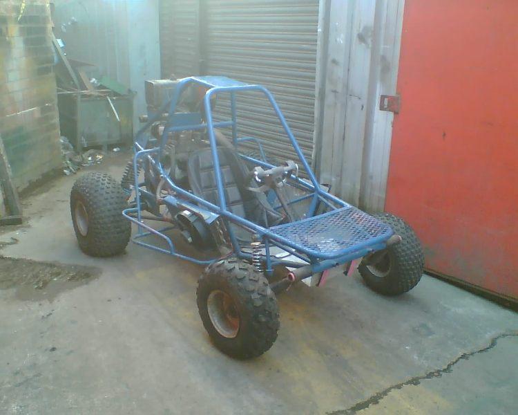

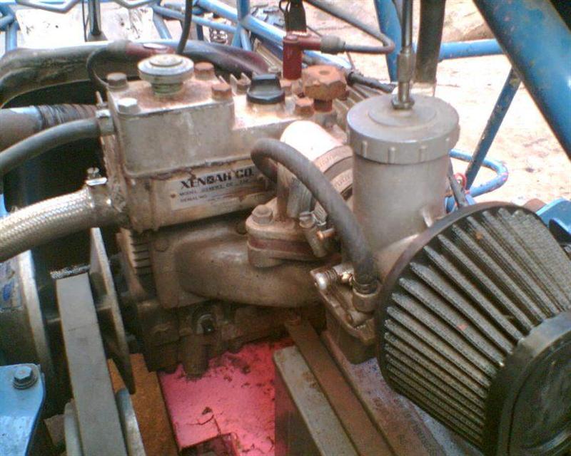

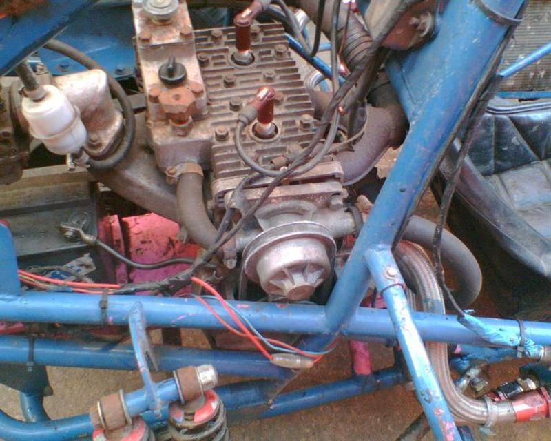

Hi, lee from the united kingdom I am new to this site, I have had a few pilots and now have a pilot with 800 rotax Engine.

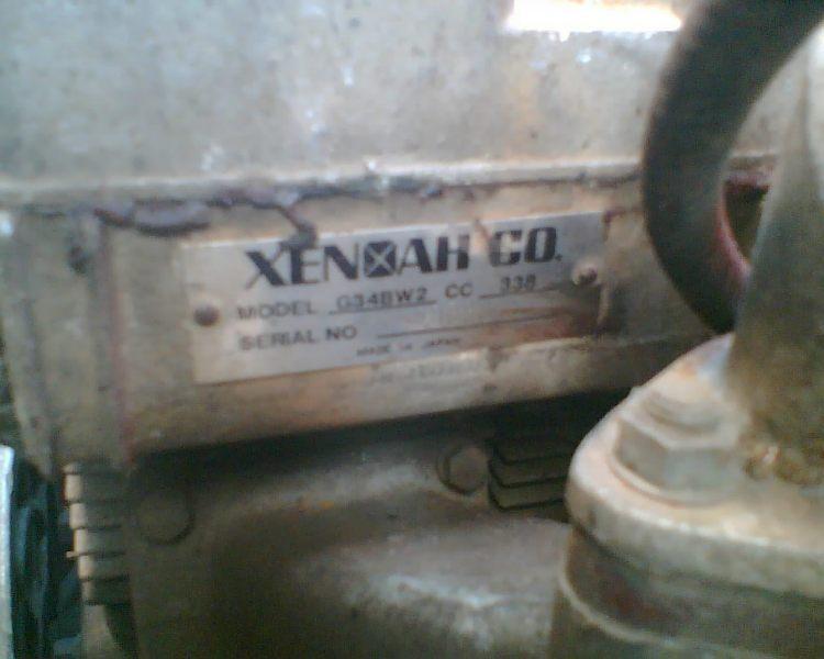

Last week I bought this buggy, Someone has told me it could be a challenger which uses odyssey parts, but this has a xenoah 340cc twin Engine.
Any infomation would be welcome.
Thanks Lee.

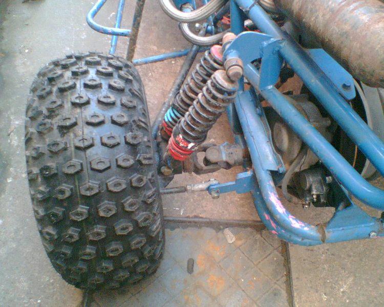

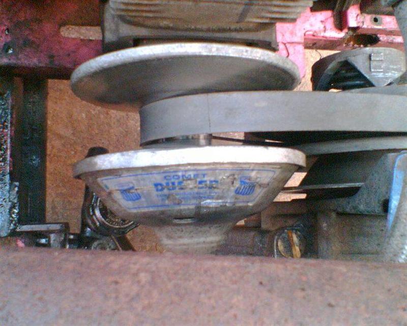

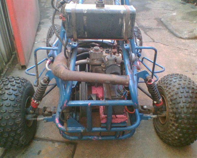

Some photos

It looks Challenger to me here is my old one http://pilotodyssey.com/challengerhome.htm
Pains me to see a full size car battery being carried around in a buggy so small lol

Looks like mine (minus the angle iron for a bumper) Yeah its a challenger. Fun machines in my opinion. =)

Are those rose joints just to the rear of the drive shaft uv standard, they are not fitted to the challenger of hoser. And my front j arms look different, maybe just gussets?

My Challenger had brackets for the extra links on the rear suspension but were not installed when I bought it I never installed them.
I have seen many variations of J arms for the 250 over the years if you look in the Challenger catalog you might see exactly what they sold with the car. http://pilotodyssey.com/challengercat1.htm

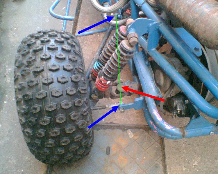

Look at the pic below this is the mod TurboTexas needs to make, I was told the pivot point for the added arm needs to be where the U joint bends.

Unless I have misunderstud you, The front pivot (visable between the braded hoses) the UJ, and the rose joint at the rear all need to be in line, not where the green line is unless the UJ is plunging which I do not think it is.

Forget all about the front pivot point only look at the green line and the 2 arrows I added
The way it was explained to me was that the center of the hiem joint in the link should be in the center of the U joint so when the axle angles the added link bends at the same hinge point.
Maybe I am missing something hey LEE!!! what you think?

The U-joint needs to be in line with the 2 rod ends, in 3D. That is, draw a line between the center of the balls on the 2 rod ends, place the center of the U-joint on that line.
For a retrofit to a FL350 (with lawyer link steering gear) the front rod end and the U-joint are already set so you need to place the rear rod end on a line extending from the front rod end to the center of the U-joint (actually the line will extend beyond the U-joint).
On Polaris vehicles they some times fix only one side of the U-joint to the drive shaft so that the other side can slide a little and make up for any variation in manufacturing. But to do this you need a splined joint. I do not recommend this on a system using a key.
Other suspension systems may vary, this information is only good for a swing arm or a system where the drive shaft is perfectly in line with the lower arm.

Can you take some closeups (including underneath) of your rear brake caliper, I'd like to see how the hydraulic unit was fit in there.

Yes I agree with Lee (that's Lee not Leegb that's me, too many lee,s) Only thing Is something is not quite in line there the green line does not go through the center of the UJ.

Are the u-joints floating on the axle splines or are they clamped down or bolted to them?
If they're floating that would help if there was a little misalignment.

It is not the original caliper, To be honest the brake caliper mount is a total mess and you would not want to copy it. The only thing holding the blue bracket to the main frame that 1 bolt you can see in the pictures, If you were to use the brakes whilst rolling back it would rip it off. I will take a few pictures after I have modified it if you like.

I assume they are clamped because some run them (like hosers) without the rear rose joints and they would wobble or come off.

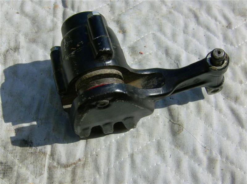

Here's some pics, the pin goes into the gearbox and is held in place by one bolt:
I will see about getting a few pics of one mounted.
