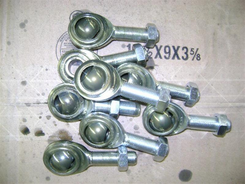

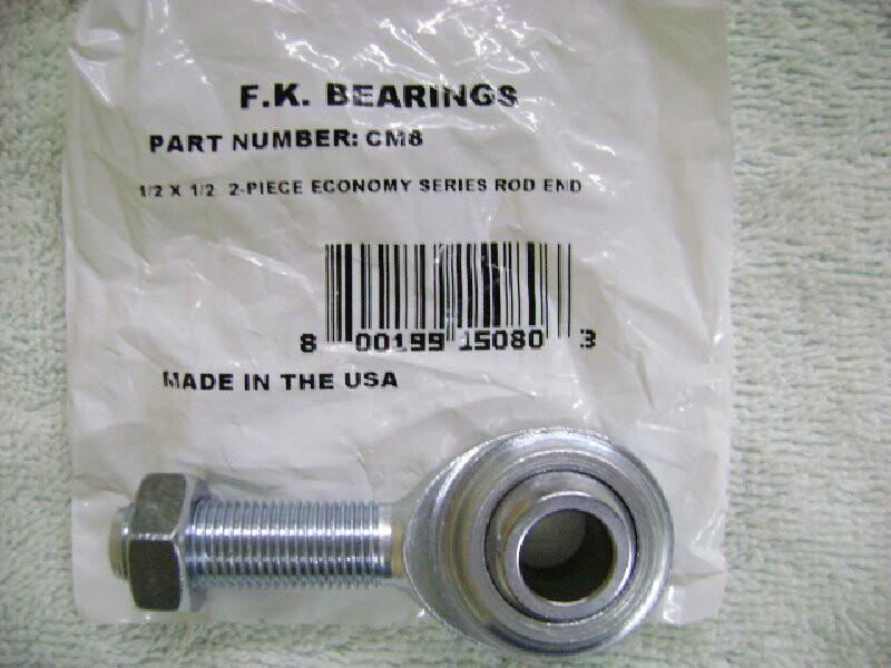

I might as well start here now, today UPS guy came like Santa Clause and delivered my 8 rod ends, 8 jam nuts and 12 rod end seals, not related to this project he also delivered my lift kit for my 72 GMC...

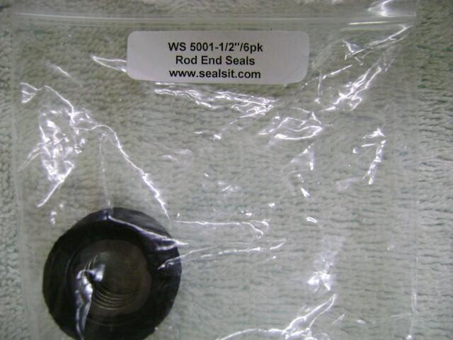

Rod end seals.

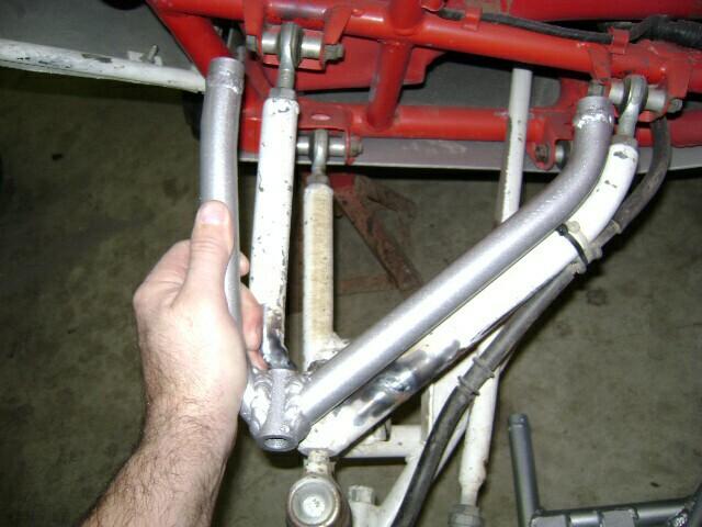

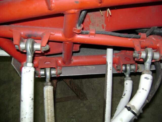

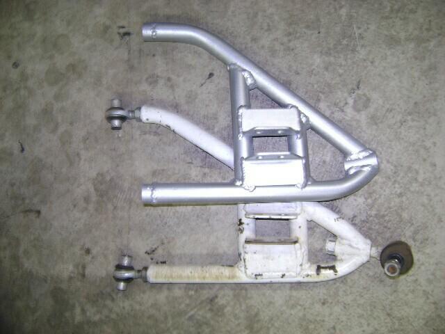

The YODA arms came late yesterday, I didnt even know they were here until after 7pm the wife found them on the stoop , I took them out of the to see what they were, they were ice cold so I didnt do anything with them until today.
The look almost identical to my current redrider arms.

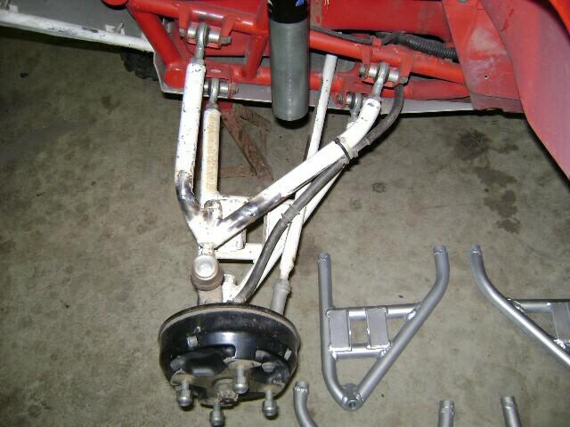

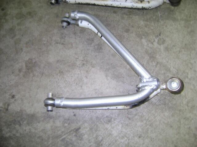

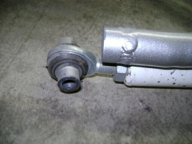

Close up of my old arms and the hiems

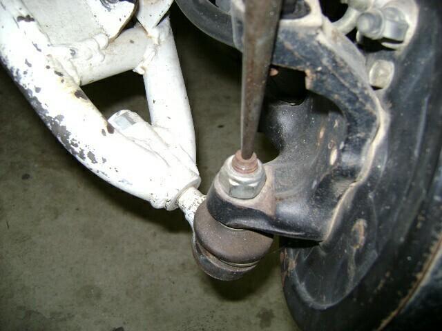

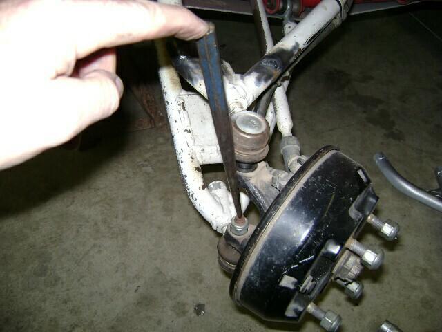

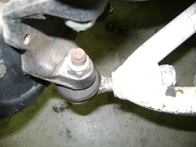

To remove the ball joints I just used a punch and a hammer, when I installed these I applied a coat of never seize to the tapers, one hit with the hammer and they were out.

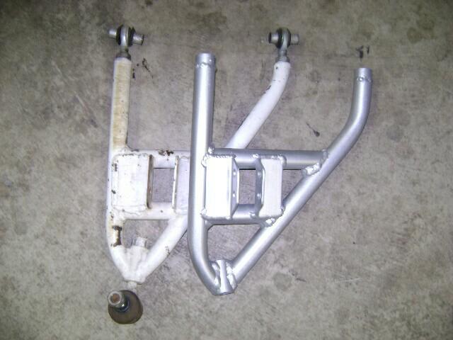

PostPosted: Sun Dec 30, 2007 2:44 pm

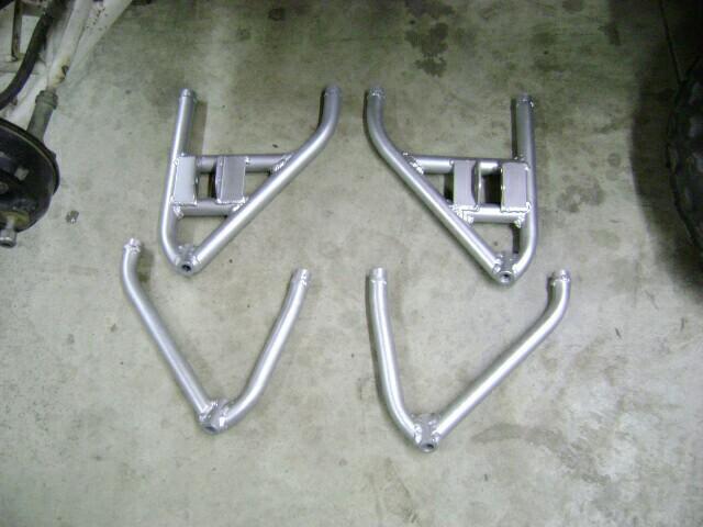

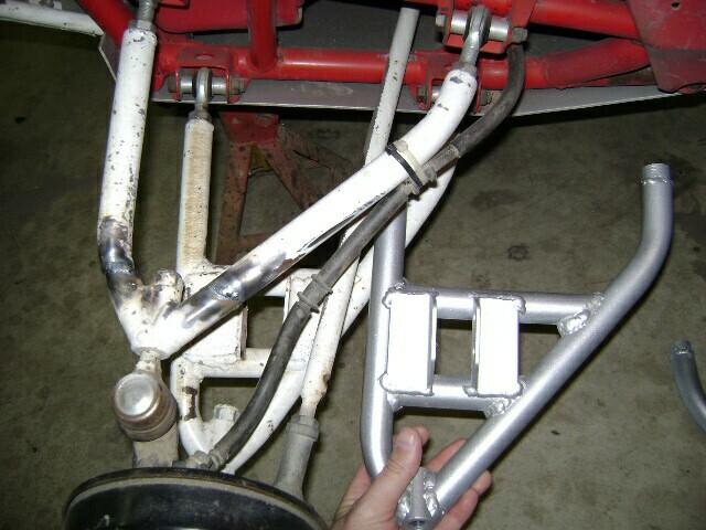

New on top of the old arms, almost identical I hope the ball joint angles are corrected on these, that was the only problem I had with the redrider arms but I am pretty sure he corrected this on the set after mine, my set was pretty much experimental, I was the test dummy, they have served me real well.
File comment: The YODA arms seem to be about 1/2" longer, this means I can keep more thread on the hiems in...

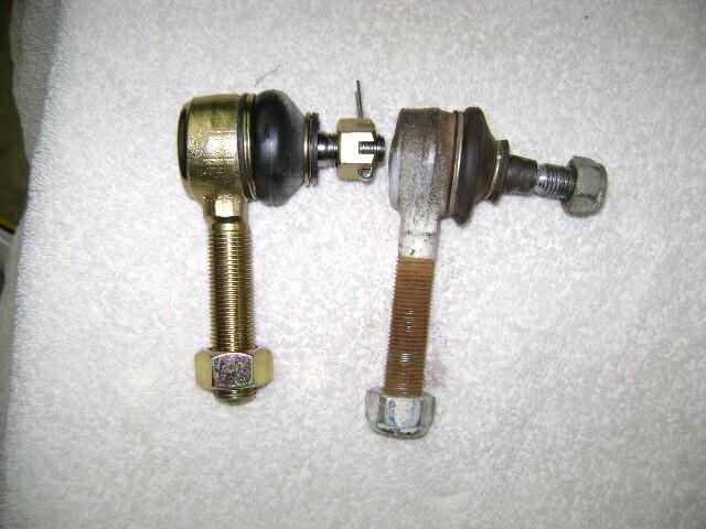

PostPosted: Thu Jan 03, 2008 2:13 pm
Here is the Ricky Stator ball joint next to my old joint, I don't remember where Redrider bought these but they are all still like new even after many years of use.

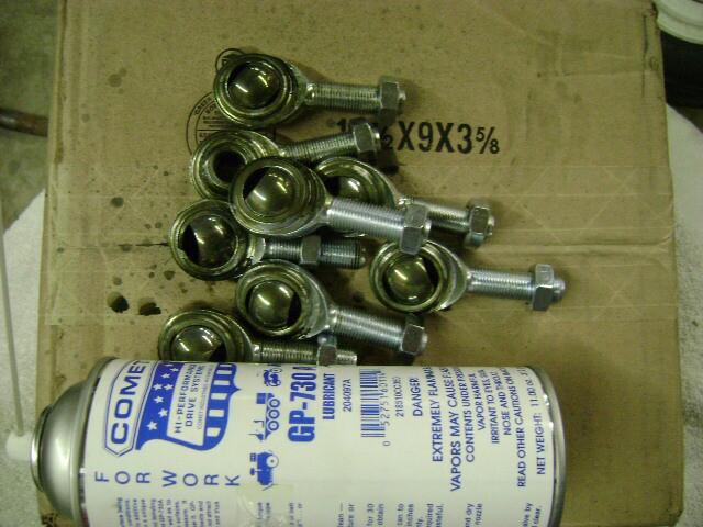

I washed all the rod ends (hiem joints) with carb cleaner to remove the oil they put on them for shipping then once dry I coated them with COMET clutch lube, this is great stuff!, I let them dry then rotated the balls and gave them a second coat.
I did this to my first set http://pilotodyssey.com/LTfront2.htm that with use of the seals and 4 years later the hiems are still like new.
It adds an hour to the install but IMO its well worth the effort, I am in this for the long haul I need the new hiems to last at least 4 years like the last set.

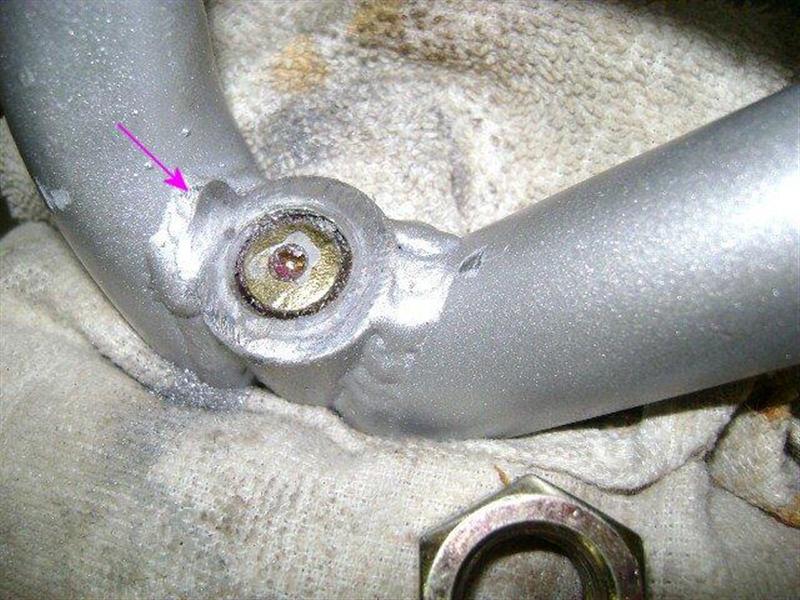

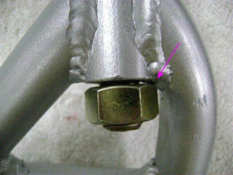

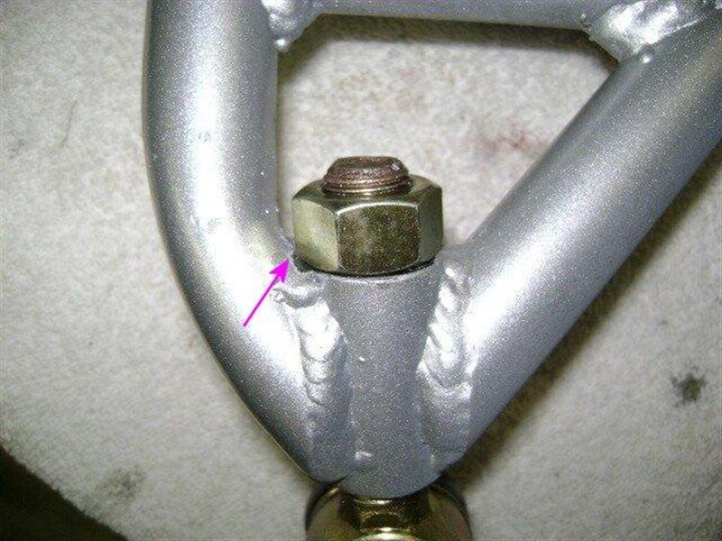

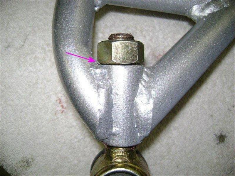

Ran into a little snag on one of the arms, not really a problem but I thought I would document so others know what to look for. their was a little interference with the weld and the lock nut, a hand file made quick work of removing the weld that was hitting on the nut.
PostPosted: Thu Jan 03, 2008 4:06 pm
I used a round file so it created a radius and not a sharp corner that will be a stress riser and crack in the future.

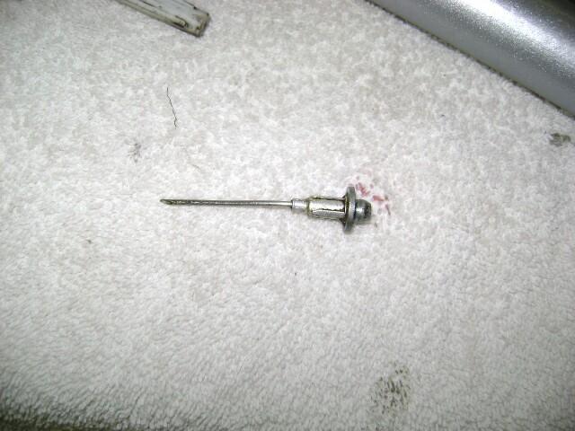

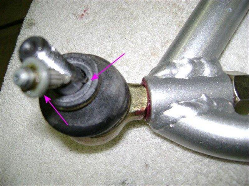

To grease the ball joints I use a needle grease attachment.
PostPosted: Thu Jan 03, 2008 4:11 pm
It has a needle point on the end but that does not mean you poke a hole in the rubber boot, you rather slip it down between the stud and the boot, move it around and grease it up.
Once greased you move the stud around to distribute the grease.
You don't want to over grease, you don't WANT the boot to be under pressure or bulging once you install the ball joint, you need to watch the boot as you tighten the nut, if its building pressure you need to remove the ball joint and squeeze the boot to let some grease out then try again.
You also have to allow for expansion when things heat up.
You want to make sure you purge out any air in the boot, burp it before installing so only grease is left inside.
You must properly adjust the grease in the boot or it will create problems in the future.
