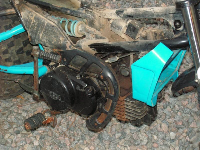

I picked this bike up today as a project for my kids. It won't start so I will have to do some trouble shooting on it.
The Good:
All the plastic is in good shape.
It is complete.
The motor (( Internal Combustion Engine ? )) is not seized up.
It has spark.
The tranny shifts in gear smoothly. Hopefuly it will do this when I getting it running.
The Bad:
Seems to have low compression. I got about 35 PSI on my gauge, but I could not get it to tighten up. I will have to look for a different gauge with shorter threads.
Gas leaks out of the float bowl tube.
Rear tire needs to be replaced.
Front brake lever is broken.
Chain is rusty.
A few bolts for the plastic is missing.
Handle bar is tweaked.
needs new grips.

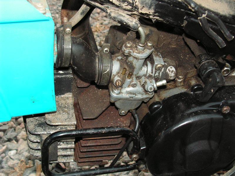

My first thing to do is to verify the comression and get that to spec. Hoser can you work magic on this Engine like you did for my Pilot? If so I will be PMing you about at least getting the cylinder bored and honed to spec. Then I need to take the carb off and find out why the float is sticking. Gas pours out of the tube while I am trying to kick or push start it. Hopefully that won't need replacing.
I got a feeling I will be spending some money to get it reliable again.

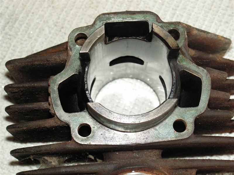

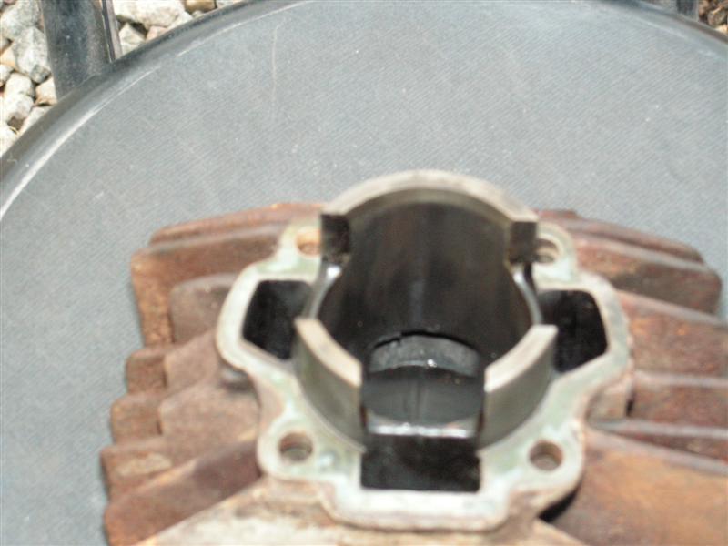

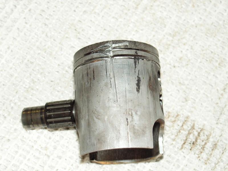

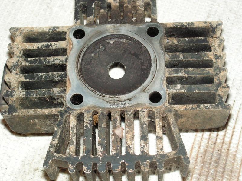

I verified the compression today. The best reading was about 35 psi. I knew then I had issues so I pulled the cyl to find a broken ring. It scratched the cyl some and of course the piston is toast. I am surprised it turned over so easy. Hopefully it can be bored. yamaha has pistons from stock 47mm up to 47.5mm. after that I will have to use the Wiseco's or some other piston I see at rockymount called Pro-X?
Hoser, if you can work on a 47mm bore let me know. I have it boxed up and ready to ship USPS if you can do it. I put the cyl, head, and piston in the box.

Hi, sorry for the delay, the smallest cylinder bore I can hone is 60.35mm I can bore smaller I just don't have a hone small enough to finish the job.
PostPosted: Sun Aug 10, 2008 7:42 pm
Joined: Sun May 06, 2007 9:40 am
Posts: 89
Location: Chesterfield/Dinwiddie Virginia
That's OK. I dropped it off at the local bike shop after getting some positive feedback of the guys work. The cyl was on its second bore of 47.5mm. He thinks he can get it cleaned up at 48mm. The rings gaps were not installed centered on the locating pins. He believes that caused the failure. I hope to get it back next Wednesday or Thursday. All my other parts are on order so I should have it running next weekend if I am lucky.
