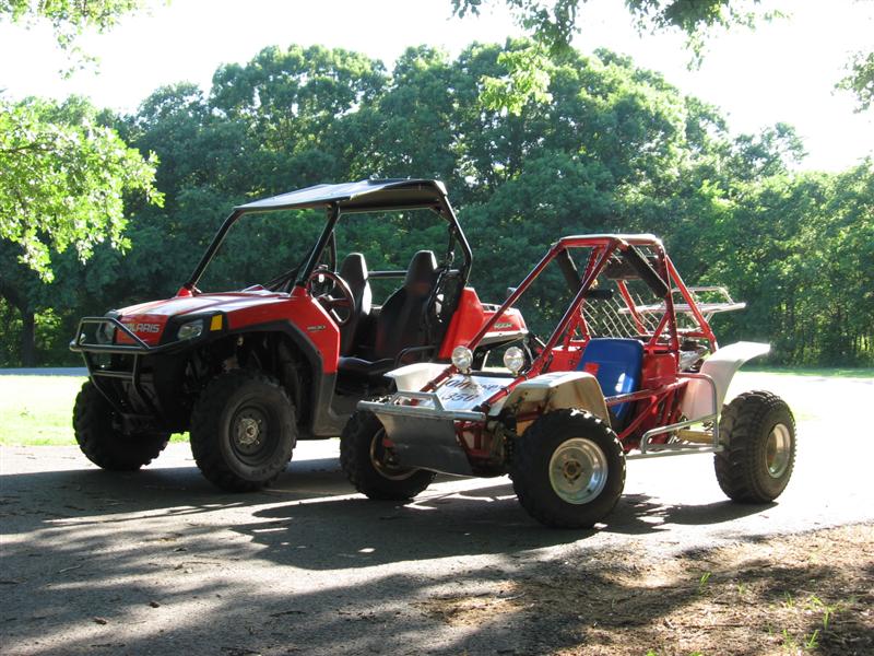

i just need this thing to smoke that damn rzr

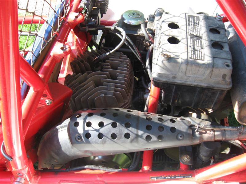

pic

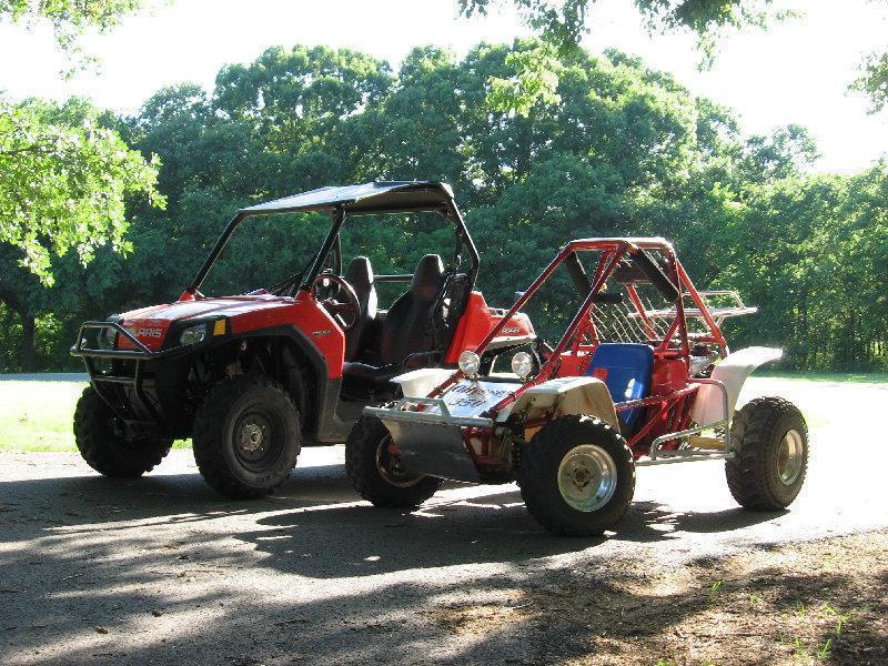

pic

Looks like you have a good drive clutch. I would start with reading up on this forum about a new exhaust pipe,maybe someone here can reccommend a good pipe for top end. I know you will have to rejet your carb after installing the pipe but it will be worth it. I think the pipe is the easiest "bolt on HP" and good bang for your buck. As far as motor (( Internal Combustion Engine ? )) work you will have to wait for the more seasoned FL350 guys to chime in. Also there is a post here about upgrades to the FL350. Maybe Hoser will post the link. If you are short on cash, the previous owner of my FL350 removed some "innards" from the silencer portion of the pipe,now this FL350 is quicker than my stock FL350. I now have more "pick up" from about 15 mph to 40mph on the Ody that had the guts removed from the silencer, and it is not much louder than my stock Ody, again the FL350 guys will have to help you out there too as I am not too sure what he did to the pipe. that's my 2 cents. Have fun and good luck.
PostPosted: Wed May 21, 2008 6:42 am
As we talked in the chat, first order of business is to get a harness, don't even test ride without one!
It looks like you have a 94C clutch, other 94C owners can chime in and give you advice on tuning the clutch.
Do you have a service manual? I would clean the spark arrestor to make sure its not full of carbon and restricting the exhaust.
You said it bog's? Take it for a ride and get the Engine up to full temp then remove the top cover off the air box and take it for a ride again, if it runs better most likely the jetting is too rich.
You know how to jet a 2 cycle Engine? Here is a good guide. http://pilotodyssey.com/BillGivensjetting.htm
It would be nice to know what your current jetting is then we could help you more.
