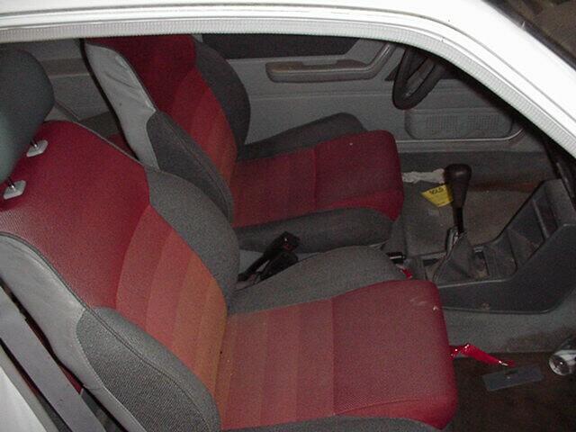

PostPosted: Wed Apr 14, 2004 7:39 pm
Nice "suspension seat" for someone building a buggy.
