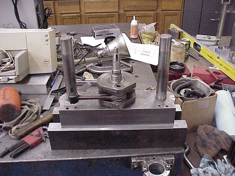

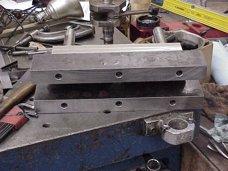

Hoser wanted me to rebuild cranks so I thought I would have a go at it
Started out with a lightly used punching die set I had laying around, going to turn it into a two stroke crankshaft rebuilding tool so I can rebuild 2 stroke crankshafts
Thanks For Looking
SpeedChaser
MVC-279X.JPG [116.53 KiB]
Downloaded 492 times
File comment: after sawing
File comment: after milling flat
File comment: pre assembly
File comment: look at with fl350 crank
MVC-286X.JPG [113.83 KiB]

next
I will be boring holes for removable bushing.
for the main bearing to do different size cranks.

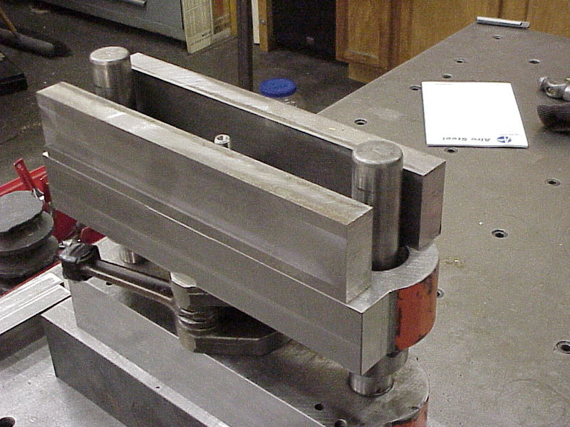

Added risers to add weight to the bottom shoe and add strength
next up risers for top shoe and mount for press
then start on bushing for locating the cranks
File comment: adding some risers

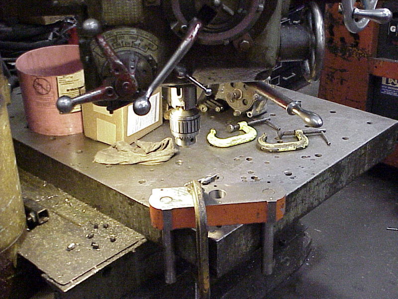

Downloaded 364 times
File comment: using my old radial arm drill press
built just after ww2
File comment: need to clean my bench what a mess

all done on to bushings for the fl350
Thanks For Looking
SpeedChaser
File comment: building top risers and hydraulic mount block

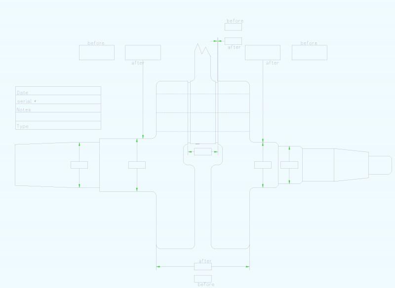

what you think on spec sheet any spot need to be there ?
thanks speed
PostPosted: Thu Apr 29, 2010 10:19 am
thanks speed
Looks like you have it covered, what about the rod?
PostPosted: Thu Apr 29, 2010 10:26 am
Posts: 1040
Location: hole above ground
thanks speed
like what you thinking
dose it need to be specked out ?
PostPosted: Thu Apr 29, 2010 10:38 am
speedchaser wrote:
thanks speed
Yeah from what I have read the new rods should be checked I will find a diagram that will help and post.

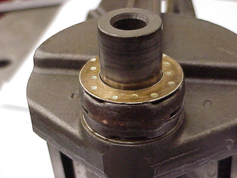

I press this bugger apart
not bad to do I have pressed a lot harder thing
Speed
MVC-347X.JPG [65.12 KiB]

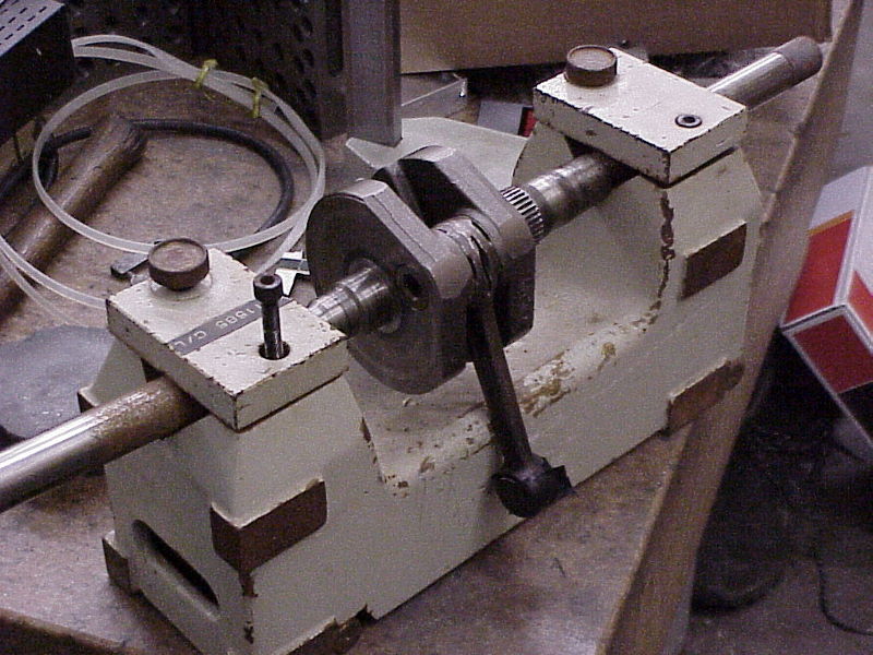

Downloaded 331 times
MVC-352X.JPG [83.48 KiB]
Downloaded 330 times
File comment: each shinny line is a deep grove
