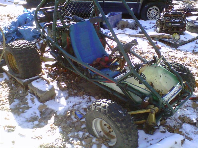

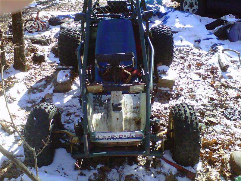

SAVED this odyssey from sinking into the ground. got it off a guy in PA ::: :::

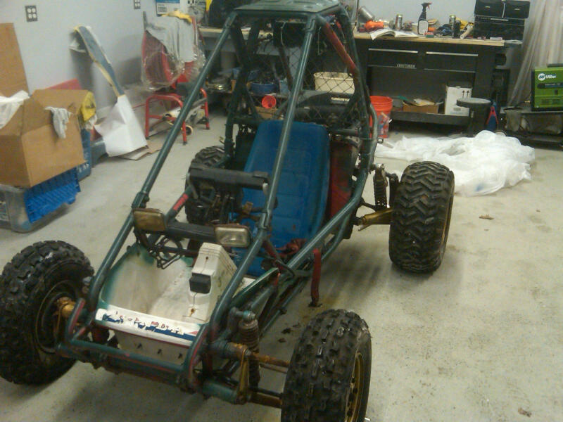

Another picture of the almost dead machine
PostPosted: Sat Jun 19, 2010 12:15 am
Posts: 307

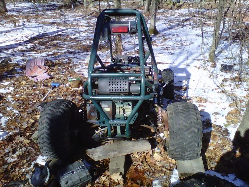

Believe it or not the machine was 90% complete.! Frame was good and straight. Skid plate did not have one dent in it. that 90% was mostly frozen and rusted solid but it was all there. id say 35% useable /rebuildable parts including motor (( Internal Combustion Engine ? ))/trans and most of the metal body parts...THIS thing must have been used a few times and something stupid happened to it and someone left it for dead! gave it away and some idiot rattle canned it !
PostPosted: Sat Jun 19, 2010 12:17 am
Posts: 307
GOT IT INSIDE FINALLY..after 20 years in the woods! was going to part it out but after i looked into this machine more and morei realized this thing was never ridden! frame was near flawless besides the rust and spray paint! nothing was damaged underneath! not damage anywhere except for the bumper!!! .

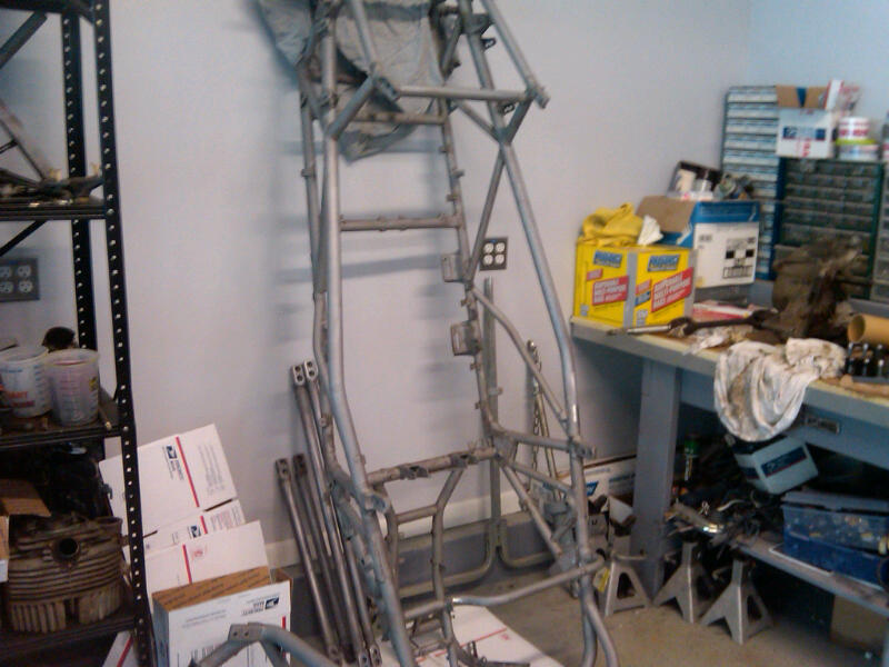

I sandblasted the frame myself and had it powdercoated. went with a custom olor scheme. to many red ones out there!

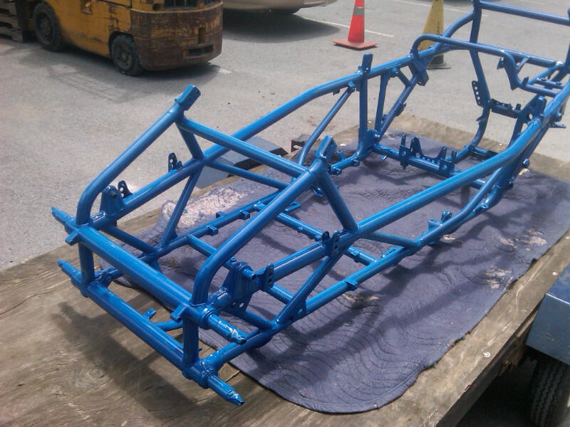

PostPosted: Sat Jun 19, 2010 12:22 am
Posts: 307
i had the frame done in a RAL royal blue with some fine pearl(shattered glass) to give it a little sparkle in the sun! went with a candt red acent for subframes and some small mounts / brackets

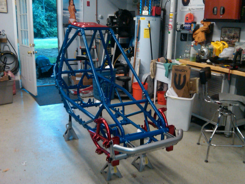

Posts: 307
frame in my shop with some part bolted on. notice the speedchaser front bumper with custom diamond plate bash plate in the front! BTW that bumper is the best looking thing out there for bumpers for these things. i highly recommend contacting him to get a few :)

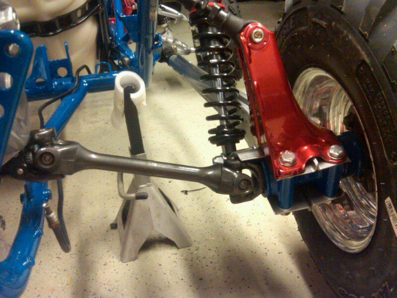

PostPosted: Sat Jun 19, 2010 12:29 am
Posts: 307

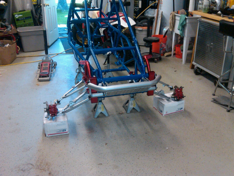

here is the honda trx 450 arm setup on the subframes. uses all the 450 susp in the front. shocks, a arms, spindles, disc brakes etc. makes it really WIDE. not trail friendly anymore...measures 64" wide when wheels are on!

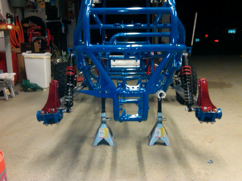

rear susp hung on for a qucik look how its gonna look! went with the works shocks (non resiviours) i was being cheap!

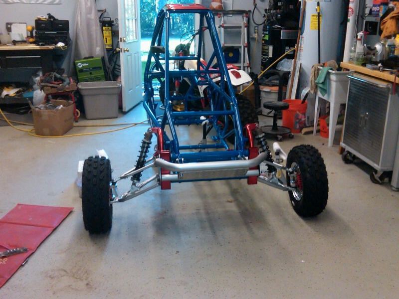

Posts: 307
rear end shot....waiting on a tranny gasket to put in my newly rebuild trans. ill post pics as i work on it. let me know what you guys think.

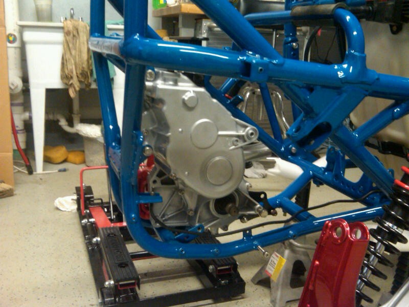

rebuilt transmission installed. i blasted and painted the cases apart. all new seals and gasket. came out ok, blasted and painted axles gunmetal to match the hubs and PILOT steering wheel chassis. pressed in new u joints and came out flawless. will always look good since they wont get rusty like oem uncoated axles
