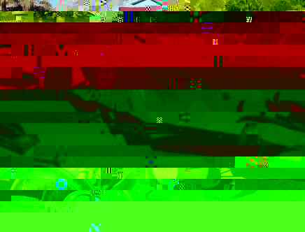

Hey guys and gals. I found out about this forum just tonight. I'm living in Vegas, Bought my first pilot a little over a year ago. and since owning it i have blown it up or "popped" the motor (( Internal Combustion Engine ? )) 3 times. Not something I'm proud of but it is what it is and that's how i came up with my username. So here I am and I'm seeking out ideas such as jetting, the ins and outs of the 400 and helpful tips and hints on what to do. I have already been in touch with Slick Rick and he is the one that told me about the site. I have several toys a couple of my newest favorites are the 07 Aprilia SXV 550 supermoto and My 2000 KTM 380. I bought the pilot for my wife and since we bought it i bet Its been blown up longer than its been running. Pretty sad I know. Here is a pic of my two favorite girls in my life. Hope to get to know most of you in the Pilot days ahead.
