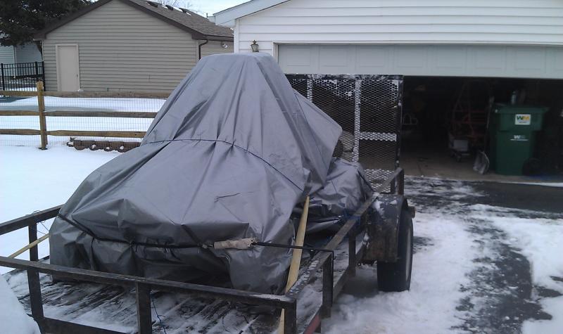

Going to summarize my build log and get it caught up to today...

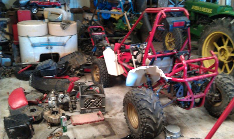

File comment: The buggy as it sat at the Seller's barn

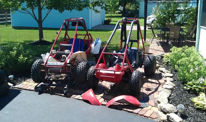

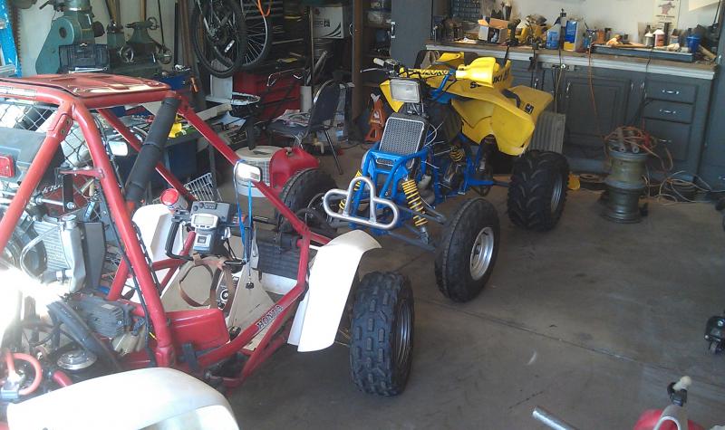

File comment: Both buggies I paid $1300 for...few weeks later sold the FL250 for $850, so the FL350 cosr me $450.

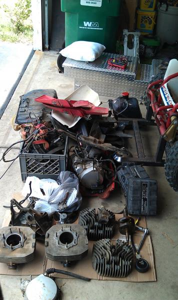

File comment: Pile of spares that came with the 350...

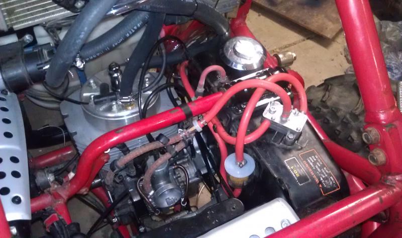

6. Water-cooled head (After$hock) with YFZ450 radiator/fan, Mercedes pump, and Honda overflow tank; new electronics/wiring to match; custom mounts for everything.
7. New Mikuni fuel pump

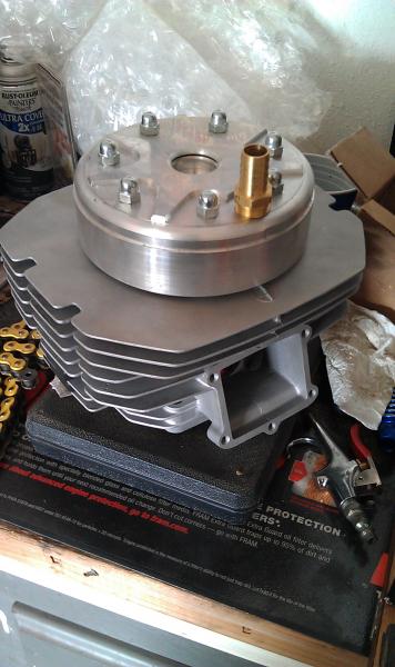

File comment: Water cool head on a fresh bead blasted and bored/honed jug

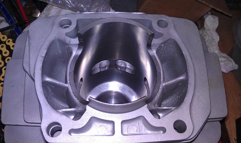

File comment: 80mm bore...thing looks like new! =)

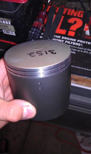

File comment: Ceramic domed, teflon skirted, and drill Wiseco piston

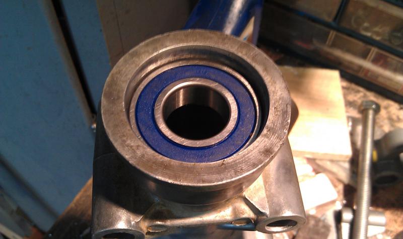

File comment: New rear carrier bearings, All Ballz

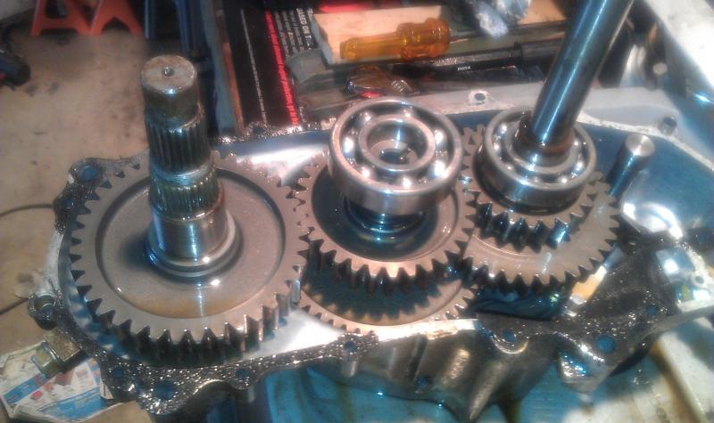

File comment: Gearbox disassembled, cleaned, and new needle bearings and seals installed.

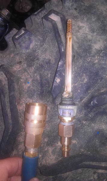

File comment: My version of the crank vent mod, with air fittings and hose

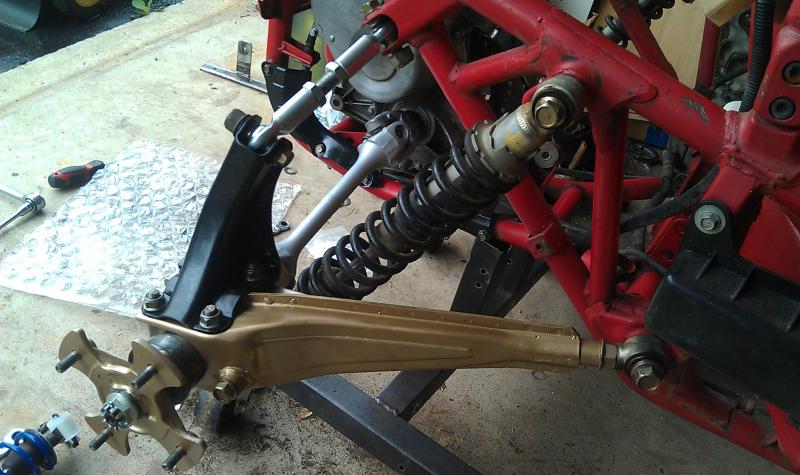

File comment: Freshly blasted and painted rear suspension, with aftermarket-made upper links

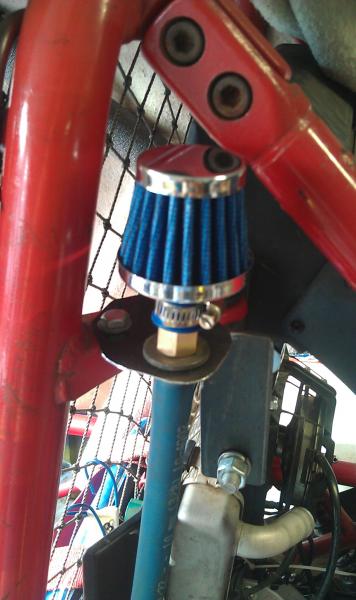

File comment: Other end of the crank vent hose...$7 CCV filter from AutoZone

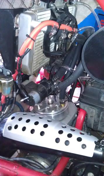

File comment: Relays for fan and pump, plus fuse box for water-cooling system
File comment: Rad plumbed...

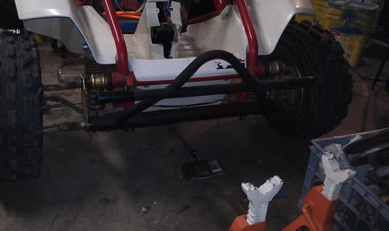

File comment: And the new bumper...

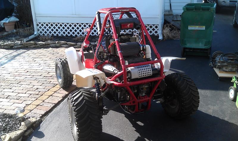

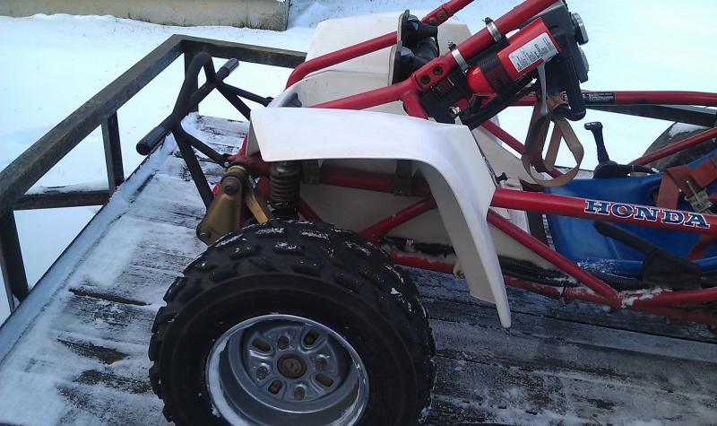

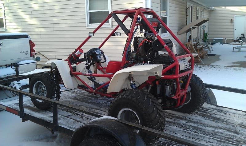

Got most of her together now. Got my #2 set of fenders on in these pics (the trail set). Few more things to bolt on yet. My poor garage...

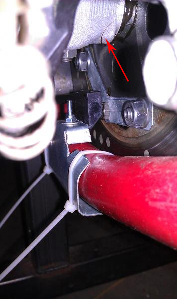

I noticed one thing in one of the photos though...
Is this a crack in the axle hub? or just a piece of debris?
PostPosted: Sat Feb 04, 2012 3:19 am
looks like grease to me. You can see it oozing out closer to the brake disk.
PostPosted: Sat Feb 04, 2012 10:48 am
Winner, winner, chicken dinner! lol It's grease.

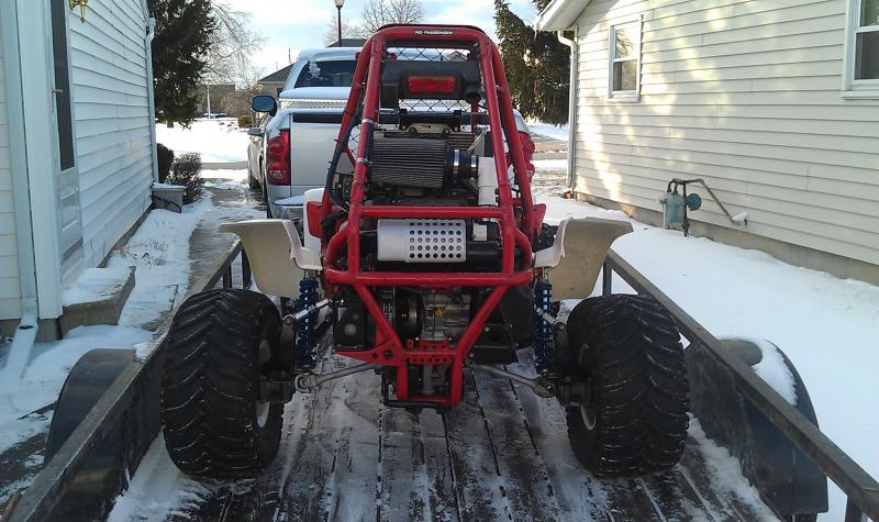

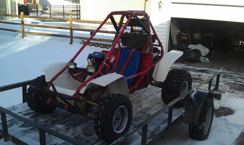

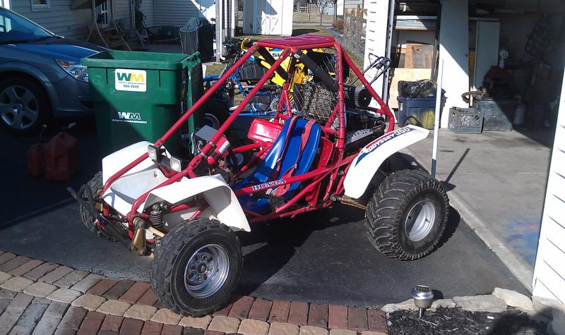

Got her all together and then did some spring cleaning. Took it for a rip around the yard, too. Runs awesome! It gets trailered to my dads farm Tuesday, and I'll bring buggy #2 home for the next build. Love this rig!!

Went for a ten minute rip in the 14'F air, and holy Jesus what a fun machine!! Loaded her up and relocating it to the platground (250acre farm)..
PS....the little manilla envelope ziptied to the steering column has my extra jets in it. Planning to go one step bigger to 145 since she seems to have more top end to give up.
File comment: Hog-tied and headed to the farm.
