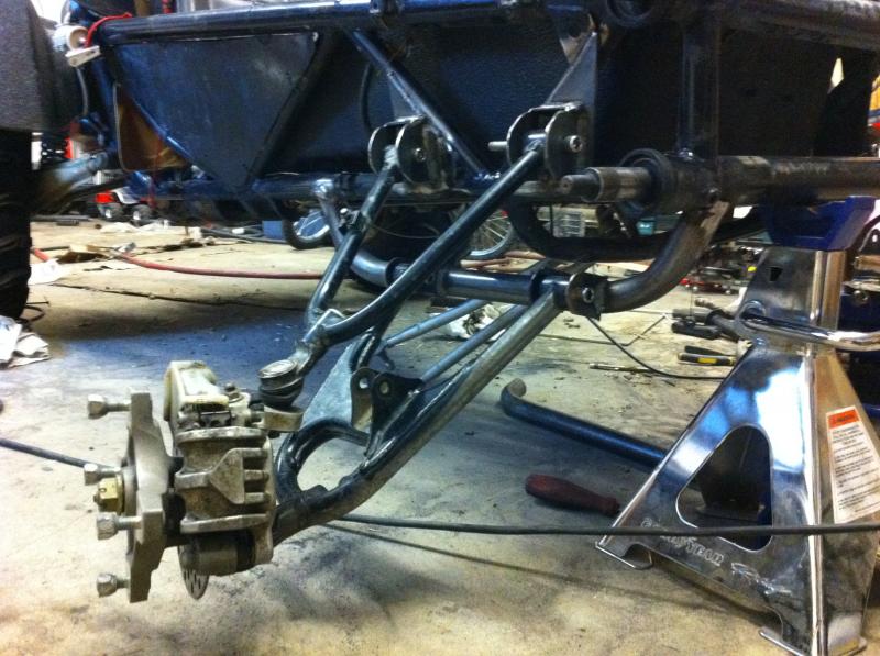

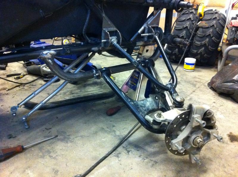

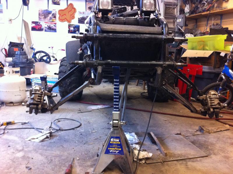

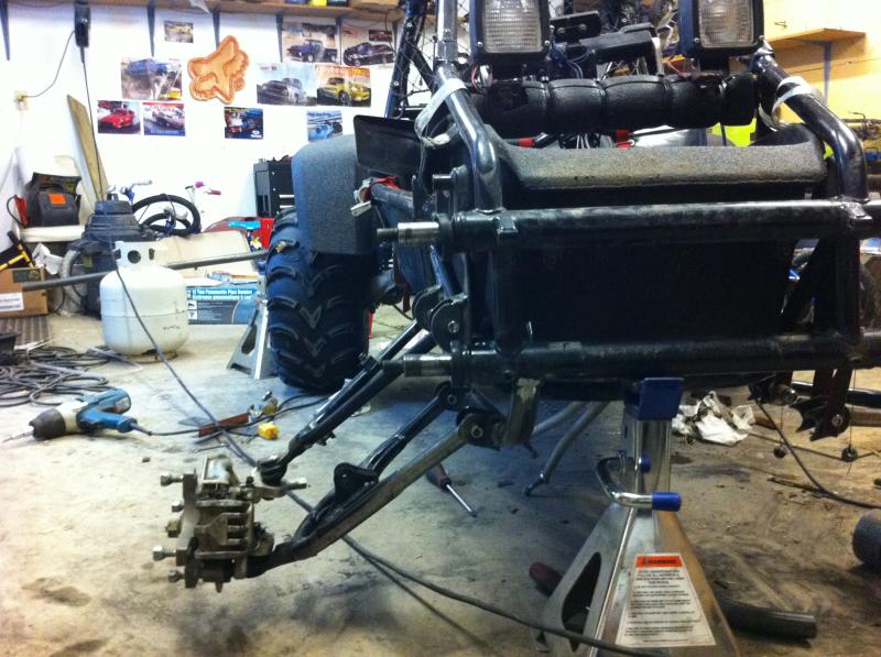

i am about to start my trx450r a arm conversion. i am not sure what i am going to use for shocks yet. i might just build it so i can use my current works shocks. and haven't even looked at steering yet. here r some mock up pics just using zip ties to get the idea

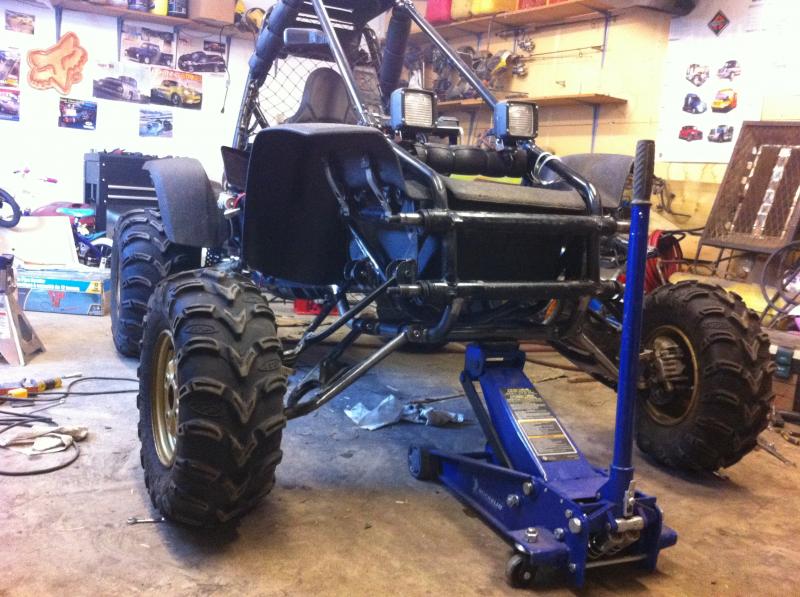

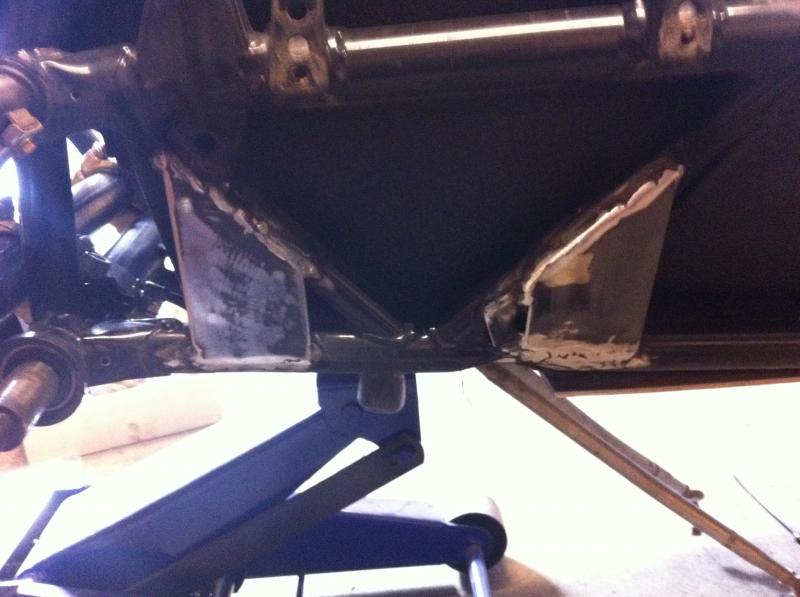

well i got some more done on the a arms swap today..i got the upper arms mounted and welded up, and got the hoops for the bottoms bent, but might trash them and make new ones, they are longer than i thought they would be. i bought all the steel for $6 bucks and they had more so i might go back to the scrap yard and get some more and redo the hoops for the lower arms.

never had a chance to work on it today but here are some pics of the right hand side

PostPosted: Mon Feb 27, 2012 5:01 pm
well i just have the steering, shocks and brake to finish now..and need some rims to fit the 450r front end..

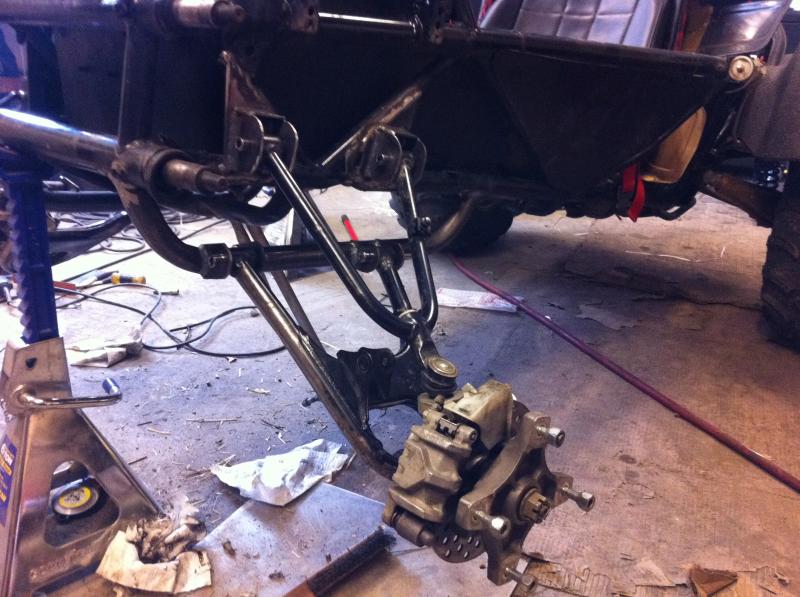

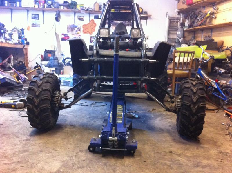

here is what i have finished so far
the tires are set in place, the bolt pattern is way off. i think it looks pretty cool myself
