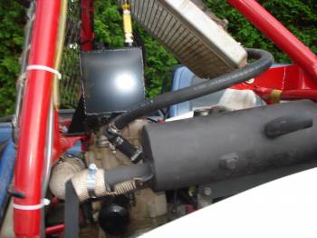

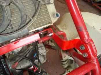

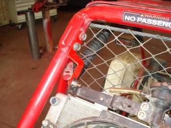

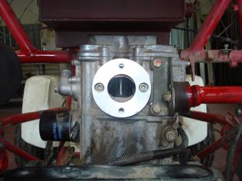

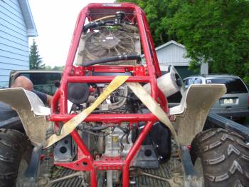

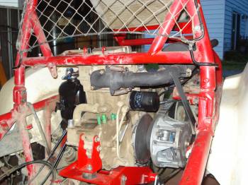

HI, thought I would post some pics of a conversion I completed

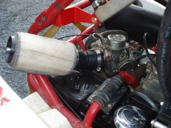

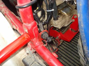

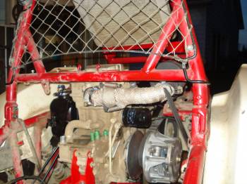

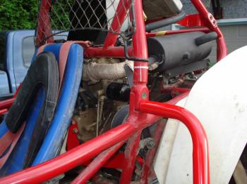

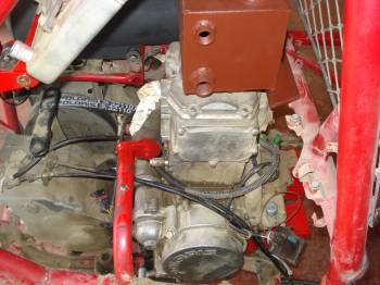

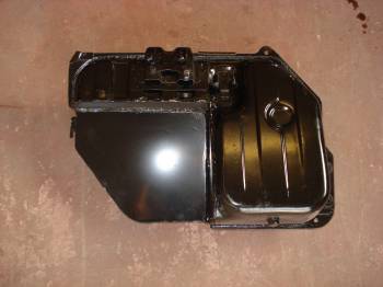

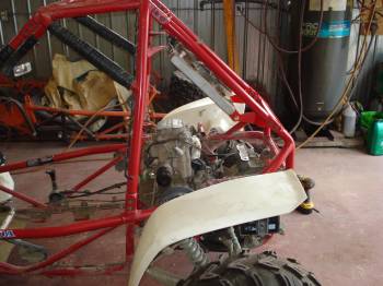

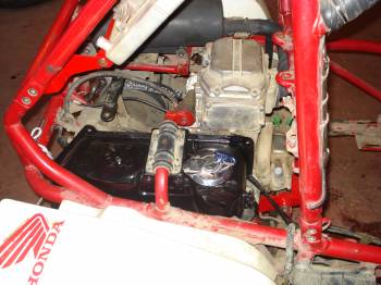

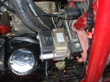

The yard isn't very big at my shop so we couldn't fully try it out, im going to the customers farm next week to see how things are going and get some video.
This conversion is fairly simple, no frame mods just had to cut off a couple tabs and part of the cross bar that holds the airbox and fuel tank.
This is what I did
fab Engine mount
fab rad brackets - I used the quad rad
fab remote oil tank
modified quad exhaust to fit
modified fl 350 fuel tank
custom billet intake spacer
Engine came out of a 2008 polaris sportsman 500ho
the Engine is by far the biggest cost in this conversion

I like what you did here. Very nice work. Can you use the stock belt guard or do you make one? My only worry would be the clutch throwing something through the oil filter. I like this conversion.
PostPosted: Mon Aug 05, 2013 1:14 am
Looks like the drive clutch sits a bit higher on the polaris to clear the stock belt gaurd but i bet you coukd make some stand-offs to make it work
Also does the seat go all the way back still?
PostPosted: Mon Aug 05, 2013 1:21 am

Thanks for the responses, the Engine does sit a little higher than the original and I didn't try and use the stock guard, probably should have made a guard.
The seat now sits in the middle hole
I did this conversion including Engine and rad for 2000$, which is very reasonable, i had the Engine for a while but hadent had the time to make a mount so when this guy asked me to convert his fl350 to a rotax 470 for his 7 year son i offered him the Engine and it gave me the chance to make the mount
Just so everybody knows the stock polaris drive clutch was a comet 102c which used a 1 inch belt
