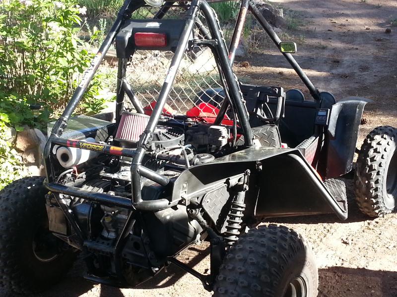

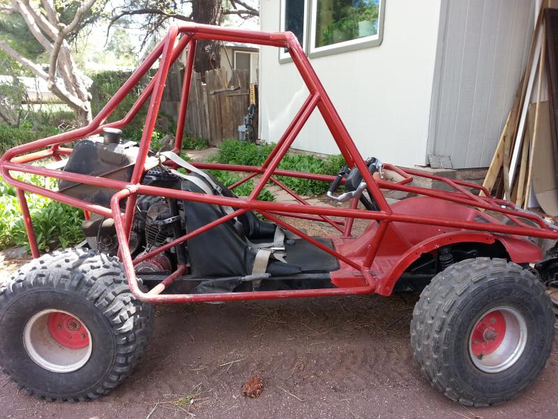

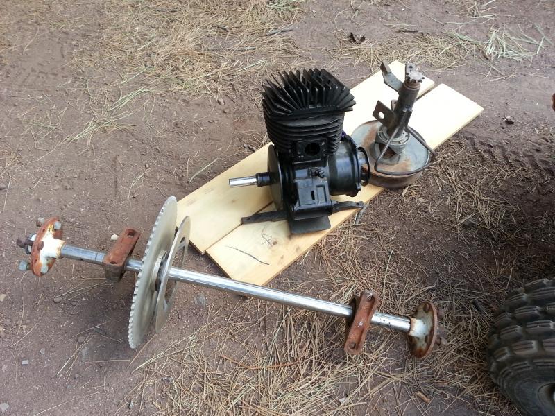

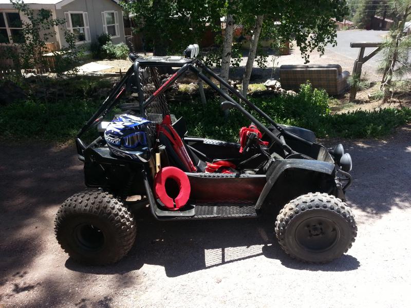

I am new to the site but a longtime owner of various oddys and pilots. Currently sitting on my Fl250, New cage, and Engine. And my SuperStock fl350r. Fresh build full race motor (( Internal Combustion Engine ? )). Tare down restoration with new Brakes, lines, stock suspension(brand new but ordered full works with resi set up so will be selling the new stockers) every nut bolt nuckle etc that I could find new. 40mm carb w v-force3 reeds and box mount. Wiseco internals, Power jet fan until I get my watercooled head back. Etc..etc...etc.. here are some photos. Cheers and thank you for having such a great site dedicated to these amazing machines.

Interisting side bars and rear fenders. Any closer pics? Also, you might not want to run it too long without the side air scoops being that it is still an air cooled Engine. Once you get the water cooling installed, you should be fine, but be careful.
PostPosted: Mon Jun 10, 2013 5:44 pm
Joined: Sun Jun 09, 2013 4:29 pm
Posts: 10
Yeah I will get some photos a little closer. All the cooling scoops have been formed out of titanium alloy diamond plate and sprayed with rhino lining. the fenders are formed kut of sheet titanium alloy and hard riveted to the nerf bars. Expanded titanium alloy was also riveted and used as a step. I will get better pictures so you can see the work. With it being all black everything blends together. I am also running my projet fan above the head for cooling until my head and jug are finished.

that's a Git-er-Dune machine for sure. Do you run a prefilter, Outerwears, Moose and other brands are available, keeps the fine particles getting by that reuseable filter. Just a suggestion. Those air scoops arent breaking or bending with the diamond plating, cool!
PostPosted: Wed Aug 28, 2013 11:31 am
Updates? Also, I highly suggest either wrapping that "K&N" in some oiled up UNI foam, or just getting a UNI filter. Those cotton gauze type filters lets too much garbage through
