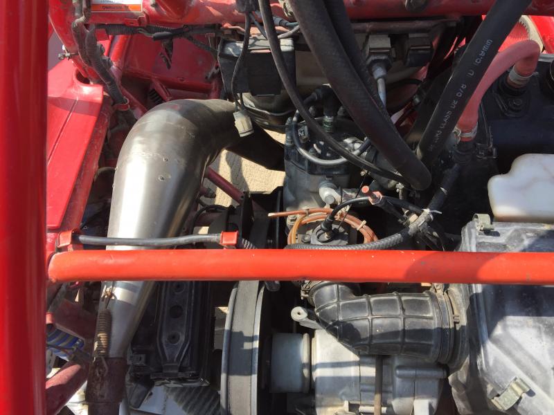

Are there any engravings on the Engine or head? Billet head?
Is there a spacer between the bottom end and cylinder? Next to the PowerBlock clutch, is there anything clearanced on the cylinder, indicating the PB clutch was running possibly too close to the cylinder? (This is possibly a CR500 jug indication)
Two Engine builders are, ATV Racing and CW. CW Racing Engines still exists
ATV Racing used to do a lot of CR500 jug conversions. Their conversions I think needed a spacer between the bottom end and jug. Also the jug mounts needed to be re-located in order to fit. To me this would be a frankenstein setup. They worked and made great power but IMO the setup was not the most reliable long term - the mounting of the jug to the base became the problem. On the plus, the CR500 jug will always out-perform the FL400 jug using an actual CR500 cylinder.
CW racing engines IMO does better practice of boring, re-sleaving, rebuilding. CW has 440 pistons for the stock jug/sleave, and CR500 options as well. For CR500 they have a custom LA Sleeve bored out and pressed into the FL400 jug which gets you started at 89mm bore, and I think the cylinder also gets a spacer. IMO CW has better options than the ATV Racing option, but the difference is the CR500 actual jug has much larger transfer ports to start.

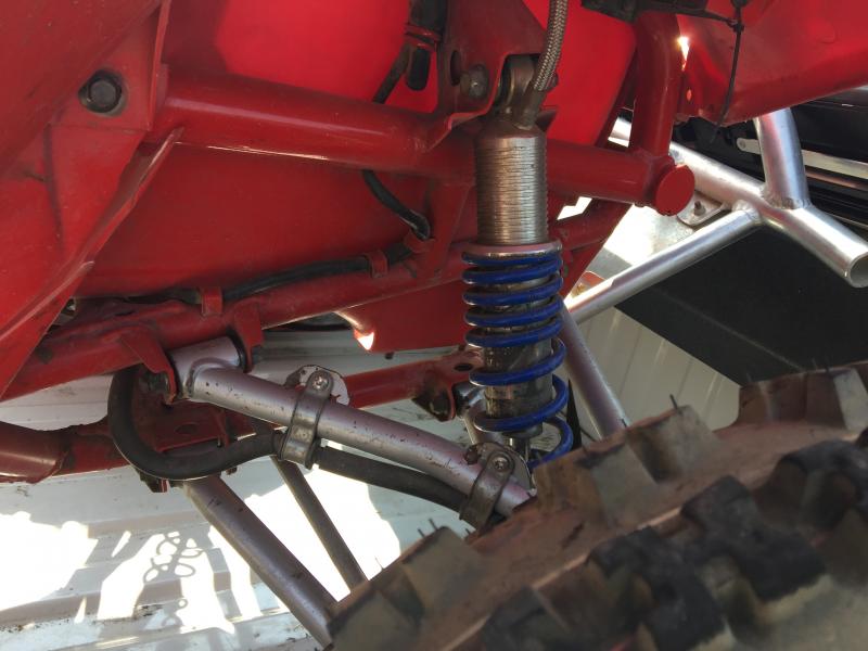

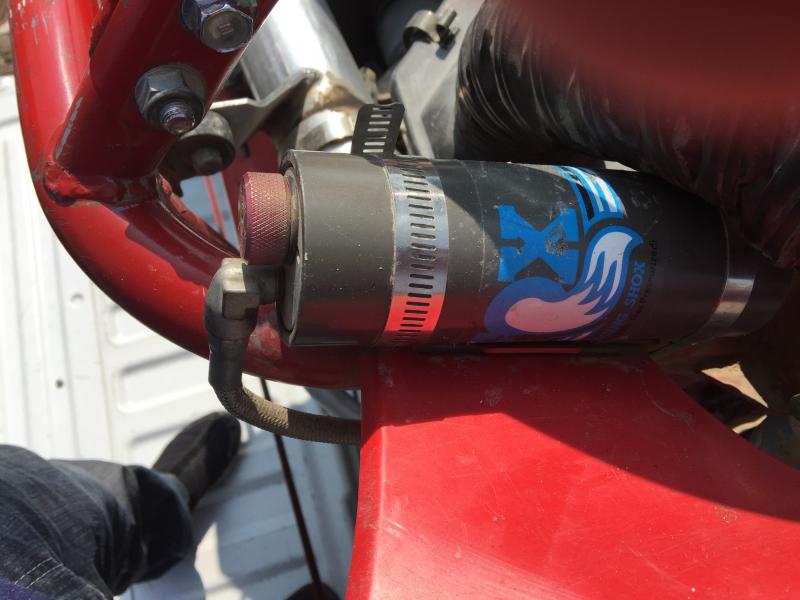

What kind of Fox shocks are on the front?? Whats the spring<s> rate? Single or dual? AFAIK Fox didn't really make anything much suitable for the FL400 in stock lift form but I could be wrong. Fox shocks are tunable so maybe you can make it handle better.
What type of race terrain was this machine set up for? Desert, flat track, mx, trail?
Doing a little bit of cleaning etc reveals it's a CW Racing Engines Engine, and I talked to Chris today. Hell of a guy. He and I chewed a lot of the same dirt racing back in the day and he is relatively close to me. I'm trying to research the original owner's name to find out what was done to it instead of guessing. I don't think its a CR500 jug, I think it's a custom over bore.
There is in fact what looks to be a 1mm spacer.
The PB clutch looks fine. Probably just needs some adjustment.
The fox shocks are single. I have no idea on spring rate. As for terrain, I have no idea, but I have a feeling it was set for flat track because it is like riding around on an anchor. It just doesn't absorb anything it feels like. The ground clearance is also something I want to see if I can help along a bit. Thus my question about a long travel setup.

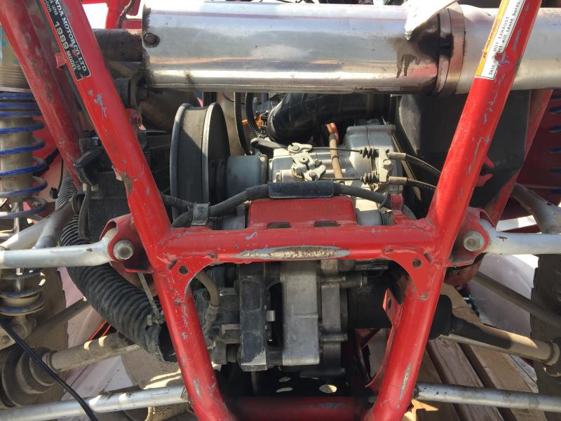

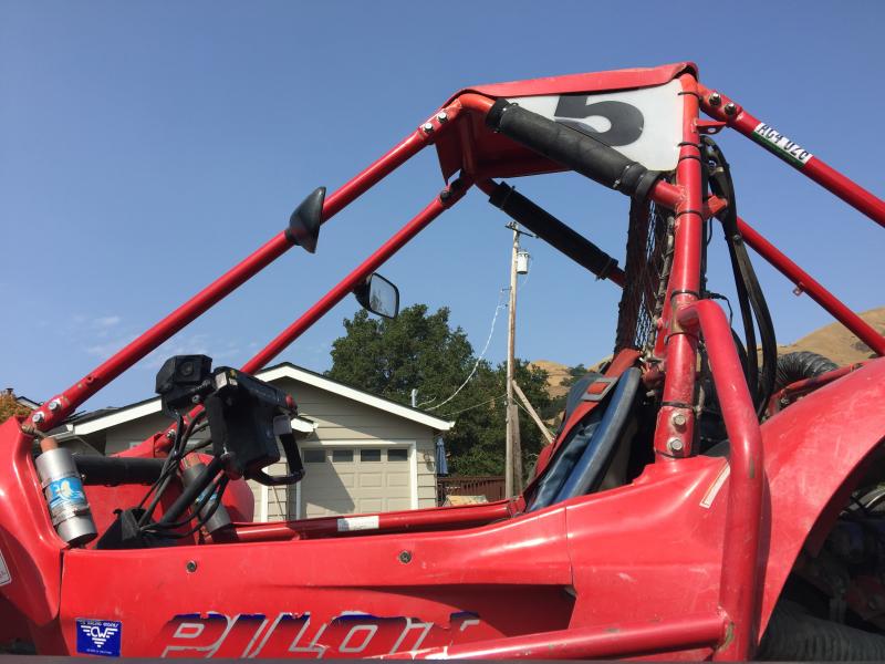

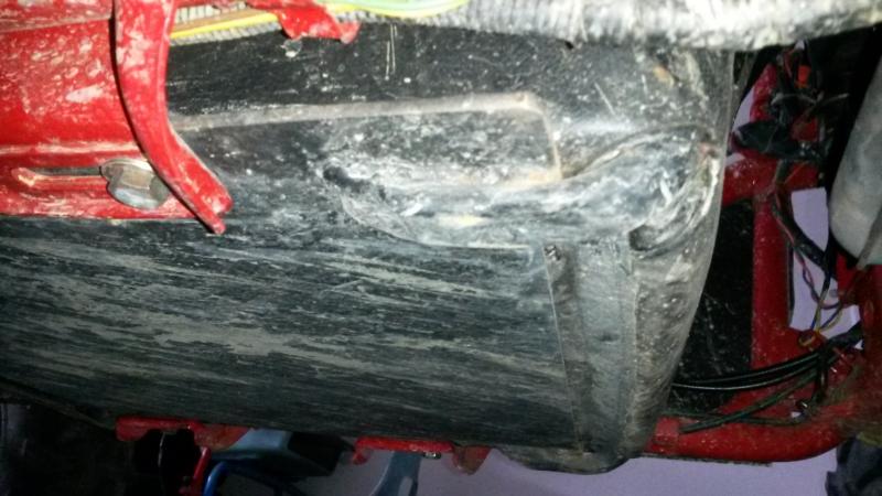

Here are a few of pictures. Used but not used up.

Nice machine.
Your drive belt is shot.
CO

canadian oddy wrote:
Nice machine.
CO
I don't disagree, but how can you tell?
PostPosted: Thu Sep 17, 2020 9:29 pm
Nice machine.
CO
I did this post recently: viewtopic.php?f=1&t=20437
CO

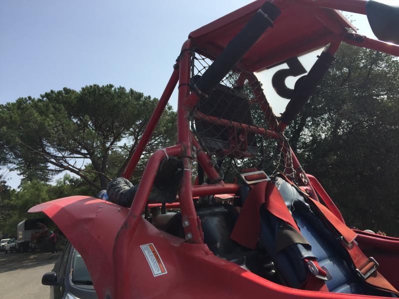

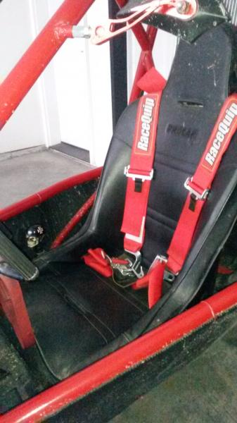

What seat did you get that fit? I am wondering if I can shave it to make the height correct and not have the steering wheel in my lap but still take advantage of more comfort?
Any recommendations on a harness? What did you replace yours with?
As for the ground clearance seems like I'll be fabricating something or simply trying to soften things up a bit and then just hope for the best.

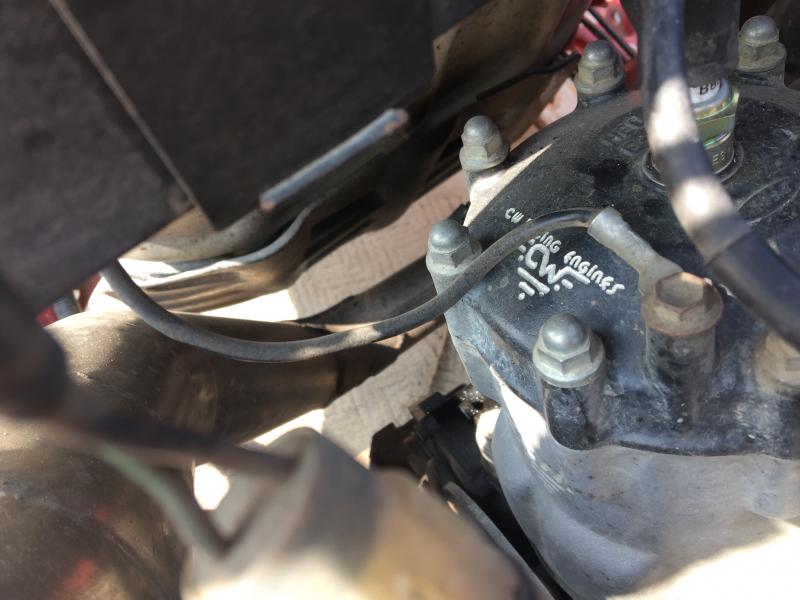

Looks like you have clickers on the Fox shocks. Those are progressive springs similar to dual rate.
Set your SAG (Front and Rear) to about 20% with driver weight (Balast) 70/30% - Seat/footwell.
(Front and Rear) If its riding rough and not reacting much to bumps, decrease compression
(Front and Rear) If after several fast bumps it bottoms out, decrease rebound in the front.
(Rear) If the machine seems to buck when releasing off of jumps/rotating front-downward, increase rear rebound hardness.
So, CW has some 83 & 84mm pistons for their 440cc kit, but my understanding is neither of those require a spacer as they are just over-cast sizes from Wiseco.... A CR500 piston (AKA FL500 sleave/conversion) needs a spacer because the CR500 piston is slightly taller than the FL400/440 pistons - hence the spacer.
If it were me, I'd first Measure squish. Then drain the coolant and pull the head off. Measure bore diameter. Measure piston/wall clearance. Prepare to buy a new head gasket (Which will likely need to be bored to the current 84~90mm size.

Seat: It's a procar seat. Not sure what model #. You can get them at Summit racing. The bad part is that I had to butcher it to get it to fit. Pics attached below. You can also see the height difference.
Harness: I have 3" race belts on all my machines. A G Force harness in my machine. A pro series in my brothers and a RaceQuip belt in the death machine. In my opinion the belts that bugeye59 has on his machine in Australia is the way to go. They are a Teamtech wide racing belt. Far superior to the junk I got now but they're expensive. If I do ever replace my belts I would consider the Teamtech. There is a picture of it on the last page of the thread I posted of my crash that broke my back.
I also noticed something on the pic you posted. On the pic that shows you standing on the tailgate of your truck next to the machine it's obvious you are a small guy like me. The Pilot frame is about your balls height and your legs are thin. Therefore you are about 5'5" tall and about 130 lbs. Unless you have real broad shoulders you will find the belts trying to slip off your shoulder. You need a way (strap) to hold the harness together at your chest bone or get those belts that bugeye59 has.
CO
